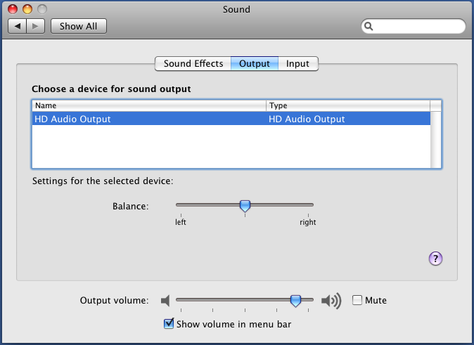

I got sound working! I'm sure its just basic sound, no bells and whistles, but that's all I need it for. I was able to hear sounds in the System Preferences Sound section, as well as go out to the Quicktime movie trailers and watch them. Nothing is listed in the System Profiler for audio, but it does work. All I had to do was add the PCI ID to the AppleAzalia kext in the Intel ICH6 section. Basically it was the same thing I had to do to enable LAN1/Marvell 88e8056 in the AppleYukon2 kext.
Now I just need a working 9600GT driver (unlikely) or go buy an 8800GT (more likely).
Both of these kexts are inside another kext, so I'll just attach the whole ball of wax. You should be able to just replace the existing kexts in /System/Library/Extensions.

Odd. All I did was add the PCI ID of the Intel ICH10 audio chip (0x3a3e8086) to the existing Intel onboard audio driver and it worked fine. I can see the HD Audio device in the output section of the Sound control panel. And in the sound effects section, the effects are black (instead of grayed out) and I can click on them and hear them.

Realtek ALC1200 (80863a3e) running on P5Q-PRO, 2 channels Out, Micro In, Audio In, editing ALCInject and AppleHDA
/System/Library/Extensions/ALCInject.Kext/Contents/Info.plist
/System/Library/Extensions/AppleHDA.kext/Contents/PlugIns/AppleHDAController.kext/Contents/Info.plist

BINGO :thumbsup_anim:
Sloppy work on my part. :whistle: Thanks to Nick3092 and gedebukk I started all over again. I went back, deleted some kext, cleaned things up, moved files around, verified permissions, rebooted with -f and vioila.
Audio ID'd in System Profiler as:
Device ID: 0x10438311
Audio ID: 12
