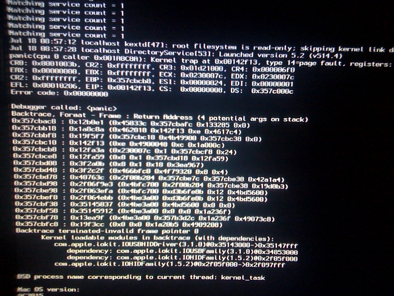

Wingman Posted July 18, 2008 Share Posted July 18, 2008 hey, I'm trying to install on a P5Q3 Deluxe, took me some time to even get the dvd to boot the installer without panicking...had to disable nearly all of the CPU functions in BIOS. But it is not possible to boot the system from HD afterwards. I get the Bootloader and no matter what switches I put there It gets stuck before loading any ACPI or AHCI drivers... Can someone tell me which install options (packages) to select for this mobo or for similar ones? thx Link to comment https://www.insanelymac.com/forum/topic/112033-osx86-on-intel-p45-chipset/page/4/#findComment-823821 Share on other sites More sharing options...

DocShadow Posted July 18, 2008 Share Posted July 18, 2008 Check out my post #63 on my P5Q Deluxe install for the DVD settings I used. My first install was on a MBR formatted HDD but this week I changed it over to GUID. The GUID install was very smooth. Which video card are you using? Doc Link to comment https://www.insanelymac.com/forum/topic/112033-osx86-on-intel-p45-chipset/page/4/#findComment-824166 Share on other sites More sharing options...
BiTRiP Posted July 18, 2008 Author Share Posted July 18, 2008 hey, I'm trying to install on a P5Q3 Deluxe, took me some time to even get the dvd to boot the installer without panicking...had to disable nearly all of the CPU functions in BIOS. But it is not possible to boot the system from HD afterwards. I get the Bootloader and no matter what switches I put there It gets stuck before loading any ACPI or AHCI drivers... Can someone tell me which install options (packages) to select for this mobo or for similar ones? thx But did you flash your bios with a modded version? It's needed to get it boot. Go get the mod at Kabyl's site. BiTRiP Link to comment https://www.insanelymac.com/forum/topic/112033-osx86-on-intel-p45-chipset/page/4/#findComment-824177 Share on other sites More sharing options...

Nick3092 Posted July 18, 2008 Share Posted July 18, 2008 Check out my post #63 on my P5Q Deluxe install for the DVD settings I used. My first install was on a MBR formatted HDD but this week I changed it over to GUID. The GUID install was very smooth. Which video card are you using? Doc If your referring to the SATA settings, I've already tried AHCI with no luck. AHCI and Compatible both allow me to get further than Enhanced, but I still get a panic at the same spot. I have an Asus GeForce 9600GT, and I have an E8400 running at the stock 3.0GHz. I'm using an MBR formatted disk. I really also don't feel like repartitioning my drives. But I don't know that is an issue at this point, since I'm not even getting into any installer areas. As far as I can tell, the kernel is panicing before I get to that point. But I could be wrong. I'm pretty new to this. But I've been pouring over the fourms the last 2 days trying to find some solutions. Link to comment https://www.insanelymac.com/forum/topic/112033-osx86-on-intel-p45-chipset/page/4/#findComment-824239 Share on other sites More sharing options...

Nick3092 Posted July 18, 2008 Share Posted July 18, 2008 There are three selections in BIOS ... IDE, RAID and AHCI. I could only get it to work on AHCI .. not IDE. I have CIE Support - disabled MAX CPUID - disabled Intel Virt. Tech - disabled CPU TM Fcn - disabled Exec Disable bit - enabled You did replace the OEM 0803 BIOS with the one from Kabyl's site ... correct? Won't work without it. MBR is fine .... I originally used MBR without a problem. Except for the video card we seem to have the same setup (my E8400 is overclocked to 3.7). Stick in the DVD and boot from it. When it prompts press F8 and enter -v to see where it hangs up. Doc I did flash my BIOS with Kabyl's a few days ago. I also have to use -f when bootig the DVD, or else it panics on what appears to be an ACPI error almost right away. With -f, it boots further, getting to the point where it can find my drive. I tried all those settings, still no luck. If I'm reading the panic correctly, it has something to do with USB/HID. I tried turning hi-speed off in the bios, with no luck. I have a G15 keyboard with a bunch of extra bells and whistles, so I tried replacing it with a regular USB keyboard, but I still got the same error. I took a snapshot of it with my phone, if anyone can maybe see something else in there that I'm missing. Link to comment https://www.insanelymac.com/forum/topic/112033-osx86-on-intel-p45-chipset/page/4/#findComment-824559 Share on other sites More sharing options...

DocShadow Posted July 19, 2008 Share Posted July 19, 2008 I did flash my BIOS with Kabyl's a few days ago. I also have to use -f when bootig the DVD, or else it panics on what appears to be an ACPI error almost right away. With -f, it boots further, getting to the point where it can find my drive. I tried all those settings, still no luck. If I'm reading the panic correctly, it has something to do with USB/HID. I tried turning hi-speed off in the bios, with no luck. I have a G15 keyboard with a bunch of extra bells and whistles, so I tried replacing it with a regular USB keyboard, but I still got the same error. I took a snapshot of it with my phone, if anyone can maybe see something else in there that I'm missing Still a noob at this so I can't help with the error. I did find that one of my DVD was bad 'cause I could not install with it. I'm using the Kalyway 10.5.2 distro and today tried the new iAtkos 10.5.4 distro (have not noticed any benefits over Kalyway .2 + SU .4 except for 'better' info in System Profiler) In BIOS I have: Suspend mode ... S3 only ACPI 2.0 ..... enabled ACPI APIC Support ...... enabled Link to comment https://www.insanelymac.com/forum/topic/112033-osx86-on-intel-p45-chipset/page/4/#findComment-825442 Share on other sites More sharing options...
