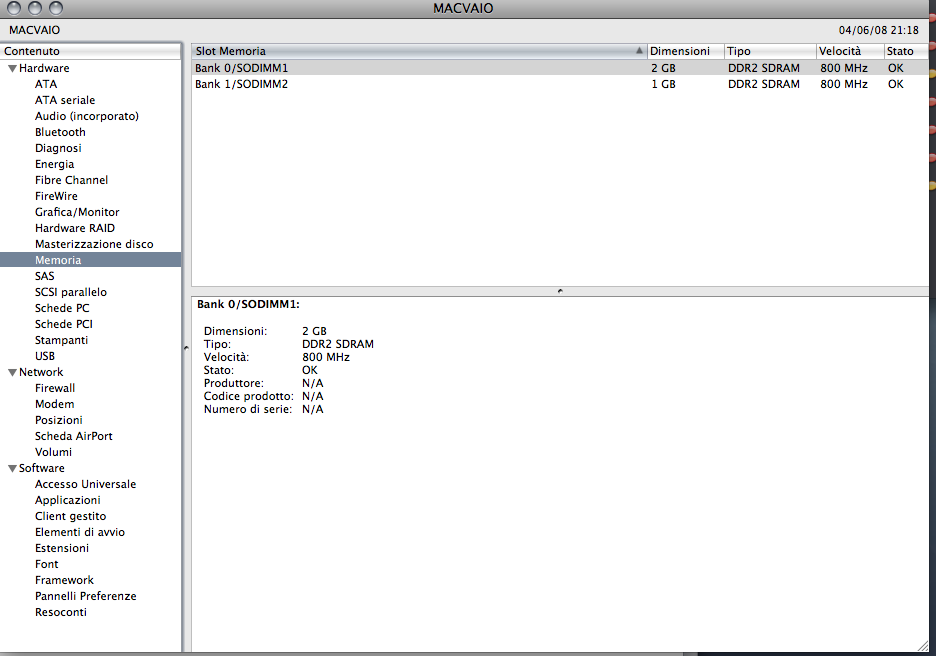

~Eureka Posted June 4, 2008 Share Posted June 4, 2008 Hi guys, Here is the beta AppleSMBIOSEFI I have been working on. It will work with original AppleSMBIOS but will try to fix or add some values that original AppleSMBIOS misses. Therefore, you don't have to worry about AppleSMBIOS being updated. It is based on original AppleSMBIOS and it only works with EFI system right now. It is for both Tiger and Leopard. In addiation, it should fix "About This Mac" crash problem and wrong "Bus Speed" issue. You can change the memory speed. Just boot with "memorySpeed=n" (n is the speed number you want) You can change the memory type. Just boot with "memoryType=n" (n is the type number you want, 18 is DDR, 19 is DDR2) Example: memoryType=19 memorySpeed=533 Again, it is just the beta version and you still need the original AppleSMBIOS with it. Chun-Nan ============================== static const char * SMBMemoryDeviceTypes[] = { "RAM", /* 00h Undefined */ "RAM", /* 01h Other */ "RAM", /* 02h Unknown */ "DRAM", /* 03h DRAM */ "EDRAM", /* 04h EDRAM */ "VRAM", /* 05h VRAM */ "SRAM", /* 06h SRAM */ "RAM", /* 07h RAM */ "ROM", /* 08h ROM */ "FLASH", /* 09h FLASH */ "EEPROM", /* 0Ah EEPROM */ "FEPROM", /* 0Bh FEPROM */ "EPROM", /* 0Ch EPROM */ "CDRAM", /* 0Dh CDRAM */ "3DRAM", /* 0Eh 3DRAM */ "SDRAM", /* 0Fh SDRAM */ "SGRAM", /* 10h SGRAM */ "RDRAM", /* 11h RDRAM */ "DDR SDRAM", /* 12h DDR */ "DDR2 SDRAM", /* 13h DDR2 */ "DDR2 FB-DIMM" /* 14h DDR2 FB-DIMM */ }; ============================== AppleSMBIOSEFI.zip Update: 5/6/2008 1. It will use value of "cpu->externalClock" first. If that value returns 0, it will use value of "FSBFrequency". 2. Add "FSB" flag. You can change the FSB value in case the value is still not correct. Just boot with "FSB=n" (n is the speed number you want) However, it doesn't update the value back to "FSBFrequency" yet. AppleSMBIOSEFI_b2.zip Update: 7/2/2008 1. based on AppleSMBIOS-28 2. Added "serial-number", "board-id", and "system-type". The default serial-number is "W1234567890". 3. Released AppleSMBIOSEFI from memory after adding the values. 4. It should work both on Tiger and Leopard. (I used Tiger to compile the source code.) AppleSMBIOSEFI_28.zip AppleSMBIOSEFI_28Air.zip P.S. CoolbookController won't work with AppleSMBIOSEFI_28 because model is set to "MacPro3,1". Try AppleSMBIOSEFI_28Air instead or change the model to the ones supported by CoolbookController. AppleSMBIOS.vanilla.zip Link to comment https://www.insanelymac.com/forum/topic/108606-applesmbiosefi-for-tiger-and-leopard/ Share on other sites More sharing options...

Chrysaor Posted June 4, 2008 Share Posted June 4, 2008 Working good here with vanilla SMBIOS 1.0.14 (from 5.3). My system can use vanilla SMBIOS without any problems but hardware overview in system profiler gives an error. With SMBIOSEFI system profiler works and using memoryType=19 shows DDR2. Link to comment https://www.insanelymac.com/forum/topic/108606-applesmbiosefi-for-tiger-and-leopard/#findComment-770180 Share on other sites More sharing options...

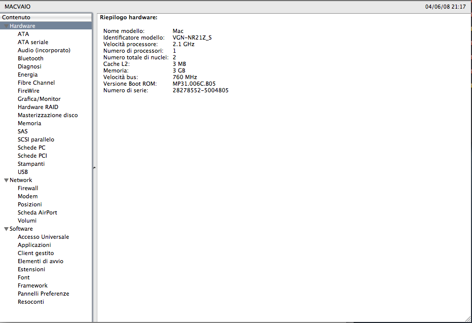

mrroboto Posted June 4, 2008 Share Posted June 4, 2008 it does not show the right bus speed. 760MHz instead of 800MHz is it just comsetic or the real speed? Link to comment https://www.insanelymac.com/forum/topic/108606-applesmbiosefi-for-tiger-and-leopard/#findComment-771131 Share on other sites More sharing options...

macgirl Posted June 5, 2008 Share Posted June 5, 2008 I also have 720Mhz Hus Speed instead of 800 Link to comment https://www.insanelymac.com/forum/topic/108606-applesmbiosefi-for-tiger-and-leopard/#findComment-772427 Share on other sites More sharing options...

SuperNet33 Posted June 5, 2008 Share Posted June 5, 2008 I also have 720Mhz Hus Speed instead of 800 Is there a fix for this yet? Link to comment https://www.insanelymac.com/forum/topic/108606-applesmbiosefi-for-tiger-and-leopard/#findComment-772497 Share on other sites More sharing options...
