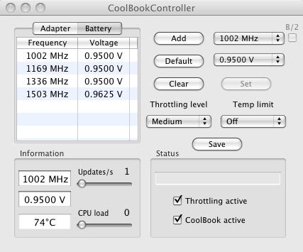

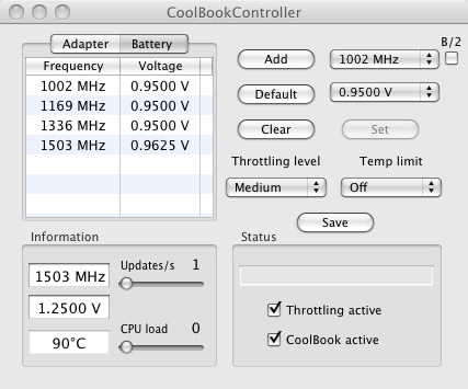

jayman30 Posted August 9, 2008 Share Posted August 9, 2008 Hi skgunner, CoolbookController won't work with AppleSMBIOSEFI_28 because the model is set to "MacPro3,1". Try AppleSMBIOSEFI_28Air instead or change the model to the ones supported by CoolbookController. Chun-Nan Hi Chun-Nan, I tried the AppleSMBIOSEFI_28Air but Coolbook still doesn't throttle for some reason. All settings register OK, but CoolBook can not change the MHz or Voltage from their maximum settings. Here's some screen shots. Coolbook with AppleSMBIOSEFI_28Air and vanilla AppleSMBIOS installed: Coolbook when working with AppleSMBIOS_28 installed: Coolbook offers built in dynamic CPU MHz and Voltage throttling unlike IntelSpeedStep.kext. Thanks for any help with this issue, Link to comment https://www.insanelymac.com/forum/topic/108606-applesmbiosefi-for-tiger-and-leopard/page/6/#findComment-850785 Share on other sites More sharing options...

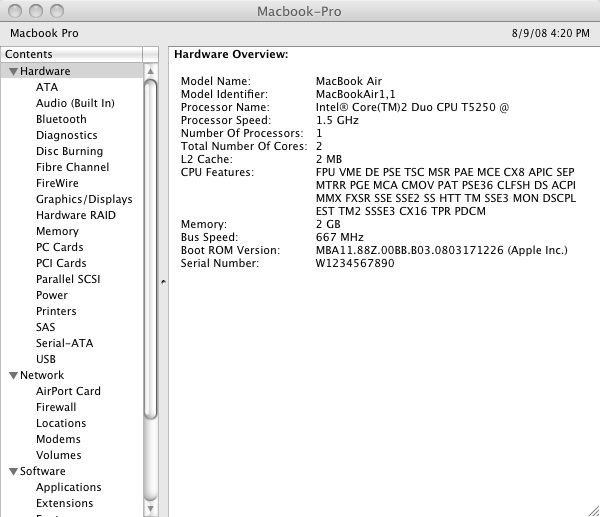

~Eureka Posted August 13, 2008 Author Share Posted August 13, 2008 Hi Chun-Nan, I tried the AppleSMBIOSEFI_28Air but Coolbook still doesn't throttle for some reason. All settings register OK, but CoolBook can not change the MHz or Voltage from their maximum settings. Here's some screen shots. Coolbook with AppleSMBIOSEFI_28Air and vanilla AppleSMBIOS installed: ..... Coolbook when working with AppleSMBIOS_28 installed: ..... Coolbook offers built in dynamic CPU MHz and Voltage throttling unlike IntelSpeedStep.kext. Thanks for any help with this issue, Hi jayman30, As far as I know, it seems that it will change the settings of info.plist inside the ACPI_SMC_PlatformPlugin.kext. And on that info.plist file, it has information which type of CPUs each model has. However, I really don't know too much about Coolbook. (I tried it but I didn't register the software.) Maybe you can check info.plist to see if you get model and CPU correctly. Chun-Nan Hi Chun-Nan Can you explain how to add to "serial-number", "board-id", and "system-type" using your AppleSMBIOSEFI_28? is that thru com.apple.Boot.plist? Thanks Hi Jedric, If you want to change those values, you have to change in the source code. Chun-Nan Link to comment https://www.insanelymac.com/forum/topic/108606-applesmbiosefi-for-tiger-and-leopard/page/6/#findComment-855037 Share on other sites More sharing options...

Jingu Posted August 23, 2008 Share Posted August 23, 2008 I am using the latest AppleSMBIOSEFI-28, Chameleon EFI with Leopard 10.5.4 from retail DVD. I get in System Profiler: Model Name: Mac Model Identifier: Aspire 9520 Processor Name: Intel Core 2 Duo Processor Speed: 2 GHz Number Of Processors: 1 Total Number Of Cores: 2 L2 Cache: 4 MB Memory: 2 GB Bus Speed: 667 MHz I cannot get System Profiler to display MacPro3,1. How would I do that? Curiously, XBench and MenuTemperature both see my computer as MacPro3,1. I just cannot get MacPro3,1 to be displayed in System Profiler. EDIT: Since I have a Notebook, I recompiled the kext to have MacBookPro2,1 as the Model Identifier. I also switched to the original AppleACPIPlatfmorm from the Leopard 10.5.0 retail DVD. Guess what, now I have: Model Name: MacBookPro 17" Model Identifier: MacBookPro2,1 So it looks like it's something with the 1.2.1 AppleACPIPlatform kext that is preventing us from overriding the model names. Link to comment https://www.insanelymac.com/forum/topic/108606-applesmbiosefi-for-tiger-and-leopard/page/6/#findComment-866420 Share on other sites More sharing options...
hellboy Posted September 3, 2008 Share Posted September 3, 2008 hy ! How did you get your AppleSMBIOS to have MacBook Pro as Model Name ? do you can explain me the way you did ? or an help ? Or maybe post your file ? ( sorry for my english, i'm french ) thanks bye Link to comment https://www.insanelymac.com/forum/topic/108606-applesmbiosefi-for-tiger-and-leopard/page/6/#findComment-877878 Share on other sites More sharing options...
hach1r0ku Posted September 3, 2008 Share Posted September 3, 2008 it seems that 1.2.1 gets its model name from the dmi sector of the bios i edited my dmi in the bios using dmicfg it used to say p5k e as model id i change the model name in the dmi to mac pro 3, 1 and boom model id is mac pro 3,1 i have no idea how to change model name tho as mine still shows Mac Link to comment https://www.insanelymac.com/forum/topic/108606-applesmbiosefi-for-tiger-and-leopard/page/6/#findComment-878480 Share on other sites More sharing options...
hellboy Posted September 3, 2008 Share Posted September 3, 2008 I just change my AppleSMBIOS.kext to another one, and I get MacBook Air as model name and MacBookAir1.1 as model id and MBA as start-up ROM. So i think this info are just in the SMBIOS, but nobody get this file from a macbook pro ! ( if this file is different from the macbook no-pro's one ) thank you for your answer i'll test that. Link to comment https://www.insanelymac.com/forum/topic/108606-applesmbiosefi-for-tiger-and-leopard/page/6/#findComment-878500 Share on other sites More sharing options...
