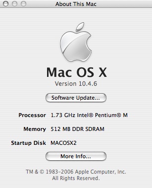

blabla Posted April 23, 2006 Share Posted April 23, 2006 I've successfully installed JaS' 10.4.6 install DVD on my VAIO FJ1S (900 GMA based). It still need a dummy s-video adapter to prevent blue screen. I prefer using headphones plugged on the s-video jack, which is less intrusive than the two wire trick... This is only needed until the log window is here... CI and QE work fine (these did not work for with 10.4.{1,3,5}). FYI, I've also noticed that disabling LDC expand can result in problem getting a native resolution, even with a dummy adapter. Finally, it seems 10.4.6 run faster than previous version (but did not bench...) Cheers. Seb :wq! Link to comment Share on other sites More sharing options...

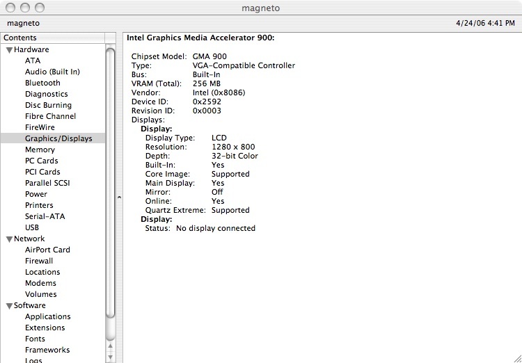

blabla Posted April 24, 2006 Share Posted April 24, 2006 So you all know, 10.4.5 drivers still work in 10.4.6, they're what i'm using now. The ones on the JaS dvd work without CG or QE. Both need dongles to boot for me, but based on what blabla posted, i guess this varies. I'm curious....blabla, how much video memory does system profiler say your gma900 is using, and what are your setting concerning the gfx card in the bios setup? The System Profiler says "256MB used", but I know only 128MB can be allocated. About the BIOS settings, VAIO's BIOS really sucks, nothing can be configured... Just the expand mode on/off I was talking about. Also no configuration about external monitor... FYI, if it helps, here some screenshots of the System Profiler. Cheers, Link to comment Share on other sites More sharing options...
timobo Posted April 24, 2006 Share Posted April 24, 2006 The System Profiler says "256MB used", but I know only 128MB can be allocated. Same as on my X20 - in the BIOS you can choose between automatic, 64 MB or 128 MB, so i set it up to 128 MB and the system profiler also shows me "256 MB used".... Link to comment Share on other sites More sharing options...
Urbz Posted April 25, 2006 Share Posted April 25, 2006 Same here with the "256 MB used" thing. But i noticed a difference with my profiler screen and yours...When i connect the dongle, i get 2 monitors showing up. did you refresh the screens before you took the screenshot? Also, my bios options are just "64 MB or 128 MB", so i can't configure much in there either. Link to comment Share on other sites More sharing options...

blabla Posted April 30, 2006 Share Posted April 30, 2006 Same here with the "256 MB used" thing. But i noticed a difference with my profiler screen and yours...When i connect the dongle, i get 2 monitors showing up.did you refresh the screens before you took the screenshot? I always disconnect the dummy adapter after OSX boots. When it goes into sleep mode after a while, the external monitor is no longer detected, but native res., CI/QE still works... Link to comment Share on other sites More sharing options...
