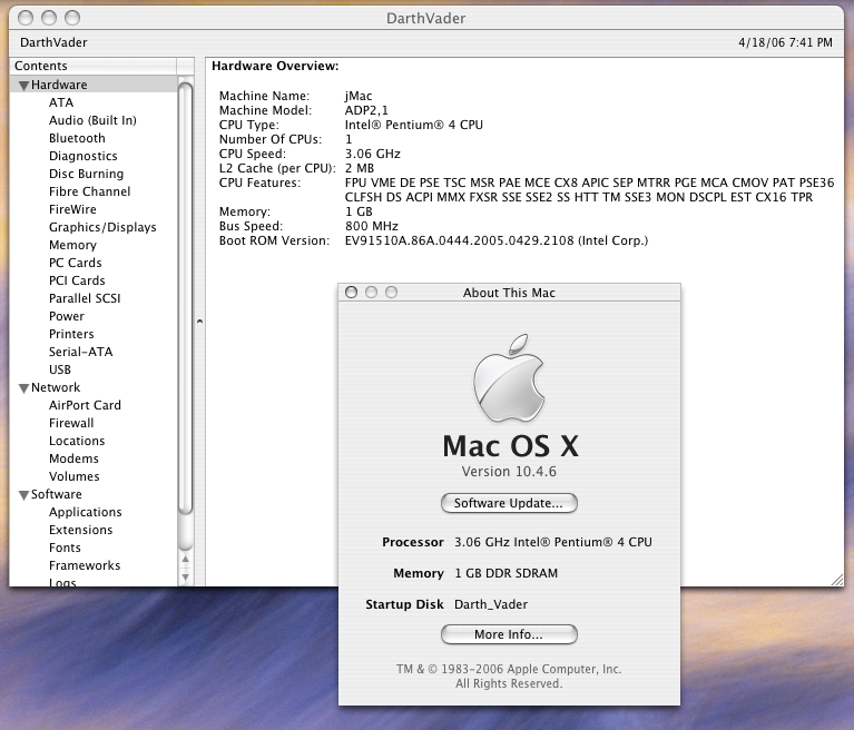

Guest goodtime Posted April 17, 2006 Share Posted April 17, 2006 OSX86, HowTo- GMA900 graphics working on 10.4.6 Intel Mac How to get GMA900 working on 10.4.6 with QE and CI: From 10.4.5 kext copy this file AppleIntel915.kext to your Desktop: Control-Click on AppleIntel915.kext -> Show Package Contents -> Contents -> open "Info.plist" (open using Text Edit or Property List Editor) Property List Editor comes with Xcode/Developer Tools. Under IODVDBundlename change "AppleIntel915DVDDriver" to "AppleIntelGMA950VADriver" Under IOGLBundleName change "AppleIntel915GLDriver" to "AppleIntelGMA950GLDriver" Under IOCFPlugInTypes/ACCF0000-0000-0000-0000-000a2789904e change "AppleIntel915GA.plugin" to "AppleIntelGMA950GA.plugin" Move these Kext's from System/Library/Extensions to your trash [select them in Finder and Cmd-Delete] (Authenicate using your Admin Password): AppleIntel915GLDriver.bundle AppleIntel915GA.plugin AppleIntelGMA950.kext Now copy the modified "AppleIntel915.kext" back to your system from Applications/Utilities/Terminal.app using this command: sudo cp -R ~/Desktop/AppleIntel915.kext /System/Library/Extensions/ Type Admin Password. Reboot. If everything well well you'll something like this under System Profiler: Intel GMA 900: Chipset Model: GMA 900 Type: Display Bus: Built-In VRAM (Total): 64 MB of shared system memory Vendor: Intel (0x8086) Device ID: 0x2582 Revision ID: 0x0004 Displays: Display: Status: No display connected DELL 2001FP: Resolution: 1600 x 1200 @ 60 Hz Depth: 32-bit Color Core Image: Supported Main Display: Yes Mirror: Off Online: Yes Quartz Extreme: Supported Enjoy having your GMA 900 Video working. DVD will now Launch. Quartz Extreme and Core Image are now fully functional. Sincerely, Goodtime Todd's Tech Podcast Keyword: toddcast @ iTunes http://art5dog.com/techcast Link to comment Share on other sites More sharing options...

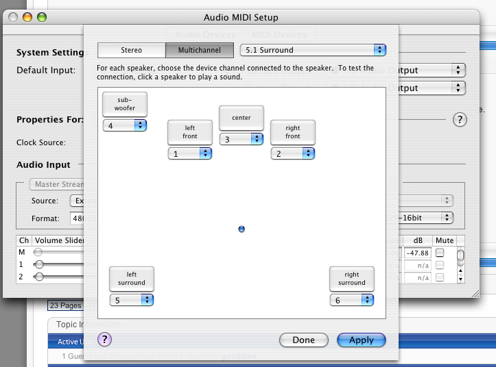

Guest goodtime Posted April 19, 2006 Share Posted April 19, 2006 The GMA900 renaming hack works in 10.4.6. I did get 2 mouse tears. Someone has already included patched Intel 915/900 drivers on a Patched 10.4.6. Installed today. Works great and may work better than my example. As a bonus, I now have 5.1 Surround Sound on my USB Sound card. Never worked before! Cheers, Goodtime Link to comment Share on other sites More sharing options...
Guest goodtime Posted April 19, 2006 Share Posted April 19, 2006 This is a GMA Patched 900 Driver from JaS' latest 10.4.6 patched DVD. This weekend, it can be found by listening to next week's Todd's Tech Podcast [keyword: toddcast] @ iTunes Link to comment Share on other sites More sharing options...
