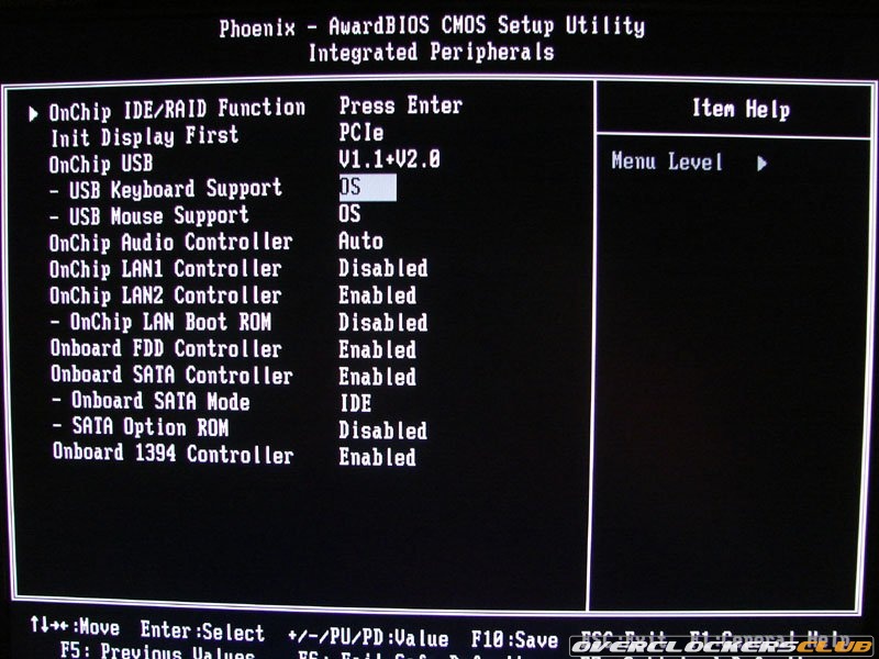

Reniro Posted August 14, 2008 Share Posted August 14, 2008 yes, checked the bios-setup in bios. Must be right, because the installation works and in bios i can see the HDD Now i´m trying with removing Thermal kexts Edit: Same again: "DISK BOOT FAILURE, INSERT SYSTEM DISK AND PRESS ENTER" I will upload pics from the bios ... Maybe something is total wrong ? Link to comment Share on other sites More sharing options...
Mysticus C* Posted August 15, 2008 Author Share Posted August 15, 2008 on board sata mode is set to ide... didnt we tell u to set it AHCI? Link to comment Share on other sites More sharing options...
verdant Posted August 15, 2008 Share Posted August 15, 2008 on board sata mode is set to ide... didnt we tell u to set it AHCI? Hence my not replying......... Link to comment Share on other sites More sharing options...
Reniro Posted August 15, 2008 Share Posted August 15, 2008 There is only IDE or RAID !!! There is only IDE or RAID !!! Waahh, im going crazy... I always have hardware problems :-( stupid Abit Board :-( Link to comment Share on other sites More sharing options...
verdant Posted August 16, 2008 Share Posted August 16, 2008 There is only IDE or RAID !!! Waahh, im going crazy... I always have hardware problems :-( stupid Abit Board :-( Not all BIOSs on MOBOs are the same......perhaps obvious comment but worth noting..... so a MOBO SATA controller chipset/BIOS combo may have these three modes of operation (OR may not have all three): IDE mode setting : no AHCI and no RAID function SATA mode setting : no RAID function but AHCI function (so sometimes SATA mode may be called AHCI mode) RAID mode : both AHCI function and RAID function so I suggest you try setting the onboard SATA control mode to RAID and see what happens..... Link to comment Share on other sites More sharing options...
