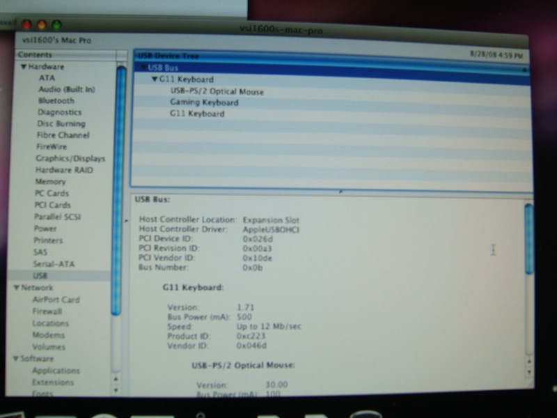

Mysticus C* Posted August 29, 2008 Author Share Posted August 29, 2008 @vsi1600: your usb problem is related to your usb high speed controller not being recognized, so you have to use pcgenusb2 patch or if you update to latest version 10.5.4, use the patch i supplied to you earlier in a link... when usb2 controller is not initialized, hdds like devices that require high voltage doesnt get it, so can not start up. on the other hand, there are some usb flash disks which are usb1.1 backward compatible can work just fine... Thing you can do: 1) In USB tab of the system profiler, check that USB High Speed Controller presents! If it is not there, your high speed usb devices will not work! This requires either pcgenusb2 patch or latest to be the one i send u as a link in an earlier post! 2) Make sure always you have the system.kext version and kernel version matching! (This is the first step to check!) This is USB not mounting issue due to non-matching versions of system.kext and kernel. But even so, USB in system profiler will show all the devices including High Speed USB bus... it just wont mount due to mismathching... 2nd one is easiest to fix... 1st one is the real deal, sometimes it can be fixed, sometimes it cant be... In your situation, it looks like it can be fixed if you use one the solutions I told u, but make sure all the fixes are performed on the same machine... Because if you move the usb hdd to your macbook, and change kexts there, macbook, will rewrite your kextcache(Extensions.mkext) and your original one from macbook will load... It is funny, but it keeps happening... Delete Extensions.mkext on your usb hdd while it is in mcbook,it will be recreated with kextcache from macbook... Funny but it happens To solve this, copy the files to your usb hdd in your macbook! then put back the hdd into your hack internally, boot into safe text mode, -v -s /sbin/mount -uw / rm -R /System/Library/Extensions.mkext rm -R /System/Library/Extensions/caches/com.* rm -R /System/Library/Extensions/IOUSBFamily.kext cp -R /location/to/your/new/IOUSBFamily.kext /System/Library/Extensions/ (you are copying patched IOUSBFamily back to your system again to take control of your high speed bus, aka USB 2.0 == this is the ownership error, which should be showing up at boot process if you read it carefully on the boot screen) chown -R 0:0 System/Library/Extensions/IOUSBFamily.kext chmod -R 755 System/Library/Extensions/IOUSBFamily.kext reboot at boot, use -v -f report back... success or failure... @jade ray: Provide details! what are you trying to install? R3? or Kalyway? Also your problem is known on certain hdd+nforce.... But to be sure, If you tried iatkos r3, and caused this error? than try with kalyway 10.5.2 please, and using disk utility wipe everything, repartion, with 3 partitions.... 20gb main osx journaled + 20 gb test osx journaled + rest of hdd share dos/fat (hdd size partition_name partition type) and use options to make sure hdd is MBR partition scheme Link to comment Share on other sites More sharing options...
