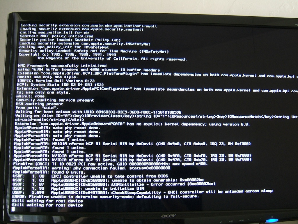

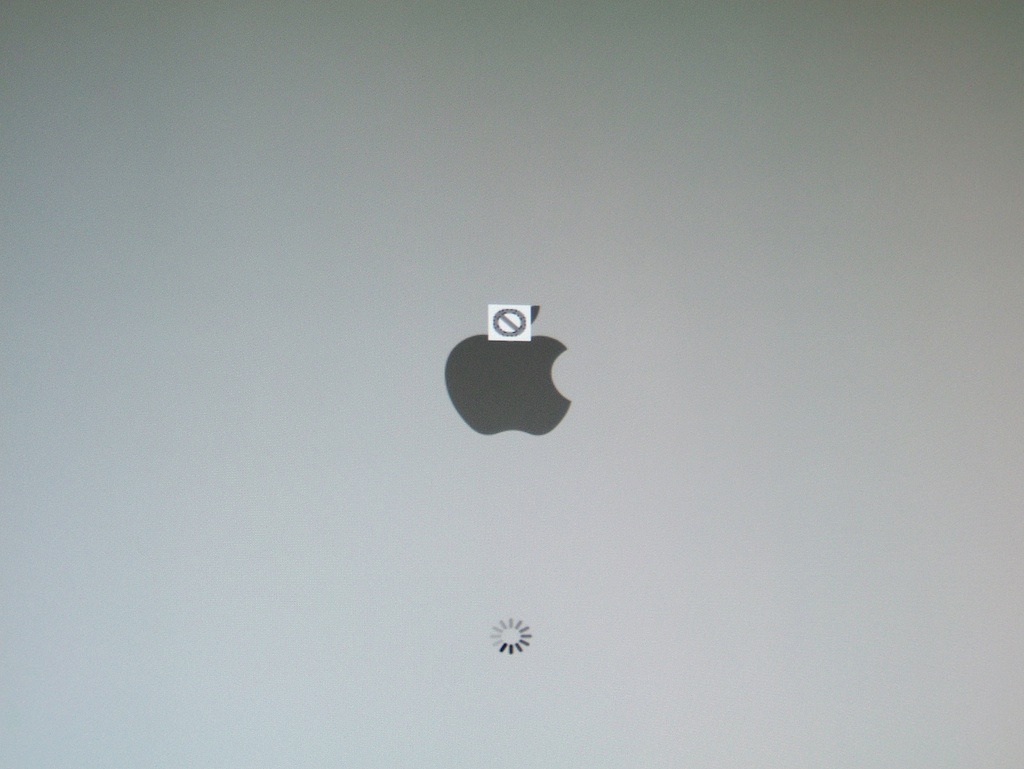

verdant Posted August 21, 2008 Share Posted August 21, 2008 No, you wrong I have a Nforce MOBO with intel Quad Core 6600. AMD is my old PC and mac work great in this. But in my new intel Quad Core+Nforce MOBO mac no boot. See the screens in the before post. Need yours HELP. Sorry my mistake I misread your post..... I believe your Acer MOBO is nForce 630i chipset based.....? Will be online later..... Link to comment Share on other sites More sharing options...
Mysticus C* Posted August 21, 2008 Author Share Posted August 21, 2008 No, you wrong I have a Nforce MOBO with intel Quad Core 6600. AMD is my old PC and mac work great in this. But in my new intel Quad Core+Nforce MOBO mac no boot. See the screens in the before post. Need yours HELP. your issue is most likely (99% sure) bad bios issue: system stops loading after those buffer messages... try the r3 bad bios patch... you should be able to find a link to bad bios patch around pages 4-8 by equate... your issue looks like the bad bios issue... some additional stuffs in the bios causing AppleACPIPlatform.kext to not load correctly... the issue can be solved using an old version (10.4.7 or 10.4.8 not very sure) of AppleACPIPlatform.kext if you know how to inject a kext into boot, use that method instead, but you still need to get taht old acpiplatform driver into installation after dvd installation done... r3 have an option to install those driver, but pure r3 doesnt, taht s why u need the bad bios patch for the r3... but i suggest using kalyway 10.5.2 bcoz it comes with inject command as well, so all you need is to inject old appleacpiplatform.kext to boot... it will allow u to boot and install... but remember, it will allow u to install but after installation is done, you will still need to get that acpi driver into the hdd again... which should not be very hard... if you already have another osx installation handy around... just move the hdd to that another pc, or use a program to copy that file back to system.... hope it is not complicated... also this doesnt mean that your pata/sata controller will be recognized to let you install... bcoz first step is to be able to get pass that buffer message section.... (for more info on bad bios issue go to http://osrom.net/biosmod/) good luck Link to comment Share on other sites More sharing options...
antfros Posted August 22, 2008 Share Posted August 22, 2008 Can you give me a link for r3 bad bios patch? only found patch for r2. Thanks Link to comment Share on other sites More sharing options...
verdant Posted August 22, 2008 Share Posted August 22, 2008 Can you give me a link for r3 bad bios patch? only found patch for r2. Thanks Hi there, glad to help.....here is EqUaTe's iATKOS Patch.zip.....it includes the Bad Bios patch and all else you need to patch r3......you need to read EqUaTe's posts in this thread to understand the sequence of versions...... Link to comment Share on other sites More sharing options...
antfros Posted August 22, 2008 Share Posted August 22, 2008 Thanks Haxi and Mysticus In this link http://osrom.net/biosmod i found a modbios for my nforce. Flash it and now not got bad bios iusse Link to comment Share on other sites More sharing options...
Mysticus C* Posted August 22, 2008 Author Share Posted August 22, 2008 glad it worked ... many people have this issue, but very few them is aware of it... Link to comment Share on other sites More sharing options...

yossarian22 Posted August 23, 2008 Share Posted August 23, 2008 I made a post in the kalyway thread, but this one seems more relevant so I am reposting here... My hardware is in the sig, and here are screenshots of what Kalyway and iAtkos give me respectively... Kalyway: iAtkos: I was originally trying to install to a sata hdd, but I swapped in the IDE for the install (with the intention of mirroring the drive back onto a sata drive later) because that seems to create less problems... still no luck. I also tried pulling out one stick of ram as well as typing "cpus=1 maxmem=2048" at the boot prompt, but no luck as well.. Thanks in advance for any advice! Link to comment Share on other sites More sharing options...
verdant Posted August 23, 2008 Share Posted August 23, 2008 I made a post in the kalyway thread, but this one seems more relevant so I am reposting here... My hardware is in the sig, and here are screenshots of what Kalyway and iAtkos give me respectively... Kalyway: iAtkos: I was originally trying to install to a sata hdd, but I swapped in the IDE for the install (with the intention of mirroring the drive back onto a sata drive later) because that seems to create less problems... still no luck. I also tried pulling out one stick of ram as well as typing "cpus=1 maxmem=2048" at the boot prompt, but no luck as well.. Thanks in advance for any advice! Hi there, A number of things to ask: 1) Are you installing from a SATA or PATA DVDRW? 2) What are your SATA & PATA (IDE) BIOS options and settings? 3) Have you set Execute Disable Bit [Enabled] ACPI APIC Support [Enabled] ACPI Suspend Mode [s3] or [s1] or [s1 and S3] 4) Are you able to find out your IDE /SATA / RAID controller device and vendor IDs via Windows, i.e. via the Device Manager IDE /SATA / RAID controller Properties/Hardware IDs....? Link to comment Share on other sites More sharing options...

yossarian22 Posted August 23, 2008 Share Posted August 23, 2008 I updated to the bios I posted, which as far as I can tell is the newest.. and it's still doing the same thing.. AppleNForceATA: warning: phy connection failed. status=0x00000000 AppleNForceATA: warning: phy connection failed. status=0x00000000 AppleNForceATA: warning: phy connection failed. status=0x00000000 FireWire (OHIC) TI ID 8023 PCI now active, GUID 808080050000044b; max speed s400. AppleNForceATA: found 0 units. AppleNForceATA: found 0 units. AppleNForceATA: found 0 units. USBF: 1. 91 EHCI controller unable to take control from BIOS USBF: 1. 94 AppleUSBEHCI[0x3be7000]: unable to obtain ownership: 0xe00002be USBF: 1. 98 AppleUSBEHCI[0x3be7000]: UIMInitialize - Error occurred (0xe00002be) USBF: 1. 103 AppleUSBEHCI: unable to initialize UIM USBF: 5.697 AppleUSBOHCI[0x3a8e000]::CheckSleepCapability - OHCI controller will be unloaded across sleep ERROR: FireWire unable to determine security-mode; defaulting to full-secure Still waiting for root device Still waiting for root device Still waiting for root device Still waiting for root device.... =| Link to comment Share on other sites More sharing options...
Mysticus C* Posted August 23, 2008 Author Share Posted August 23, 2008 did you create an hfs partition in windows? or better ask this way, do you have additional partitions? or do you have only vista/xp partition on the hdd? the reason for the question is, if in initial boot, there is no partition to be able to boot or/better-say able to temp write files, it may give that error due to all partitions are non recognized???... do you have an additional hdd at your disposal, as low as 10gb would do, just format it with fat32? it should be initialized i think... Link to comment Share on other sites More sharing options...
verdant Posted August 23, 2008 Share Posted August 23, 2008 Check in BIOS that your Seagate IDE HDD is connected on IDE Channel 0 Master and that your SATA DVDRW is connected on SATA 1 (A0)..... Check in BIOS that the Hard Disk Boot Priority is Pri. Master Check in BIOS that your First Boot Device is CDROM and Second Boot Device is Hard Disk Try in BIOS Serial-ATA Controller [sATA-0] Try in BIOS IDE HDD Block Mode [Disabled] Link to comment Share on other sites More sharing options...
yossarian22 Posted August 23, 2008 Share Posted August 23, 2008 did you create an hfs partition in windows? or better ask this way, do you have additional partitions? or do you have only vista/xp partition on the hdd? the reason for the question is, if in initial boot, there is no partition to be able to boot or/better-say able to temp write files, it may give that error due to all partitions are non recognized???... do you have an additional hdd at your disposal, as low as 10gb would do, just format it with fat32? it should be initialized i think... I'll try this with the IDE drive Thanks for the help! Check in BIOS that your Seagate IDE HDD is connected on IDE Channel 0 Master and that your SATA DVDRW is connected on SATA 1 (A0)..... Check in BIOS that the Hard Disk Boot Priority is Pri. Master Check in BIOS that your First Boot Device is CDROM and Second Boot Device is Hard Disk Try in BIOS Serial-ATA Controller [sATA-0] Try in BIOS IDE HDD Block Mode [Disabled] I just went through all of this... no luck unfortunately I'm going to try formatting that IDE drive to HFS now, as per Mysticus' suggestion... I just tried with the IDE drive formatted to HFS, and still no luck... I'm in the process of getting iAtkos r2 to try out with the bad bios patch, 4i, to see if I have any luck with either of those, but I doubt it will make any difference... hmmmm, very strange... Link to comment Share on other sites More sharing options...
