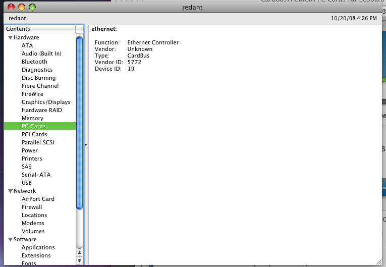

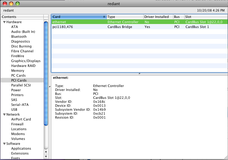

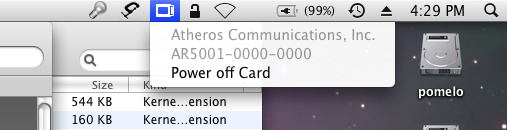

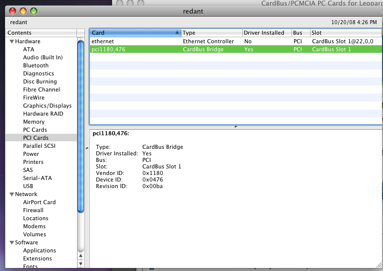

b:z Posted October 20, 2008 Share Posted October 20, 2008 I am using Cisco Air-CB21AG-A-K9, it does not work After using beta3 version, the PCI card icon show on dock as: Atheros Communication Inc (hidden text) AR5001-0000-0000 (hidden text) Power Off Card (unhidden) I can't enable this card to make it works. The led status is always blink (green) Here is the screenshot: Please help me to fix this. Thank you Link to comment https://www.insanelymac.com/forum/topic/81036-cardbuspcmcia-pc-cards-for-leopard/page/31/#findComment-937271 Share on other sites More sharing options...

aliasa_anderson Posted November 8, 2008 Share Posted November 8, 2008 I am using Cisco Air-CB21AG-A-K9, it does not work After using beta3 version, the PCI card icon show on dock as: Atheros Communication Inc (hidden text) AR5001-0000-0000 (hidden text) Power Off Card (unhidden) I can't enable this card to make it works. The led status is always blink (green) Here is the screenshot: Please help me to fix this. Thank you Hi b:z were you able to disply "PCI Cards" in System Profiler" before you used these kexts ? In my case i have a number of devices attached(with @ ,like- nvidia graphics card ,ethernet etc) to key PCI2PCIBridge in ioreg but none is displayed in system profiler under PCI Cards. Chun-nan kindly suggest. b:z do you have the IO802.11Family.kext loaded ?Because the screenshots suggest that driver is not loaded. Link to comment https://www.insanelymac.com/forum/topic/81036-cardbuspcmcia-pc-cards-for-leopard/page/31/#findComment-958796 Share on other sites More sharing options...
b:z Posted November 8, 2008 Share Posted November 8, 2008 Ah, i made it works. Now i have the PMCIA works normally, Cisco Air-CB21AG-A-K9. The way i did, referred here http://forum.insanelymac.com/index.php?showtopic=40317 Link to comment https://www.insanelymac.com/forum/topic/81036-cardbuspcmcia-pc-cards-for-leopard/page/31/#findComment-958935 Share on other sites More sharing options...
