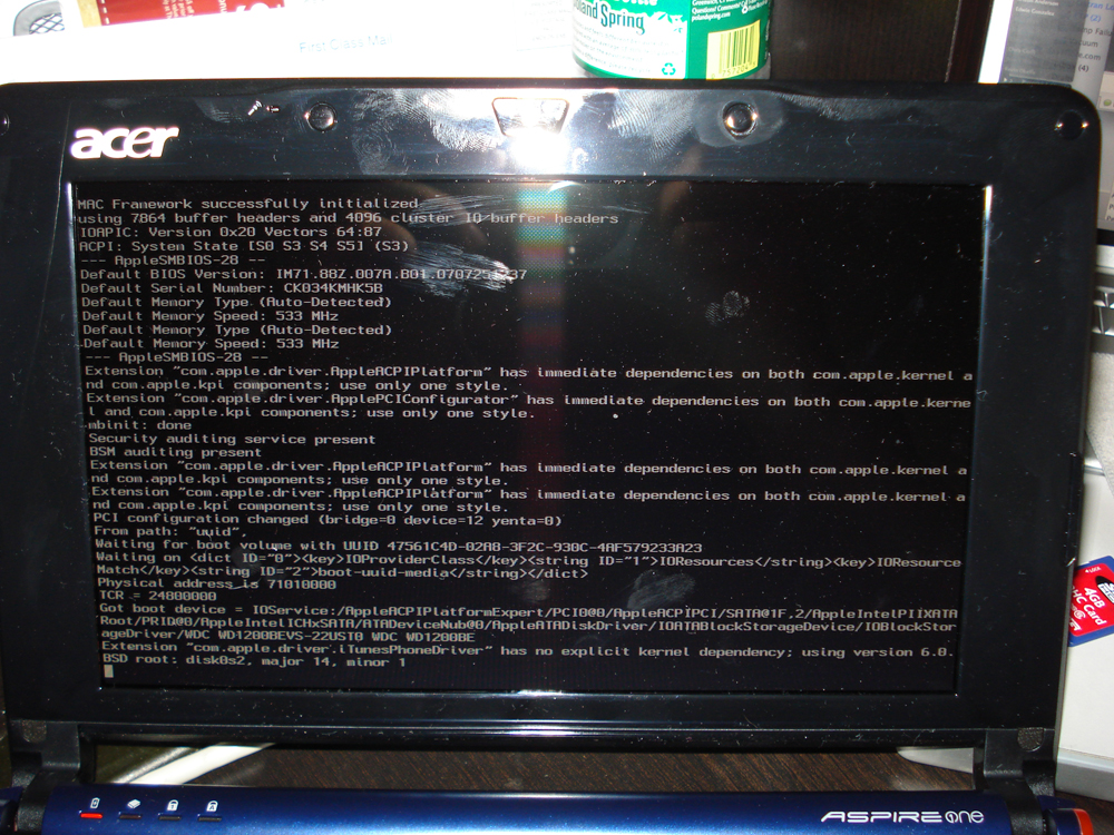

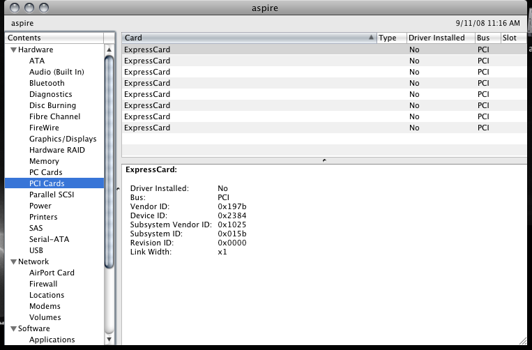

David Fiore Posted September 11, 2008 Share Posted September 11, 2008 chun, i have an acer aspire one, with a jmicron card reader built in. It would show in system profiler as pci card, express card with no driver loaded. I tried to add your beta 3 drivers and now i dont get it to boot. below is a screen shot of the system where it hangs when booting with -f -v. any ideas lspci output from ubuntu: 04:00.0 System peripheral: JMicron Technologies, Inc. Unknown device 2382 04:00.2 SD Host controller: JMicron Technologies, Inc. Unknown device 2381 04:00.3 System peripheral: JMicron Technologies, Inc. Unknown device 2383 04:00.4 System peripheral: JMicron Technologies, Inc. Unknown device 2384 dave UPDATE: the beta8 drivers allow me to boot up. Attached is a picture of about this mac. please let me know what if anything will allow you to further assist. Link to comment https://www.insanelymac.com/forum/topic/81036-cardbuspcmcia-pc-cards-for-leopard/page/29/#findComment-886979 Share on other sites More sharing options...
