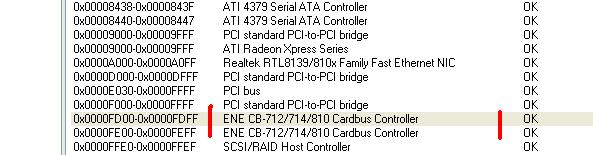

neasteflorin Posted July 19, 2008 Share Posted July 19, 2008 Would this work for my ENE Card Reader/PCMCIA on PCI? Using Leopard Kalyway. Link to comment https://www.insanelymac.com/forum/topic/81036-cardbuspcmcia-pc-cards-for-leopard/page/27/#findComment-825060 Share on other sites More sharing options...
