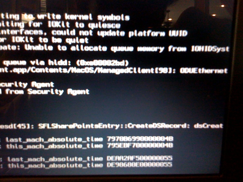

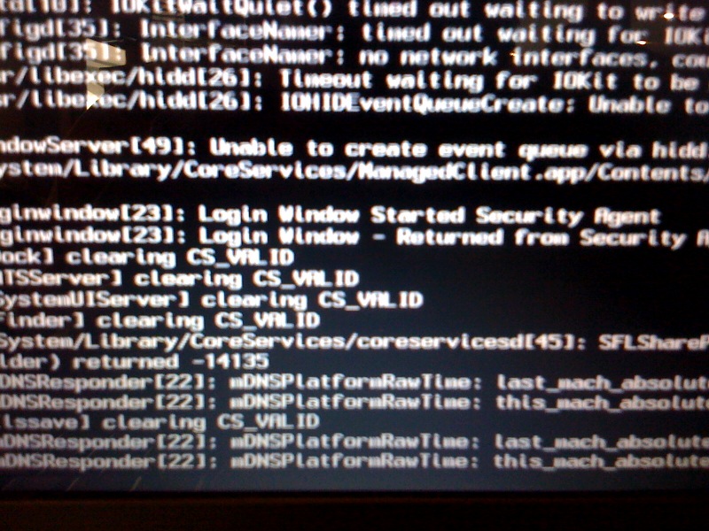

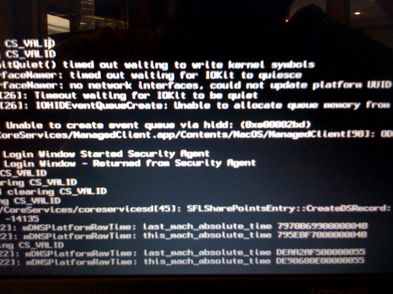

insaneu Posted August 21, 2008 Share Posted August 21, 2008 Hi Chan-nun and everybody here! I have just installed Kaliway 10.5.2 with vanilla Kernel on my DS4 and everythng was ready to go except my soundcard, which consist of a PCMCIA plug into a PCMCIA-PCI adapter. After installing PCCard.10.5.2.beta3.mpkg.zip i cant get into Macos again. It stays in the white screen with the Apple and the loading icon turning forever. This was my first attempt to install my PCMCIAtoPCI adapter: Ricoh R/RL/ET/RC/5C475(II),R5C20 or compatible ---> thats what it shows in the device manager on windows XP, the brand i am not sure, i think its Buffalo (tell me if you need it please) Anybody got an idea about what could be happening? Was i supposed to install first the PCCard.10.5.2.beta3.kext.zip? Sorry but i couldnt get it clear by the explanation at the beginning of this post. I am really new to all of this so i got pretty lost. Even if i cant make the adapter work..is there an easy way to restore my system? can i just enter in safe mode like windows or something similar to fix whatever the installer broke? Thanks in advance for your work and tips...awesome 32 support pages!! Link to comment https://www.insanelymac.com/forum/topic/81036-cardbuspcmcia-pc-cards-for-leopard/page/28/#findComment-864472 Share on other sites More sharing options...
insaneu Posted August 22, 2008 Share Posted August 22, 2008 **EDIT: After a new fresh install i tried to install the Kext v8 package instead of mpkg. I installed the Kexts with Kext helper. Now i can see something being recognized when booting with -v, but i still cant get into the system, or if i do, it freezes quickly after some browsing. I took this 2 pics in 2 different boots: Also i am a bit confused on this part of the first topic: [iMPORTANT] If you get the kernel panic, PLEASE check if you have replaced the following files to make your cardbus slot working before: AppleACPIPlatform AppleAPIC IOACPIFamily Where am i supposed to find these files so that i can overwrite my old ones? Thanks! Link to comment https://www.insanelymac.com/forum/topic/81036-cardbuspcmcia-pc-cards-for-leopard/page/28/#findComment-864906 Share on other sites More sharing options...

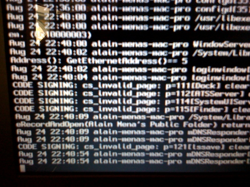

SebastianAlain Posted August 24, 2008 Share Posted August 24, 2008 Alright it might be a little hard for me to explain what's going on due to me not knowing very much about Mac. I've been working day in and day out trying to figure this out and get a 100% working Acer MacOSX86 however no luck. My audio laggs and no network interface shows up at all. Someone else with an Acer like mines told me to install the PCCARD Beta 3 and it should work. I tried, however it just keeps blowing my OS out of the water. It even changed the name from the 5 second countdown window thing. It's something "-s1" now. Here is the picture after letting it sit there for a while trying to let it load..... It's fast but sits there for ever. My photos are not great so please feel free to ask about retaking them. And they might be out of order. It's an Acer Extensa 4420 AMD Dual Core 1.9Ghz 2GB Ram Link to comment https://www.insanelymac.com/forum/topic/81036-cardbuspcmcia-pc-cards-for-leopard/page/28/#findComment-867526 Share on other sites More sharing options...
~Eureka Posted August 24, 2008 Author Share Posted August 24, 2008 **EDIT: After a new fresh install i tried to install the Kext v8 package instead of mpkg. I installed the Kexts with Kext helper. Now i can see something being recognized when booting with -v, but i still cant get into the system, or if i do, it freezes quickly after some browsing. I took this 2 pics in 2 different boots: ..... Also i am a bit confused on this part of the first topic: [iMPORTANT] If you get the kernel panic, PLEASE check if you have replaced the following files to make your cardbus slot working before: AppleACPIPlatform AppleAPIC IOACPIFamily Where am i supposed to find these files so that i can overwrite my old ones? Thanks! Hi insaneu, It seems that your Pccard bridge is activated and your pccard device is found. Try to install PCCard.10.5.2.beta3.zip (both IOPCIFamily and IOPCCardFamily) via KextHelper to see if it makes any difference. Let me know the result. Thanks. Chun-Nan Chun-Nan,I have a Vaio VGN-TXN15p. I am trying to get OSX working. From what I understand, it is possible according to this post. I bought 3-4 other Mini PCI-E cards: Apple native card, DW1490, DW1390 etc. Here is the problem that I am having: Mini pci port is not recognized. Cannot use the en0-->en1 trick because networkinterfaces.plist the EN option is not even on the list, only FW. The light never powers on. I have tried almost every build possible, and it doesn't seem to work. The crazy part is - the desciption in the post makes it look easy. Could you please let me know what you think is going wrong here? I tried your KEXT with 10.5.2 and got a kernel error. Any tips? Thank you for your great work? Hi tiomka, If you get kernel panic, I will suggest you to check the file permissions on those files you installed again. If possible, post your dmesg log and ioreg_sp.txt so that I can check it. Thanks. Chun-Nan Alright it might be a little hard for me to explain what's going on due to me not knowing very much about Mac. I've been working day in and day out trying to figure this out and get a 100% working Acer MacOSX86 however no luck. My audio laggs and no network interface shows up at all. Someone else with an Acer like mines told me to install the PCCARD Beta 3 and it should work. I tried, however it just keeps blowing my OS out of the water. It even changed the name from the 5 second countdown window thing. It's something "-s1" now. Here is the picture after letting it sit there for a while trying to let it load..... It's fast but sits there for ever. My photos are not great so please feel free to ask about retaking them. And they might be out of order. It's an Acer Extensa 4420 AMD Dual Core 1.9Ghz 2GB Ram Hi SebastianAlain, I am not sure what happened to your machine. It should work on AMD machine. I will suggest you to restore the files you replaced (IOPCIFamily and IOPCCardFamily) first to see if it is back to original. Chun-Nan Link to comment https://www.insanelymac.com/forum/topic/81036-cardbuspcmcia-pc-cards-for-leopard/page/28/#findComment-867539 Share on other sites More sharing options...
SebastianAlain Posted August 24, 2008 Share Posted August 24, 2008 Chun-Nan... I restored those two, but no luck. I reinstalled the whole OS and the computer is back up and running. However I'm still lacking everything. The computer doesn't even show it has Ethernet and Wireless.. non the less the PC Card. Hmmmm any idea? What information can I provide to get help? Thank you so much btw!! Link to comment https://www.insanelymac.com/forum/topic/81036-cardbuspcmcia-pc-cards-for-leopard/page/28/#findComment-867763 Share on other sites More sharing options...
