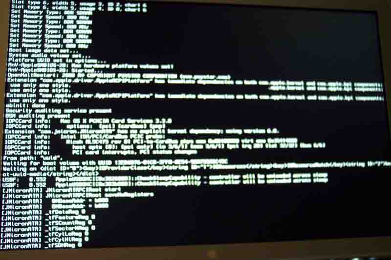

beefydog Posted December 29, 2008 Share Posted December 29, 2008 Hi, these are my dmesg and ioreg respectively. I used the one on the mediashare, IOPCMCIAFamily.Leopard. my dmesg Extension "com.apple.driver.ApplePCIConfigurator" has immediate dependencies on both com.apple.kernel and com.apple.kpi components; use only one style. Extension "com.apple.driver.AppleOnboardPCATA" has no explicit kernel dependency; using version 6.0. kmod_control/start failed for com.orByte.driver.PCGenUSBEHCI; destroying kmod \^[[33mFailed to load extension com.orByte.driver.PCGenUSBEHCI. IOPCCard info: Mac OS X PCMCIA Card Services 3.2.8 IOPCCard info: options: [pci] [cardbus] [pnp] IOPCCard info: Intel ISA/PCI/CardBus PCIC probe: IOPCCard info: O2Micro OZ711MP1/MS1 rev 21 PCI-to-CardBus phys mem 0x78108000 virt mem 0x32a24000 IOPCCard info: host opts [0]: [pci/way] [pci irq 19] [lat 64/64] [bus 5/5] IOPCCard info: PCI card interrupts, PCI status changes Got boot device = IOService:/AppleACPIPlatformExpert/PCI0@0/AppleACPIPCI/SATA@12/AppleVIAATARoot/PRID@0/AppleVIAATADriver/ATADeviceNub@0/AppleATADiskDriver/IOATABlockStorageDevice/IOBlockStorageDriver/WDC WD800BEVS-07RST0 WDC WD800BEVS-07RST0/IOFDiskPartitionScheme/Untitled 3@3 Callisto: Model Radeon XPRESS 200M (PCIE) (rv410) Callisto: done with Radeon XPRESS 200M (PCIE) ioreg for the pci wifi card RaLink RT2561/RT61 rev B 802.11g [1814:0302] +-o network@9 <class IOPCIDevice, registered, matched, active, busy 0, retain 6> | | | | { | | | | "IOPCIResourced" = Yes | | | | "IOInterruptControllers" = ("io-apic-0") | | | | "IOName" = "network" | | | | "subsystem-id" = <33b80000> | | | | "IODeviceMemory" = (({"address"=2014314496,"length"=32768})) | | | | "class-code" = <00800200> | | | | "IOPowerManagement" = {"CurrentPowerState"=2} | | | | "revision-id" = <00000000> | | | | "IOInterruptSpecifiers" = (<1000000007000000>) | | | | "assigned-addresses" = <1048048200000000000010780000000000800000> | | | | "built-in" = <00> | | | | "IOChildIndex" = 3 | | | | "device-id" = <02030000> | | | | "vendor-id" = <14180000> | | | | "name" = "network" | | | | "subsystem-vendor-id" = <62140000> | | | | "reg" = <00480400000000000000000000000000000000001048040200000000000000000000000000800 00> | | | | "compatible" = <"pci1462,b833","pci1814,302","pciclass,028000"> | | | | } / My question is: based from the ioreg, i think that my card is detected, but even if I installed the drivers coming from the ralink website, it does not work. I also tried placing the RT61Cardbusdriver.kext to io80211.kext and ionetworking.kext and when you boot in verbose mode, the message displayed is cannot map the RT61 driver and that it has immediate dependencies on a certain file. Can you tell me your opinion on what I should do on this card. thanks P.S. My dvd-drive is screwed again even with the -f flag at startup. I don't know what is causing this problem. At first, I thought it was the RT61 driver but after removing it, it worked once or twice then now it's screwed again. Link to comment https://www.insanelymac.com/forum/topic/81036-cardbuspcmcia-pc-cards-for-leopard/page/35/#findComment-1017834 Share on other sites More sharing options...
kizwan Posted December 29, 2008 Share Posted December 29, 2008 Hi, these are my dmesg and ioreg respectively. I used the one on the mediashare, IOPCMCIAFamily.Leopard. ..... My question is: based from the ioreg, i think that my card is detected, but even if I installed the drivers coming from the ralink website, it does not work. I also tried placing the RT61Cardbusdriver.kext to io80211.kext and ionetworking.kext and when you boot in verbose mode, the message displayed is cannot map the RT61 driver and that it has immediate dependencies on a certain file. Can you tell me your opinion on what I should do on this card. thanks P.S. My dvd-drive is screwed again even with the -f flag at startup. I don't know what is causing this problem. At first, I thought it was the RT61 driver but after removing it, it worked once or twice then now it's screwed again. I have same wireless card but mine is a cardbus (PCMCIA), not PCI or mini-PCI (internal). It have same chipset, RT61. I believe the driver provided by Ralink is not for Intel mac except for USB wireless device. I did not found anyone was able to get this card working. What do you mean by your dvd-drive screwed again? If it is sometime detected & sometime undetected, I have same situation. I don't know why but if I boot into windows, insert cd/dvd to the drive, then eject the cd/dvd, then restart to OS X, I will be able to get my DVD-drive detected. Try it. kizwan Link to comment https://www.insanelymac.com/forum/topic/81036-cardbuspcmcia-pc-cards-for-leopard/page/35/#findComment-1017999 Share on other sites More sharing options...

Tek_No Posted January 4, 2009 Share Posted January 4, 2009 Hey Chun-nan. Sorry for the late reply - didn't had the time to play around the last 2 month. I tried your new IOPCMCIAFamily.kext with 10.5.2 but no success. First issue - the same old bad bridge mapping thing... but even worse - I could not boot with it, not even after putting out the pcmcia adapter card. Then I tried with 10.5.5... same thing here. Then 10.5.6 and your 10.5.6 version of the kext - same mistake again. But now there comes the interesting part - my system has 4 GB Ram, and I just tried putting out 2 GB... voila - the card is recognized ... I don't know if it's really working but at least it seems to be detected right. Unfortunately I still can't boot with IOPCMCIAFamily.kext. Tried a ton of combinations of different kexts but no success. The attached picture shows system with 2GB and pcmcia-adapter booting with -v... (at this point it stucks) it's basically the same with 4gb except for showing bad bridge mapping etc. ... and it's also the same without pcmcia card except that there is nothing about the adapter card. At least this seems to point to the right direction and I really start believing that in my case, the problem is not (and never has been) the kext or the adapter card but something else on the system. Any idea? here are my specs: Gigabyte GA-P35-DS3 (Rev2) - P35 + ICH9 Q6600, 4GB Ram, 8600GT, PCMCIA Card with Ricoh chip 500GB SATA HDD and SATA DVD connected to ICH9 south bridge iPC 10.5.6 Now THAT could really make sense: I have been trying for months now to get pcmcia back working on my HP8710p (as it was working months ago) using all available versions of chun-nan's kexts but with the exact same problems as you're describing here. I never thought about this before but the only thing that has been changed inside my laptop are: - a bigger and faster hdd - 4Gb of RAM instead of 2Gb So the 4GB could indeed be the reason why it was working fine for me before the upgrade and it isn't after... Take care, Tek_No Link to comment https://www.insanelymac.com/forum/topic/81036-cardbuspcmcia-pc-cards-for-leopard/page/35/#findComment-1026239 Share on other sites More sharing options...
oline Posted January 5, 2009 Share Posted January 5, 2009 - 4Gb of RAM instead of 2Gb So the 4GB could indeed be the reason why it was working fine for me before the upgrade and it isn't after... Take care, Tek_No Hi Tek_No I reduced my ram by two gig , back to 2 gig from 4gig, my PCMCIA slot worked with the 4 gig but, was flaky and caused lock ups. now it's back to 2 gig and all is well on my 10.5.4 partition. 10.5.6 is another story, apple changed the ground rules yet again, I have not had time to play with chun-nans newest pcmcia kext, but should be able to do that in a week or so I hope. Cheers oline Link to comment https://www.insanelymac.com/forum/topic/81036-cardbuspcmcia-pc-cards-for-leopard/page/35/#findComment-1027298 Share on other sites More sharing options...
