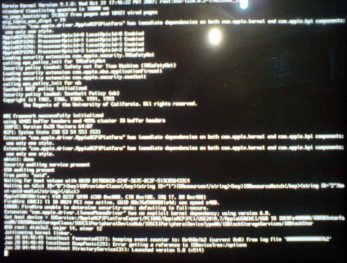

TylerAfx Posted January 17, 2008 Share Posted January 17, 2008 followed your nice guide, installed fine, everything went nice and as described, now I run into that final boot error, when trying to boot into the installed Leopard the first time. Grey Screen and hit reboot. -v gives me the following messages at the end and freezes ------....Regents of the University of California. All rights reserved. MAC Framework successfully initialized Using 16384 Buffer Headers and 4096 Cluster IO buffer headers IOAPIC: version 0x20 vectors 64:87 ACPI : System State [s0 S3 S4 S5] (S3) Extension "com.apple.driver.AppleACPIPlatform" has immediate dependencies on both com.apple.kernel and com.apple.kpi components: use only one style. Extension "com.apple.driver.ApplePCIConfigurator" has immediate dependencies on both com.apple.kernel and com.apple.kpi components: use only one style. Extension "com.apple.driver.AppleACPIPlatform" has i ----frozen not sure why this happens, just found that disabling LPT and Parallel Ports in the Bios influenced where the last line freezes :censored2: but its only a matter of letters, eg.: ..has imm or .. has i ( like above) now going to try to delete the AppleEFIRuntime.kext and see if that helps my specs : GA P35 DS3P Q6600 G0 Stepping Sparkle NVidia 8800GT EDIT : after deleting AppleEFIRuntime.kext and shifting some Bios Settings ( CPUID limit, HT Support, HPET enabled/disable/ 64/32 bit) I keep getting further but not till final boot, ----- last message was via "-v -x" and "-v" ..... /usr/sbin/ocspd[68]: starting (or [69]) I have no idea what to do cheers thanks in advance Tyler Link to comment https://www.insanelymac.com/forum/topic/75863-full-install-guide-ga-p35-ds3p/page/7/#findComment-582614 Share on other sites More sharing options...
consolation Posted January 18, 2008 Share Posted January 18, 2008 followed your nice guide, and shifting some Bios Settings ( CPUID limit, HT Support, HPET enabled/disable/ 64/32 bit) I keep getting further but not till final boot, ----- last message was via "-v -x" and "-v" ..... /usr/sbin/ocspd[68]: starting (or [69]) Tyler HT -off cpuid -off hpet- on, 64 bit try booting with -v -f -x, if works try a normal boot. Link to comment https://www.insanelymac.com/forum/topic/75863-full-install-guide-ga-p35-ds3p/page/7/#findComment-583739 Share on other sites More sharing options...
TylerAfx Posted January 18, 2008 Share Posted January 18, 2008 did that already from the beginning, wasn't my problem though, I got it right, just by deleting the Natit.kext, as it was my 8800 GT causing the freeze, also deleted EFIRuntime and CPUPowerManagement before that. the further and even more annoying problem I run into was the dualboot afterwards as I wanted to install XP 32bit on the same disk, and it didn't recognize the Harddisks to install to, also having the problem of switching from and to AHCI/IDE and Disabled modes in BIOS...... this forced me to think over my whole procedure, resulting in a divided install on two different HDDs, its the simpliest way for what I need. Leo worked beautiful btw, only Network was disabled, had to enable Wake on LAN after Shutdown under Windows XP. Update to 10.5.1 also worked, everything went fine all in all, thanks to you all, especially Socal Swimmer and this board. Thanks a big time Link to comment https://www.insanelymac.com/forum/topic/75863-full-install-guide-ga-p35-ds3p/page/7/#findComment-583766 Share on other sites More sharing options...
