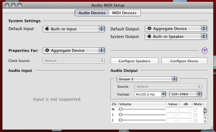

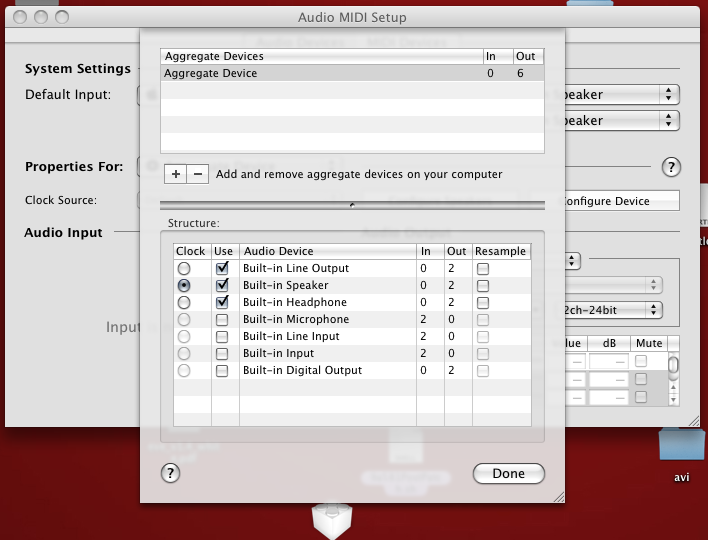

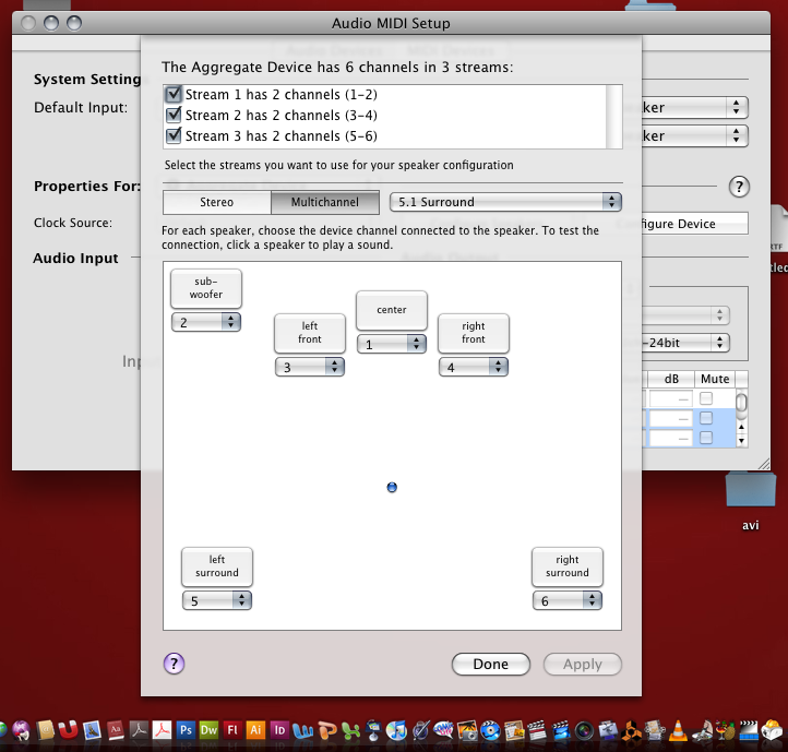

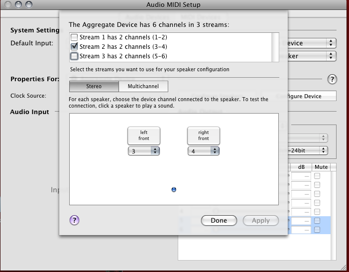

consolation Posted February 7, 2008 Share Posted February 7, 2008 and...I am wondering whether that poster got surround sound, or just front and back headphone output. Cause I went through the process and surround sound doesn't appear in system prefs. To set up surround sound on OSX requires the use Audio Midi Setup.app that should be in your utilities folder. In it, hit command-shift-a to open up aggregate device editor (or selected it from the menu). You need to create a new aggregate device then in the structure box assign all the outs to it. It doesn't matter if they are head phones etc, we will fix it up later. The annoying thing is; you may find out that sometimes an in socket may have become an out. Once you have an aggregate device, in the main Audio Midi Setup screen select it in the "Properties For" bob, hit configure speakers. Select Multichannel and 5.1 surround. The next bit is fairly self explanatory; if you click on the speaker button it will send some white noise to it - you assign which channel is being used with the bobs. Hopefully you end up with all your speakers working and assigned to correct channels. Click apply and done. Now Set the aggregate device as Default Output and voilá; multichannel sound. In an ideal universe.... YMMV. It works well with some equipment - less so with other. Personally, the best I managed was 4.1 with centre being sent to the rear speakers. Also, the keyboard volume control ceased to work (volume control in apps, eg. VLC, iTunes works fine). So, I'm running in stereo mode with a low pass filter for the sub. When I boot to windows for gaming I switch it off and set multichannel. AFAIK, this works a lot better with USB (eg HK's iSub) and digital outs than it does with analogue. P.S. After setting up multichannel, don't forget to set up the stereo sound as well. Otherwise you might find that music comes out of pretty odd speakers. ;-) Link to comment Share on other sites More sharing options...
consolation Posted February 7, 2008 Share Posted February 7, 2008 OK, my 4 month old decided that sleep is an optional extra so I had time to get 5.1 working - needed to assign headphone out as surround speakers. This is with an Altec-Lansig 5.1. Screenies attached for you edification and amusement. Link to comment Share on other sites More sharing options...

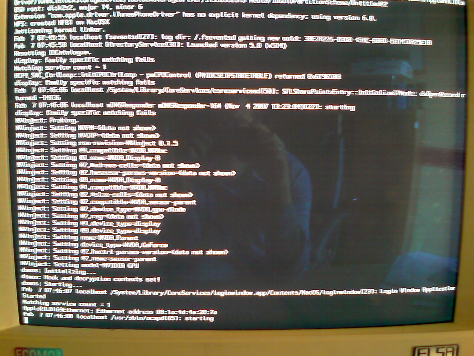

spotorno2008 Posted February 7, 2008 Share Posted February 7, 2008 Dear fellow enthusiasts, I have had to reinstall OSX86 on my system cause the other one crashed for reasons unknown. I admittedly used Kalyway to do so (seemed easier at first ), but it won´t boot, stays stuck as can be seen in the screenshot I´ve provided: I chose the following options: GUID EFI (320GB Samsung SATA-drive with only one partition formatted as such) Vanilla kernel both options NVinject (8800GT w/512MB) gen. audio driver no networking System specs: E4400 no OC 4GB PC800 NVIDIA 8800GT 512MB NEC 3520 DVD-Writer on PATA LG-8164B DVD-Rom on PATA TOSHIBA SHD-1638 DVD-ROM on SATA Samsung HD501LJ on SATA (Vista) Samsung 320GB on SATA (MACOSX86) Maxtor 3200 USB Device (500GB) Seagate ST3200822AS (200GB) on SATA Maxtor 6B160M0 (160GB) on SATA I haven´t toyed with the install in any other way, this was merely the result after the first install..... I´m at a loss as to why it won´t start up. Any good thought´s come to mind, anyone? Thanks for any input Link to comment Share on other sites More sharing options...
socal swimmer Posted February 7, 2008 Author Share Posted February 7, 2008 hm. Hers some things that come to mind: Unplug all those hard drives except your leopard one. Make sure you are in AHCI mode (in BIOS). See if it boots then. /usr/bin/ocspd is network stuff, so I don't know if this is what freezes.. consolation- thank you for that! When I get some more time (probly saturday) I will attack that. Do you have the same motherboard? On the back, there are 6 plugs. Which 3 did you get working? Link to comment Share on other sites More sharing options...
