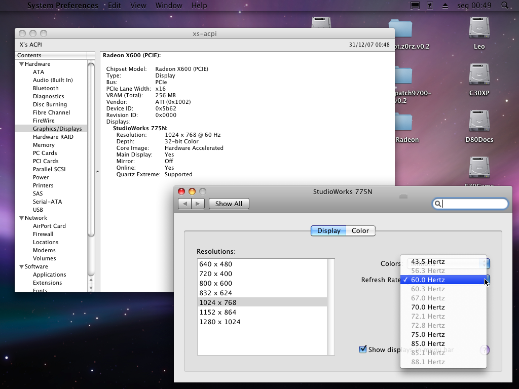

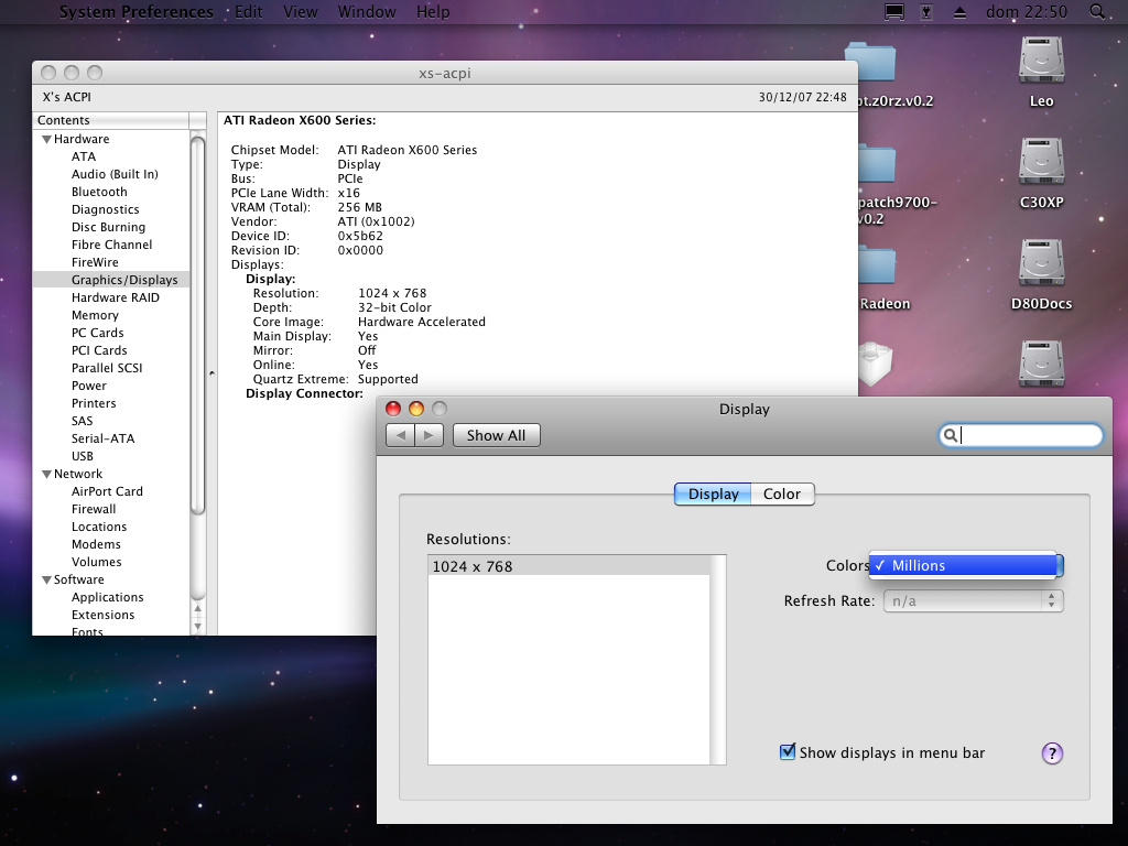

graphic Design Posted December 31, 2007 Share Posted December 31, 2007 ...i changed the following up till now: Callisto.kext/Contents/Info.plist - > Entry: " MONITOR_TYPE,EDID " changed to " CRT,EDID " NO QUOTE MARKS ( " ) [ if you use LCD then place it like: " LCD,EDID " ] WONDERFUL fact: I am being able to change Resolutions and Refresh Rates, as in windows !!! ... U find your EDID values by MonitorInfo app rite? How to disable EDID values on Callisto? Because my Monitor can display 85Hz on 1280 X 1024 but EDID values allows 75Hz display only! Link to comment https://www.insanelymac.com/forum/topic/70808-atiradeon9700-patch/page/9/#findComment-559050 Share on other sites More sharing options...
quow Posted December 31, 2007 Share Posted December 31, 2007 your problem is on retrieving the EDID values,for instance my LG Studioworks 77n was being detected as Cinema display1650 x 1080 ( i dont remember exactly ) but now its fine, so what changed,the EDID, some setting may lead the EDID detection to be wrong, note thata long time ago ( some months ) i was deep inside the problem of using programsto detect the real edid and all that jazz. but i did nothing of the kind this time,and since i started to use the ~ right ~ settings with callisto, the monitor has beendetected perfectly, both my 17'' and my compaq 15'', with out editing the EDID values...iam not certain yet which settings i change, but i am almost certain it has to do with callisto,,,since i`ve been changing so many things...thats the most cumbersome part in thi hackintosh world...to many variables, that need to many time to keep changing,then you reboot, then do this or that... things should b a little more plug and play...huaah:D98th reboot now!see you all in a sec.!;)whats the exacts errors you have with natit?because i am running with natit and atindrvCallistoFB set... MONITOR_TYPE set to CRT! Link to comment https://www.insanelymac.com/forum/topic/70808-atiradeon9700-patch/page/9/#findComment-559095 Share on other sites More sharing options...
graphic Design Posted December 31, 2007 Share Posted December 31, 2007 your problem is on retrieving the EDID values,for instance my LG Studioworks 77n was being detected as Cinema display1650 x 1080 ( i dont remember exactly ) but now its fine, so what changed,the EDID, some setting may lead the EDID detection to be wrong, note thata long time ago ( some months ) i was deep inside the problem of using programsto detect the real edid and all that jazz. but i did nothing of the kind this time,and since i started to use the ~ right ~ settings with callisto, the monitor has beendetected perfectly, both my 17'' and my compaq 15'', with out editing the EDID values...iam not certain yet which settings i change, but i am almost certain it has to do with callisto,,,since i`ve been changing so many things...thats the most cumbersome part in thi hackintosh world...to many variables, that need to many time to keep changing,then you reboot, then do this or that... things should b a little more plug and play...huaah:D98th reboot now!see you all in a sec.!;)whats the exacts errors you have with natit?because i am running with natit and atindrvCallistoFB set... MONITOR_TYPE set to CRT! With Natit.kext, I can't boot, it's always freeze at start up! But never mind because I thought Natit is for > X1000 cards only? Link to comment https://www.insanelymac.com/forum/topic/70808-atiradeon9700-patch/page/9/#findComment-559102 Share on other sites More sharing options...
