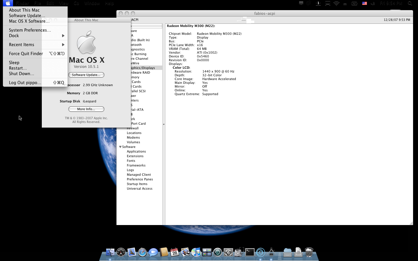

pippocal Posted December 28, 2007 Share Posted December 28, 2007 Eureka Now the patch work QE/CI enabled in leopard 10.5.1 with 2 problems : mouse tearing and black menu. The method is: 1. remove ATIRadeon9700.kext, ATIRadeon9700GA.plugin 2. install old 10.4.8 ATIRadeon9700.Kext and ATIRadeon9700GA.plugin 3. install callisto 4. use Koverg patch 5. modify ATIRadeon9700GLDriver.bundle (version 10.5.1): a. remove ATIRadeon9700GLDriver inside ATIRadeon9700GLDriver.bundle. The path is Contents/MacOS b. copy ATIRadeonX100GLDriver (version 10.5.1) in the directory where you have delete the ATIRadeon9700GLDriver and rename as ATIRadeon9700GLDriver ( the internal path is the same Contents/MacOS ) 6. remove ATINDRV.kext and copy Natit (Natit_ATIauto.kext.zip) 7. set the attribs in new files (meybe it's not important because afer you must repair a permissions) a. sudo chown -R root:wheel /System/Library/Extensions/file name b. sudo chmod -R 755 /System/Library/Extensions/file name 8. repair a permissions 9. reboot with -f parameter or delete Extensions.mkext Now we must correct the color of menu bar. I hope to be clear. Link to comment Share on other sites More sharing options...

Hyper X Posted December 28, 2007 Share Posted December 28, 2007 Eureka Now the patch work QE/CI enabled in leopard 10.5.1 with 2 problems : mouse tearing and black menu. The method is: 1. remove ATIRadeon9700.kext, ATIRadeon9700GA.plugin 2. install old 10.4.8 ATIRadeon9700.Kext and ATIRadeon9700GA.plugin 3. install callisto 4. use Koverg patch 5. modify ATIRadeon9700GLDriver.bundle (version 10.5.1): a. remove ATIRadeon9700GLDriver inside ATIRadeon9700GLDriver.bundle. The path is Contents/MacOS b. copy ATIRadeonX100GLDriver (version 10.5.1) in the directory where you have delete the ATIRadeon9700GLDriver and rename as ATIRadeon9700GLDriver ( the internal path is the same Contents/MacOS ) 6. remove ATINDRV.kext and copy Natit (Natit_ATIauto.kext.zip) 7. set the attribs in new files (meybe it's not important because afer you must repair a permissions) a. sudo chown -R root:wheel /System/Library/Extensions/file name b. sudo chmod -R 755 /System/Library/Extensions/file name 8. repair a permissions 9. reboot with -f parameter or delete Extensions.mkext Now we must correct the color of menu bar. I hope to be clear. What if we do all this but in step 5 put the 10.4.11 ATIRadeon9700GLDriver file inside the 10.5.1 kext? Link to comment Share on other sites More sharing options...

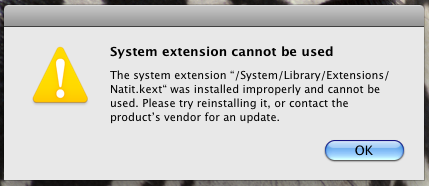

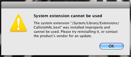

Goopnzaopleopz9 Posted December 29, 2007 Share Posted December 29, 2007 It's very clear!I make sure to follow your method (Without only step 4 because Koverg Patch has never worked for me!)After all the steps and restarting, the system gave me the messages about Natit.kext & CallistoHAL.kext installed not correct!(The Ati*.kexts which I used are the one I used to do with my Tiger to get QE&CI with no problem! ). [EDIT] The reason should be my VGA is AGP 8X while the others' one are PCI-ex ? Probably. My Mobility Radeon x600 has to be recognized as a PCIe. Link to comment Share on other sites More sharing options...

pippocal Posted December 29, 2007 Share Posted December 29, 2007 It's very clear!I make sure to follow your method (Without only step 4 because Koverg Patch has never worked for me!)After all the steps and restarting, the system gave me the messages about Natit.kext & CallistoHAL.kext installed not correct!(The Ati*.kexts which I used are the one I used to do with my Tiger to get QE&CI with no problem! ).[EDIT] The reason should be my VGA is AGP 8X while the others' one are PCI-ex ? Have you set the attribs? a. sudo chown -R root:wheel /System/Library/Extensions/file name b. sudo chmod -R 755 /System/Library/Extensions/file name with file name = Natit.Kext and CallistoHAL.kext and Callisto.kextand then repair a permission.If it doesn't work try to install AGPGart 3.0.3 for leopard.SorryI'll try more the driver install because yesterday evening all seem work. The information gave qe ci enabled and toast 8 was OK. But the all the video didn't go. Have you same ideas? Link to comment Share on other sites More sharing options...
graphic Design Posted December 29, 2007 Share Posted December 29, 2007 Have you set the attribs? a. sudo chown -R root:wheel /System/Library/Extensions/file name b. sudo chmod -R 755 /System/Library/Extensions/file name with file name = Natit.Kext and CallistoHAL.kext and Callisto.kextand then repair a permission.If it doesn't work try to install AGPGart 3.0.3 for leopard.SorryI'll try more the driver install because yesterday evening all seem work. The information gave qe ci enabled and toast 8 was OK. But the all the video didn't go. Have you same ideas? Yes, of course I did all nessesary codes for permission. Please see the attached pictures Link to comment Share on other sites More sharing options...
pippocal Posted December 29, 2007 Share Posted December 29, 2007 Yes, of course I did all nessesary codes for permission.Please see the attached pictures I don't Know what's happen in your OSX. Have delete ATINDRV.kext? It seems a permissions problem. In the picture below you''l find my status. Link to comment Share on other sites More sharing options...
Goopnzaopleopz9 Posted December 29, 2007 Share Posted December 29, 2007 I don't Know what's happen in your OSX. Have delete ATINDRV.kext? It seems a permissions problem. In the picture below you''l find my status. Great! Will you still be wanting my kexts? Link to comment Share on other sites More sharing options...

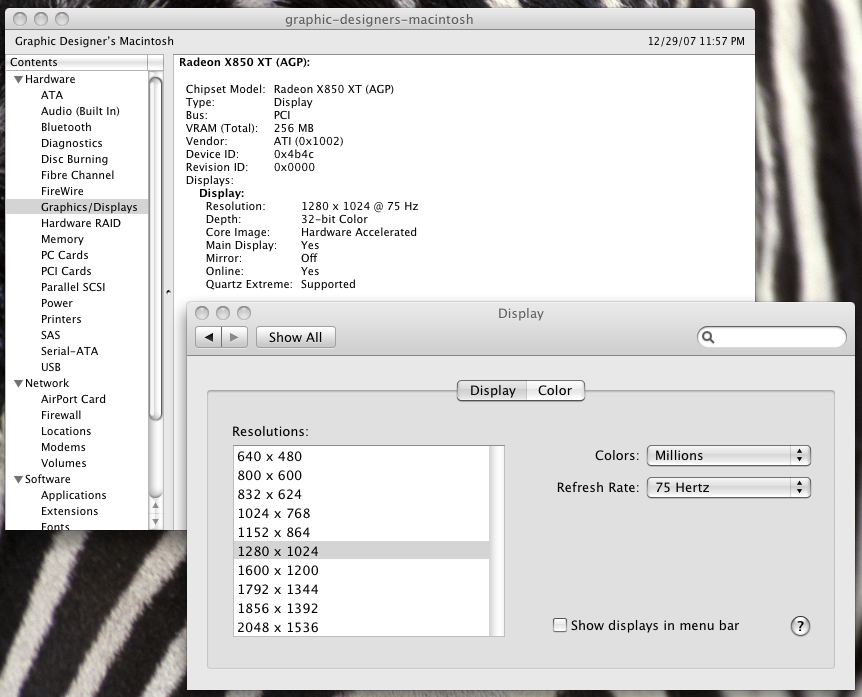

graphic Design Posted December 29, 2007 Share Posted December 29, 2007 YEAH!!!!!! I've GOT IT! Goopnzaopleopz9, thanks for your e-mail about Kext Helper b7 method! It works great! After install everything (without Natit.kext because It gave me the freeze at booting), here is my result: (please see the attached picture) But as someone mention, the video files can't be watched! What should We do then? Thanks for all helps, guys! Keep up this nice work!!!! Link to comment Share on other sites More sharing options...
