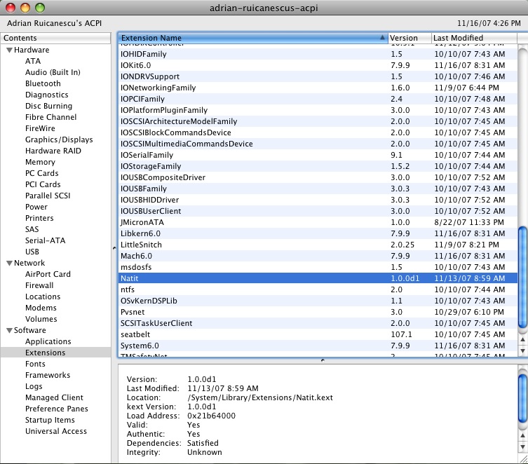

Flawless Oddity Posted November 16, 2007 Share Posted November 16, 2007 I updated Leopard today to 10.5.1, after I rebooted I wanted to make sure everything was loading fine. When went into System Profiler and looked at my Extensions I noticed this. If you notice, I have highlighted the 950kext, framebufferkext, and also for some reason it is loading the x3100kext. Does this mean something is calling on that kext to run or is it just a glitch, or could this be what is causing every one elses graphic mouse glitching? I still only get one resolution also. Link to comment https://www.insanelymac.com/forum/topic/70282-users-with-gma-950-x3100-real-macs-needed-here/page/5/#findComment-507726 Share on other sites More sharing options...

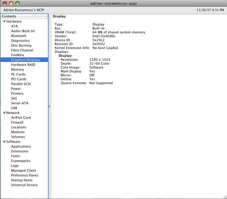

XanthraX Posted November 16, 2007 Share Posted November 16, 2007 Trying to force loading of the last Natit "kextload -t..." and Natit loaded, but no dependencies. Link to comment https://www.insanelymac.com/forum/topic/70282-users-with-gma-950-x3100-real-macs-needed-here/page/5/#findComment-508324 Share on other sites More sharing options...

Azurael Posted November 16, 2007 Share Posted November 16, 2007 Trying to force loading of the last Natit "kextload -t..." and Natit loaded, but no dependencies. Of course. Your device ID (G31 - 8086 29c2) isn't in it. Nobody has tried any of the G31/G33 GMAs yet. There isn't a driver explicitly to support them as Apple doesn't use them. You could try adding it to the GMA950 section of Natit's Info.plist and the same to the AppleIntelIntegratedFramebuffer/GMA950 kexts, it might work, since the GMAs in G31/G33 are really just clocked up GMA 950s - it might be that they won't work because Intel made some other changes though. It almost definitely won't work with the GMA X3100 kexts. The GMA X3000(G965)/X3100(GM965)/X3500(G35) is a completely different architecture to GMA 950(940/945G/M/L)/3000(G31)/3100(G33). Actually, perhaps this topic's title needs changing. It says GMA 3100, rather than X3100, for some reason... Link to comment https://www.insanelymac.com/forum/topic/70282-users-with-gma-950-x3100-real-macs-needed-here/page/5/#findComment-508457 Share on other sites More sharing options...
