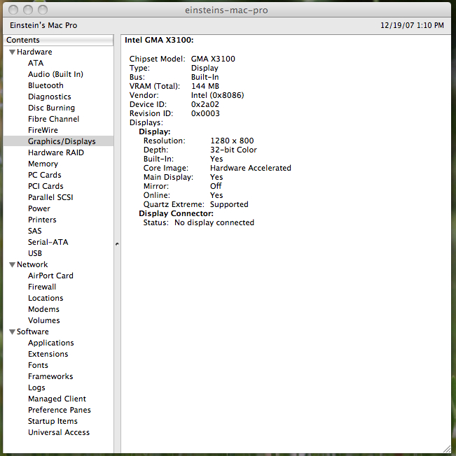

gr8mac7 Posted December 19, 2007 Share Posted December 19, 2007 Hello! This is my first post. I want to thank everyone for helping out the community. I've read all of this post here, and I had struggles getting the GMAX3100 to work for 1280x800. I had to use an External monitor to do this. However, I managed to get the resolution to work for my laptop system below using SwitchResX (not SwitchResXControl). I used the Vendor ID and Device ID from the "About this Mac Graphic/Display Profile". Using the program, SwitchResX, go to Setting of window bar and click on "Other unattached display", I entered the Vendor ID 8086 in the Vendor ID box and the Device ID 2a02 in the Product ID box and clicked "OK". Click Apply and enter your admin password and close program, may ask you to save, save it and asks for admin password again. Reboot computer and I got the 1280x800 resolution using the Internal screen with Core Image Hardware accelerated QE Supported. Here are the 3 graphic .kext files for the Acer Aspire 5920-6470. Here they are: GMAX3100_ASPIRE_5920.zip Pic : My System: Acer Aspire 5920-6470 Leopard 10.5.1 (working) Followed with some file structure on USB stick http://forum.insanelymac.com/index.php?sho...amp;mode=linear GMAX3100 video (working) Using SwitchResX Vendor ID 0x8086 Device ID 0x2a02 Internal Speakers (working) Mic (not working, but may have solution) Acer built in webcam (working) Sleep (not working yet, it just reverts back to normal after trying to Sleep the computer) *** Make sure you delete the AppleIntelIntegratedFramebuffer.kext while you are installing the 3 graphic kext files. Link to comment https://www.insanelymac.com/forum/topic/70282-users-with-gma-950-x3100-real-macs-needed-here/page/10/#findComment-543633 Share on other sites More sharing options...
ToshiPL Posted December 19, 2007 Share Posted December 19, 2007 @gr8mac7 Yessss! It works! Thank You Sir! I've made all steps on Toshiba A200-1MY (X3100) without external monitor. After restart i can see 1280x800. It is worth to add that I've filled up only vendor and device, no need to add frequences. It was worth not to go to sleep Toshiba A200-1-MY: T7250,965,X3100,Leo by ToH, EFI5.1 Link to comment https://www.insanelymac.com/forum/topic/70282-users-with-gma-950-x3100-real-macs-needed-here/page/10/#findComment-543782 Share on other sites More sharing options...
gr8mac7 Posted December 19, 2007 Share Posted December 19, 2007 ToshiPL You're welcome! Yes, that is correct, you don't need to enter the freq info. Just use the Vendor and Device IDs Enjoy, Gr8Mac7 Link to comment https://www.insanelymac.com/forum/topic/70282-users-with-gma-950-x3100-real-macs-needed-here/page/10/#findComment-543806 Share on other sites More sharing options...

errandwolfe Posted December 20, 2007 Share Posted December 20, 2007 Thank you Macgirl for the brilliant but yet should have been so obvious solution! Using Screen Sharing I have been able to log into my laptop with all the kexts loaded and no external display attached. The result is we now have some information. 1. Quartz Extreme and Core Image are being enabled. 2. I am able to change the resolution however even dropping down to 640x480 the LCD does not power on. 3. I can switch between color levels, however no selection powers on the LCD. 4. I am NOT able to change the refresh rate. I do not know if this is as a result of being logged in on screen sharing or not. Personally I am inclined to say if it will let me change the display resolution it would let me change the refresh rate. If someone with two working Macs can use screen sharing to test that it would be appreciated. I am now going to try using SwitchResX and see if that gets me anywhere. Here is my display page from System Profiler: Intel GMA X3100: Chipset Model: GMA X3100 Type: Display Bus: Built-In VRAM (Total): 144 MB Vendor: Intel (0x8086) Device ID: 0x2a02 Revision ID: 0x000c Displays: Display: Resolution: 1280 x 800 Depth: 32-bit Color Built-In: Yes Core Image: Hardware Accelerated Main Display: Yes Mirror: Off Online: Yes Quartz Extreme: Supported Display Connector: Status: No display connected Link to comment https://www.insanelymac.com/forum/topic/70282-users-with-gma-950-x3100-real-macs-needed-here/page/10/#findComment-544861 Share on other sites More sharing options...
errandwolfe Posted December 20, 2007 Share Posted December 20, 2007 Okay ladies and gents, I have good news and bad news.... How bout good news first.....I have been able to get the internal LCD working with full QE/CI and no external monitor. Bad news now...It had nothing to do with SwitchResX. Tried everything I could and did no good. Oh wait did I neglect to say there was some so-so news...I am not sure where exactly I read it, but another user had mentioned if your sleep your laptop when it comes back so does the display! So though it may be inconvenient, we do now have at least somewhat a working display. I will update this later with specific instructions of which kexts to install and what key commands to use to sleep your system. Just a warning ahead of time, I do believe you need to be using the graphics string in PCEFI to pull this off. I was not getting QE/CI without adding my device string. Link to comment https://www.insanelymac.com/forum/topic/70282-users-with-gma-950-x3100-real-macs-needed-here/page/10/#findComment-544900 Share on other sites More sharing options...
errandwolfe Posted December 20, 2007 Share Posted December 20, 2007 If you have a Dell or other laptop that the LCD simply powers off when loginwindow.app loads then this solution has a good chance of working for you: Prerequisites: 1. Another Mac running Leo 1a. If no Leo is available, a familiarity with VNC and another computer on which to run it. 2. Your laptop must be running the sleep kernel, you can not run the vanilla leo kernel 3. You must enable screen sharing on your laptop. If you don't have another Leo machine available, make sure you configure the VNC option 4. PC-EFI (I recommend version 8, you will need 7.2 or higher) Steps: 1. You must generate a hex string for your specific machine. This is a complex process and has been discussed earlier in this thread and others. I would suggest you visit Netkas' forums to find out more about this. It is possible that the generic dump from a Macbook with a GMA X3100 would work, I have not tested it. 2. Insert that hex string into your boot.plist file. Again, information about this can be found on Netkas' site. 3. Make sure you delete AppleIntegratedFramebuffer.kext 4. Download this file. In it you will find the generic AppleIntelGMAX3100 kexts, the version of Natit I am using, and a copy of my Boot.plist file. I would assume anyone with the same laptop as I could use this file with zero or little modification. 5. Install all the kexts, remembering to repair permissions. 6. Reboot 7. Once your hard drive stops spinning, hit your power button, hit tab, hit space. The computer should now be asleep. 8. Hit your power button to wake your laptop, and woo hoo, your display should be working. You will just need to repeat steps 7 and 8 after each time you power off or reboot. Good luck, and I hope this works for you. At least now we know for sure it is simply a power management issue. Link to comment https://www.insanelymac.com/forum/topic/70282-users-with-gma-950-x3100-real-macs-needed-here/page/10/#findComment-544955 Share on other sites More sharing options...

Jerris Posted December 21, 2007 Share Posted December 21, 2007 A few quick notes of my own. I was also able to get this solution working for my own notebook which is a Dell Vostro 1500 with the X3100 in it. I am not using PCEFI. I am using a stock [ToH] RC2 install with the X3100 tailored Nantit, and the 10.5.1 X3100 kexts (easily locatable in these forums). Since I cannot get my notebook to fall all the way asleep and then wake back up (she locks) I merely set my DISPLAY sleep timeout to be 1 minute. On the initial boot of my Dell I wait an addition minute after the screen goes blank then I bump the touchpad and the notebook screen comes to life. Woot! I was unnable to control the brightness of my notebook panel in the display preferences. That was an annoyance because the panel was WAY too bright. To correct this I went into my notebook's BIOS and set the default brightness level a few steps down. This worked great as well. I hope that helps a little! -Jer Link to comment https://www.insanelymac.com/forum/topic/70282-users-with-gma-950-x3100-real-macs-needed-here/page/10/#findComment-545279 Share on other sites More sharing options...

jim22 Posted December 22, 2007 Share Posted December 22, 2007 Excellent I now have a working display with CI & QE. Thanks for the work so far and the idea of sleeping the display. I have further developed this idea into a more workable solution, this will sleep and wake the display automatically at startup 1. Install SleepDisplay into Applications: http://www.macupdate.com/info.php/id/26234/sleep-display 2. Create the following script in script editor: tell application "SleepDisplay" to launch delay 1 tell application "System Events" to keystroke "`" using {command down} 3. Save it as an Application. 4. Add this application to startup items (System Prefs, Accounts, Login Items, + and add the app) 5. Reboot and enjoy. Does anyone know of a way I can launch this script at LoginWindow instead of after login? Link to comment https://www.insanelymac.com/forum/topic/70282-users-with-gma-950-x3100-real-macs-needed-here/page/10/#findComment-546809 Share on other sites More sharing options...
