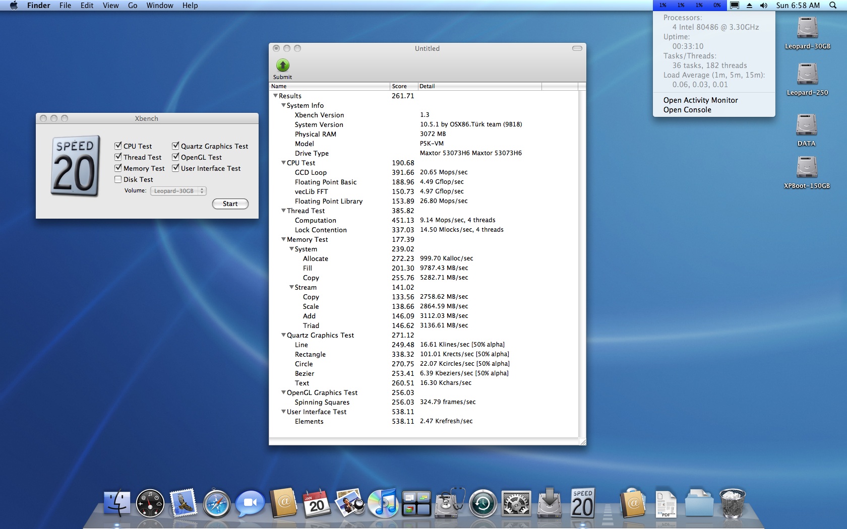

midnightdavid Posted January 18, 2008 Share Posted January 18, 2008 I am so close with my setup, but I still need a little help/advice - My P5K-VM is almost working 100%. I just need to figure out how to get the other 2 SATA ports to work. I'm pretty sure it should be possible. The kalyway DVD sees the drives connected there but iATKOS doesn't. My install was with iATKOS v1.0i - Leo 10.5.1; I believe I needed to add a few patches for the ATI HD 2600 Pro 512MB, gigabit ethernet and sound, but all is working great. Accelerated graphics are working beautifully. I have tried to do an install with the kalyway DVD - it seems to install normally but I get a kernel panic during the boot. No problem - I'm pretty happy with the iATKOS version but... I would really really like to get the other 2 SATA ports working. I probably just need to substitute a few of the appropriate KEXTs with the newer/modified ones from the kalyway DVD and I'd be all set. I checked under WinXP - the IDs for my ICH9 devices are 2921 and 2926. Seems pretty standard. But so far no joy when trying various KEXT suggestions I've found here in the forum. Any ideas? Anyone had success with all 4 SATA ports? Any thoughts on what to add & what to remove to get all 4 to function? Thanks, David P5K-VM w/Q6600; 3GB ram; ATI HD 2600 Pro 512MB; WD 250GB SATA; Link to comment https://www.insanelymac.com/forum/topic/62111-how-to-asus-p5k-vm-guide/page/5/#findComment-584875 Share on other sites More sharing options...
midnightdavid Posted January 19, 2008 Share Posted January 19, 2008 Status: Success with Leopard 10.5.1 ! I could get the Kalyway installation to boot with the -x option and all four SATA drives showed up (1-DVD burner/2-OS X 86 drive/3-Win XP drive/4-Vista drive), so I knew (hoped?) it was just a matter of copying the right KEXTs to the iATKOS installation. I ran an app to find differences between the two "System/Library/Extensions" folders (I used a free program called "DiffMerge") and tried to find differences in some of the SATA-related files that I have been reading about all day... These are the KEXTs I copied from my not-quite-functional Kalyway install to the iATKOS install. I believe they were: AppleAHCIPort.kext AppleLPC.kext IOACHIFamily.kext Unfortunately, this was done on top of various prior attempts to get the second set of SATA ports to work so I'm not certain this is all that is needed. I may have copied or edited a KEXT earlier today and forgotten. Or, it may be just the first two KEXTs that did the trick. In any event, I am very happy. I have a great mid-level mini-tower quad-core Mac Pro (something I hoped Apple would have announced and I would have ordered at Macworld on Tuesday). P5K-VM w/Q6600 OC'd a bit to 3.3ghz, Firewire & SATA ports working, Gigabit LAN working, Audio working, ATI HD 2600 Pro 512mb driving 2 monitors with CI/QE working. It is done! My thanks to everyone who helped solve the various problems with this motherboard over the past few months. - David Link to comment https://www.insanelymac.com/forum/topic/62111-how-to-asus-p5k-vm-guide/page/5/#findComment-585775 Share on other sites More sharing options...

midnightdavid Posted January 20, 2008 Share Posted January 20, 2008 A step by step series of instructions is coming - check back in a couple of hours. I just finished an installation on an old 30GB IDE drive I had in the closet (practically an antique. It was manufactured in Nov. 2000!) I believe it is all working (except for the power supply LED not always going off when I shutdown - weird, eh?) This setup gets an XBench v1.3 score of 261 when I turn off the Disk Test. It just didn't seem right to include the pathetic 7 year old drive in the test results... - David This installation required (this is what I already had, so this is what I used): the iATKOS v1.0i 10.5.1 DVD the Kalyway Leo 10.5.1 DVD - just for a few of its kexts for SATA and audio Gparted Live CD - to set the boot flag on the drive Kext Helper b7 - Delish has a link as a signature (see post 1 in this thread to download) Link to comment https://www.insanelymac.com/forum/topic/62111-how-to-asus-p5k-vm-guide/page/5/#findComment-586361 Share on other sites More sharing options...
aspirina750 Posted January 20, 2008 Share Posted January 20, 2008 Hey midnightdavid, one quick question, what cooler setup are you using? How´s the temperature at 3.3ghz? Thx Link to comment https://www.insanelymac.com/forum/topic/62111-how-to-asus-p5k-vm-guide/page/5/#findComment-586582 Share on other sites More sharing options...
midnightdavid Posted January 20, 2008 Share Posted January 20, 2008 For cooling I'm using something simple & not waaaaay oversized. the "Hyper TX 2" from CoolerMaster (it was what they had at CompUSA the day I decided that stock cooling probably wasn't good enough for my overclocking setup). When running a stress test like www.distributed.net's RC5-72 client crunching with all 4 cores the temps generally get to the high 60s c on all cores. System is very stable at this speed. BTW, I have 2x2GB 800 Mhz ram coming this week to replace the 3x1GB 667 ram that is currently in the system. Maybe the memory is the weak link in my setup. I'll find out soon if the faster memory makes much difference in speed & ability to overclock the system a bit more. The Install guide is almost done. I have run through a whole re-install one last time & then I'll post it. - David Link to comment https://www.insanelymac.com/forum/topic/62111-how-to-asus-p5k-vm-guide/page/5/#findComment-586710 Share on other sites More sharing options...
