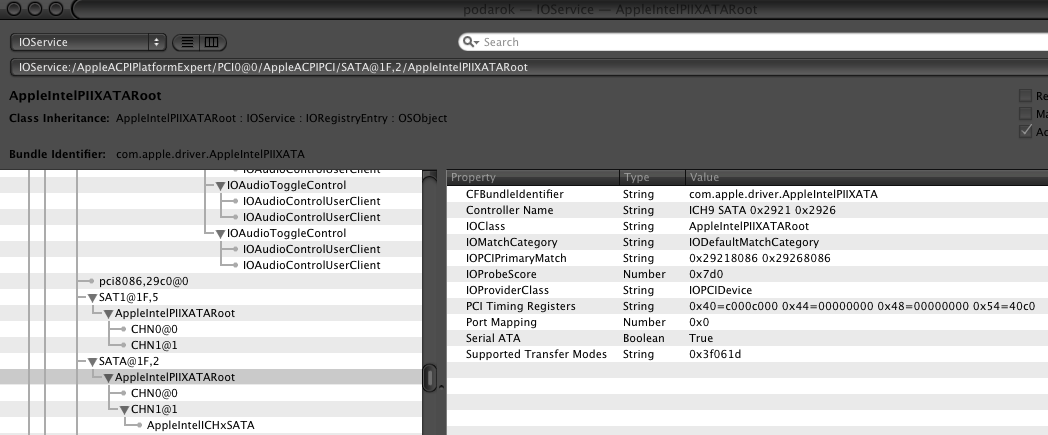

podarok Posted October 30, 2007 Share Posted October 30, 2007 Asus P5K-SE mb SATA in Enchaced mode (new bios without AHCI) ICH9 kext for multiple vendors (from http://www.freebsd.org/cgi/query-pr.cgi?pr=114473 ) 0x29208086 - ICH9R/DO/DH 0x29218086 - ICH9 0x29228086 - ICH9R/DO/DH 0x29238086 - ICH9 0x29258086 - ICH9R/DO 0x29268086 - ICH9 0x29288086 - ICH9M 0x29298086 - ICH9M 0x292c8086 - ICH9MR 0x292d8086 - ICH9M 0x292e8086 - ICH9M (If anyone have another pci ID`s - please send me and I`ll put it into patch) Known BUG - only first SATA channel working 8(.... It is on my P5K-SE Install - Remove Extensions.kextcache Remove Extensions.mkext Replace your AppleIntelPIIXATA.kext with AppleIntelPIIXATA.kext from attachement Fix system disk permisions using Disk Utility Reboot Enjoy and post bugs here Get it from my signature ************************************************************** If anyone know how to enable secondary SATA - help me I was trying to put some code from GenericATA kext like this <key>ATA Channel Count</key> <integer>2</integer> It is not working 8((( May be some docs for kext developing help us Link to comment https://www.insanelymac.com/forum/topic/62111-how-to-asus-p5k-vm-guide/page/2/#findComment-487226 Share on other sites More sharing options...
Allsop Posted October 30, 2007 Share Posted October 30, 2007 Thanks the kext worked like a charm, now I don't have to run in AHCI mode anymore! HD performance increased quite a lot! I now get 73Mb read/write sec, before it was about 70/60.... Both my DVD and HD was recognized correctly Is it possible to add support for NCQ? Link to comment https://www.insanelymac.com/forum/topic/62111-how-to-asus-p5k-vm-guide/page/2/#findComment-487395 Share on other sites More sharing options...
podarok Posted October 30, 2007 Share Posted October 30, 2007 2Allshop gm - i didn`t write my own driver - I only add ICH9 id`s to ICH8 driver so all functionality is from that driver 8(. May be NCQ functionality is in some other kext - so tell me and I`ll try to merge it into my patch... Link to comment https://www.insanelymac.com/forum/topic/62111-how-to-asus-p5k-vm-guide/page/2/#findComment-487924 Share on other sites More sharing options...
Allsop Posted October 30, 2007 Share Posted October 30, 2007 Ah ok didn't know, but it works great anyways. Link to comment https://www.insanelymac.com/forum/topic/62111-how-to-asus-p5k-vm-guide/page/2/#findComment-487989 Share on other sites More sharing options...
Allsop Posted October 31, 2007 Share Posted October 31, 2007 Patched the Official Leopard 9A581 GM extensions to support ICH9 using the same method as Podarok. Podaroks extension orginated from Tiger. The following files were patched: IOATAFamily.kext AppleIntelPIIXATA.kext No more AHCI and a fully working ICH9! ICH9_Leo.zip Link to comment https://www.insanelymac.com/forum/topic/62111-how-to-asus-p5k-vm-guide/page/2/#findComment-488151 Share on other sites More sharing options...

Maulwurfi Posted October 31, 2007 Share Posted October 31, 2007 Thanks a LOT podarok (and others). This is what I have done with my plain P5K and new BIOS (not the old AHCI one because I need to use WinXP as well, haven't been able to make it understand AHCI): 1) Using an internal SATA DVD drive I installed Uphuck 1.4iR3 to an external USB hard disk. I couldn't install to my main internal SATA disk because the installer disk didn't understand it correctly (because of no ICH9 support I guess?) My SATA HD was shown in the Disk Utility but it had wrong size and I couldn't do anything to it. 2) Installed some drivers such as tweaked Azalea for onboard sound and Radeon X1950 display driver. 3) Updated OS to 10.4.10 with PascalW. Okay, now comes the interesting part: I managed to get my otherwise nicely working external USB HD install to see my internal SATA disk properly after using Podarok's information here (I had to do the two lines Alsop mentions here to make the kext accepted). Now I can really see and manipulate the internal SATA HD properly boot after boot if I boot from the external HD. Now one problem remains: How do I move the working OSX from the external USB HD to the internal SATA HD? I tried Carbon Copy Cloner but it didn't work. Is it possibly to alter the Uphuck 1.4iR image so that it includes the Podarok's ICH9 driver? - so that it would be understood before I install the OS, then I could just install like I did before but directly to the internal SATA HD. I can live with booting from the external USB disk but I'd much rather just have it on the internal SATA for more speed and neatness. It does understand the ICH9 SATA now so it must be possible somehow, no? My goal is to have my main internal SATA HD as 2 partitions 1st OSX 2nd WinXP. (The reason for OSX on 1st is that I found that one of my commercial Mac programs only installs if the OS is on the first partition, strange eh.) BTW, Steve just got some of my money because I already bought some Mac software. Wouldn't have happened without Hackintosh ;-) Link to comment https://www.insanelymac.com/forum/topic/62111-how-to-asus-p5k-vm-guide/page/2/#findComment-489408 Share on other sites More sharing options...
delish Posted October 31, 2007 Author Share Posted October 31, 2007 You can read how to modify dvd kexts here my A8R32-MVP Deluxe about the P5K-VM ports, I found some more info SATA 1 root port 2940 (this is port 2) SATA 5 root port 2948 (this is port 3) SATA 6 root port 294a (this is port 4) Link to comment https://www.insanelymac.com/forum/topic/62111-how-to-asus-p5k-vm-guide/page/2/#findComment-489493 Share on other sites More sharing options...

Maulwurfi Posted November 1, 2007 Share Posted November 1, 2007 Okay, getting closer. I managed to make a clone of my working USB disk OS partition to the internal SATA partition. I found out that I can boot in safemode (-x) with the SATA partition. I managed to use the info that delish linked to include Podarok's AppleIntelPIIXATA.kext into the Extensions.mkext on the SATA partition. AND the next time I boot it goes perfectly even into normal nonsafe mode! The problem is, the next time after that it's again not working - waiting for root device at one point. There must be some little thing I am overlooking, because it works ONE time after the fix. I am a total Mac newbie so excuse my stupidity. Oh, and when I look at the -v info while booting it says at one point something like "skipping duplicate AppleIntelPIIXATA.kext extension with older/same". Does that give a clue? Xbench gave much nicer disk scores on SATA than on USB so I'd really like to get it to work. I didn't try patching the install DVD yet, I just kind of used that info to patch the installed OS... Link to comment https://www.insanelymac.com/forum/topic/62111-how-to-asus-p5k-vm-guide/page/2/#findComment-490858 Share on other sites More sharing options...
delish Posted November 1, 2007 Author Share Posted November 1, 2007 you were not supposed to install both the files Allsop posted AppleIntelPIIXATA.kext is only supposed to be inside here /System/Library/Extensions/IOATAFamily.kext/Contents/PlugIns/ Link to comment https://www.insanelymac.com/forum/topic/62111-how-to-asus-p5k-vm-guide/page/2/#findComment-490930 Share on other sites More sharing options...
Maulwurfi Posted November 2, 2007 Share Posted November 2, 2007 Hmm, I only installed AppleIntelPIIXATA.kext but I think I installed it inside /System/Library/Extensions How do I install it inside /System/Library/Extensions/IOATAFamily.kext/Contents/PlugIns/ I can't see that folder directly, on the desktop, right? EDIT: Gonna try tonight again, and try out your kexthelper as well! Link to comment https://www.insanelymac.com/forum/topic/62111-how-to-asus-p5k-vm-guide/page/2/#findComment-491286 Share on other sites More sharing options...
Maulwurfi Posted November 2, 2007 Share Posted November 2, 2007 OKAY! I used Kext Helper and edited the script so that it didn't install the AppleIntelPIIXATA.kext inside /System/Library/Extensions but deeper into /System/Library/Extensions/IOATAFamily.kext/Contents/PlugIns/ Now I get no more "skipping duplicate" thing at startup and it worked for 2 consecutive boots! I think it's working now. THANK YOU Podarok and Delish. This is getting really nice. I also bought an USB wlan card for 20 euros that has Mac drivers so network is working as well. NICE Link to comment https://www.insanelymac.com/forum/topic/62111-how-to-asus-p5k-vm-guide/page/2/#findComment-491819 Share on other sites More sharing options...

Allsop Posted November 3, 2007 Share Posted November 3, 2007 Elbasofolous: If you have the AppleAzaliaAudio.kext in extensions you need to delete that file...The kext works, used it in 3 other P5K-VM setups Those of you having problem with my Leo IOATAFamily.kext probably don't have the same dev id's as I do... anyway I've ripped the same kext from ToH's RC2 Leo DVD and I think it supports more ICH9 boards...IOATAFamily.kext.zip Link to comment https://www.insanelymac.com/forum/topic/62111-how-to-asus-p5k-vm-guide/page/2/#findComment-492754 Share on other sites More sharing options...
podarok Posted November 3, 2007 Share Posted November 3, 2007 You can read how to modify dvd kexts here my A8R32-MVP Deluxeabout the P5K-VM ports, I found some more infoSATA 1 root port 2940 (this is port 2)SATA 5 root port 2948 (this is port 3)SATA 6 root port 294a (this is port 4)OK thanx!I`ll add that ID`s into next version kextto allI think that our problem is inPCS port map = 92019301 92029302 92049304 92089308 in AppleIntelPIIXATA.kextI think that it is the 4 port config but our MB`s has 6 or even 8 SATA ports so....If I kill it - no one port couldn't be detected even on right(working) portIn IORegistry Explorer (attachement) I showign U view without PCS port map I can't found any documentation in Xcode development repository (and apple.com quiet too 8))) )May be someone can help me to find possible "PCS port map" values Link to comment https://www.insanelymac.com/forum/topic/62111-how-to-asus-p5k-vm-guide/page/2/#findComment-493223 Share on other sites More sharing options...
