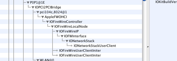

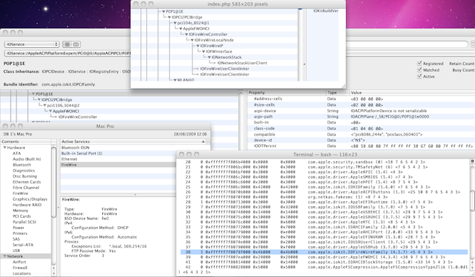

DB1 Posted August 28, 2009 Share Posted August 28, 2009 The firewire device should look like this on the IOREG tree: Heres what IOREG shows for mine. BlackCH - Are the other lines in your Firewire IOREG created by the device/s you have connected to the firewire port? Link to comment https://www.insanelymac.com/forum/topic/62111-how-to-asus-p5k-vm-guide/page/20/#findComment-1239083 Share on other sites More sharing options...
zikman Posted August 28, 2009 Share Posted August 28, 2009 After many many tests....(with the same dsdt file) PC_EFI 10.x + FAKESMC.KEXT -----> Firewire is not runinng! PC_EFI 10.x + DSMOS.KEXT -----> Firewire is up and running! To check if the firewire is actually up and running you have to see at the profiler: 1)Firewire devices 2)If the network section displays a firewire device then it has to report also its mac adress..If not then it is not actually running If your restart doesnt work then you have to put the OpenHaltRestart.kext is S/L/E and NOT in E/E ! By the way.... I have a RTL8139 PCI card.... The card is identified by snow Leopard only with PC_EFI 9.0 and not with 10.x but its doesnt perform good ...(I mean it performs like a dial up modem) Link to comment https://www.insanelymac.com/forum/topic/62111-how-to-asus-p5k-vm-guide/page/20/#findComment-1239350 Share on other sites More sharing options...

BlackCH Posted August 29, 2009 Share Posted August 29, 2009 Heres what IOREG shows for mine. BlackCH - Are the other lines in your Firewire IOREG created by the device/s you have connected to the firewire port? No devices connected to the firewire. When my onboard firewire looks like yours (without the extra lines) it doesnt work; this happens when I let the AppleHPET.kext (and CPUPM) to load. So I use a PCI card to stay as much vanilla as I can (HPET and CPUPM loaded) Link to comment https://www.insanelymac.com/forum/topic/62111-how-to-asus-p5k-vm-guide/page/20/#findComment-1240378 Share on other sites More sharing options...
