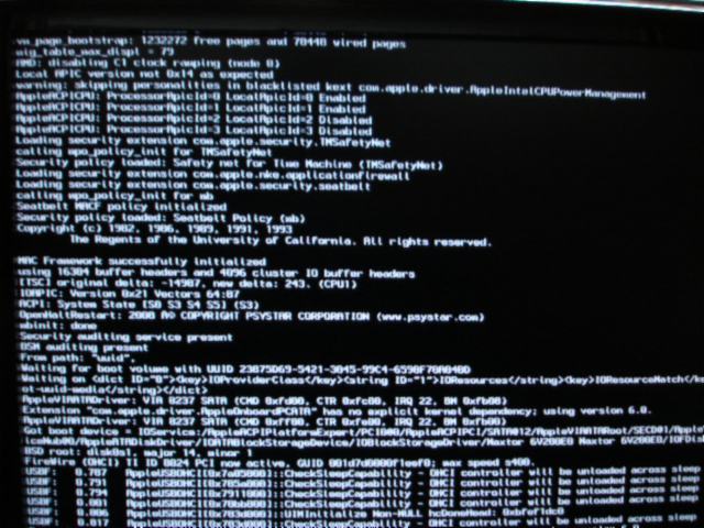

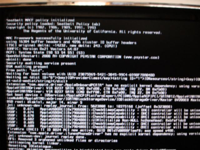

CPT_MAC Posted February 15, 2009 Share Posted February 15, 2009 Same topic are posted in post-installation with same more pic's. maybe this have been the better place to post. Sleep / wake up problem in generally Looking for your opinion / advice GA-MA69GM-S2H Hi Folks, Got everything, I can think about working, except wake up after sleep. Out of practice testing OS X on different hardware I recognized all boards with sleep wake up problems showing during boot USBF: X.XXX ApleUSBDHCI (0x…..) : : CheckSleepCapabillity – DHCI controller will be unloaded across sleep. You can see on picture Boot3 and 3a. Important Pic’s are 3 and 3a This message cams up even when booting from DVD before installing OS X. My guess or opinion is: The problem arises very early and has nothing to do which kernel, distro etc. you are using. Is here someone who can confirm my thought, or have any idée what I can do next. My Hardware is: AMD x2 5200 Mhz, 5 GB ram, Gigabyte GA-MA69MA-S2H board, ATI 2600 pro 512 MB. Again, I am using the IPC 10.5.6 ppf5 distro and I am very happy with dual screen and all other features. The sleep / wake up problem are also with other distro’s like Leo4all etc. For me sleep / wake up function are very important. Computer is on 24/7 and the difference between Sleep and no sleep is about 125 watts per hour power consumption. Please don’t tell me to change the motherboard into Intel board. This would be my last option if I am not getting wake up to work. Thanks, for your reply. Link to comment Share on other sites More sharing options...
CPT_MAC Posted February 22, 2009 Share Posted February 22, 2009 H E L L O please, is no one here who may have observed thach message during boot (-V) verbose mode and having or not, wake up problems. Before I go any further I would like to know if this caused my wake up probs. Here again the message. USBF: X.XXX ApleUSBOHCI (0x…..) : : CheckSleepCapabillity – OHCI controller will be unloaded across sleep. Thanks Link to comment Share on other sites More sharing options...
