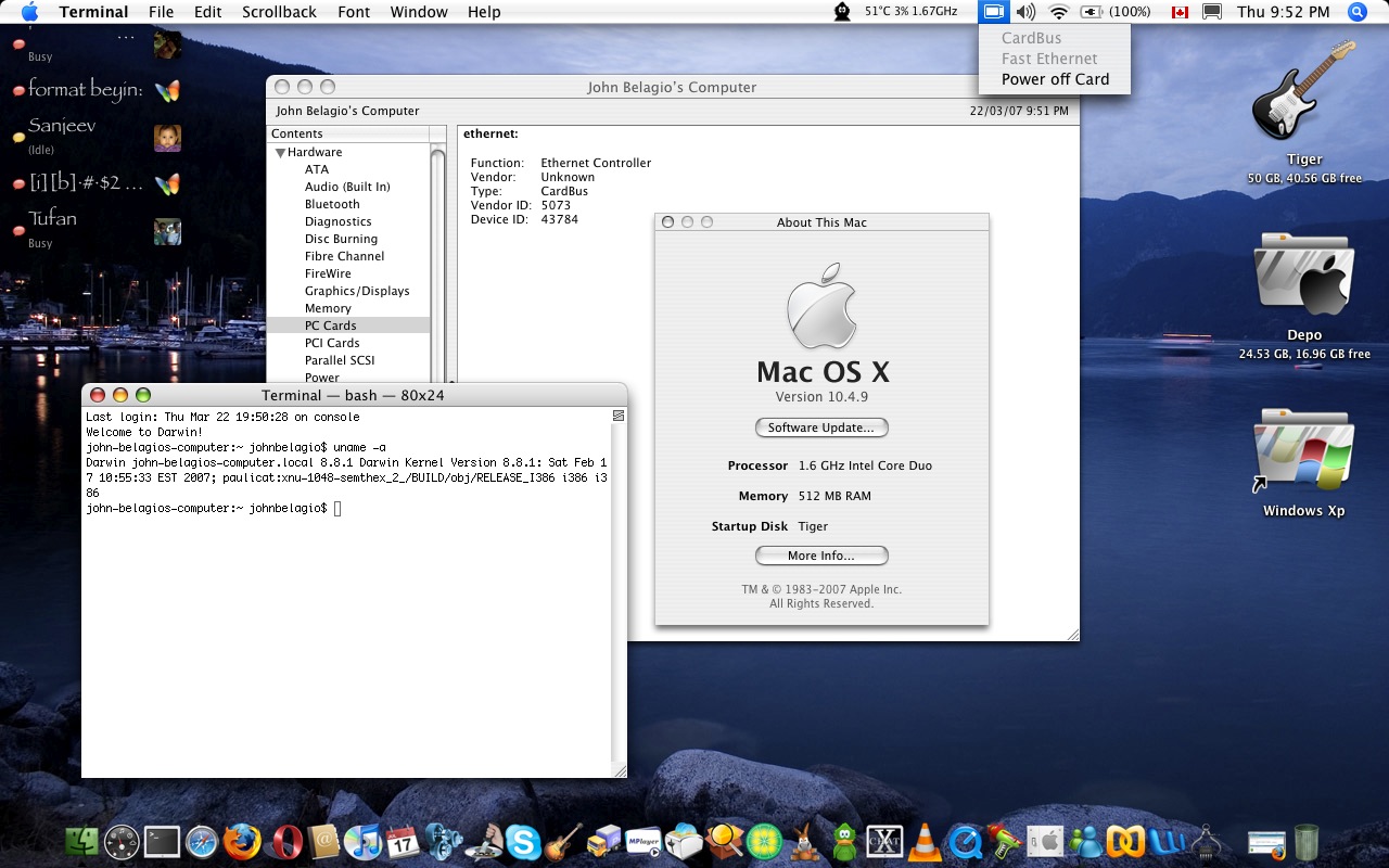

mobile2go Posted March 22, 2007 Share Posted March 22, 2007 I can confirm that Hibernation works with the 8.4.1 kernel What did you do to get your PCMCIA slot working? I have a Aspire 5610z with a ENE Tech card bus and I can't find anything anywhere on this forum to get it to work. Link to comment https://www.insanelymac.com/forum/topic/44283-no-wake-from-sleep-discussion-fixes-thread/page/4/#findComment-329920 Share on other sites More sharing options...
Eskurza Posted March 22, 2007 Share Posted March 22, 2007 I have a Aspire 5610z with a ENE Tech card bus and I can't find anything anywhere on this forum to get it to work. Use the attached kexts, drop them to your Extensions folder.. chown, chmod.. reboot Extensions.zip Link to comment https://www.insanelymac.com/forum/topic/44283-no-wake-from-sleep-discussion-fixes-thread/page/4/#findComment-329970 Share on other sites More sharing options...

mobile2go Posted March 22, 2007 Share Posted March 22, 2007 I have a Aspire 5610z with a ENE Tech card bus and I can't find anything anywhere on this forum to get it to work.Use the attached kexts, drop them to your Extensions folder.. chown, chmod.. reboot Extensions.zip Thanks for the file but it didn't work, I copied and chmod and repaired permissions and deleted the kext cache and all it did was crash my perfectly running (other than pcmcia) system with kernel panics so I had to reinstall and start all over again. Link to comment https://www.insanelymac.com/forum/topic/44283-no-wake-from-sleep-discussion-fixes-thread/page/4/#findComment-330161 Share on other sites More sharing options...

mobile2go Posted March 23, 2007 Share Posted March 23, 2007 Sorry to hear that bro.. U could have just deleted them in single user mode though Hi, What is the device id of your adapter.. I am pretty sure it is the same adapter though.. which version are you running? which kernel? This is what I got from windows, it's ENE CB 712/714/810 Cardbus 1524 DEV_1412 Thanks! Link to comment https://www.insanelymac.com/forum/topic/44283-no-wake-from-sleep-discussion-fixes-thread/page/4/#findComment-330433 Share on other sites More sharing options...

mobile2go Posted March 23, 2007 Share Posted March 23, 2007 I have the exact same cardbus ENE 712/714/810. I will give your extensions a shot. I'm using the latest Jas 10.4.8 Intel Amd with darwin 8.8.1 kernel. Link to comment https://www.insanelymac.com/forum/topic/44283-no-wake-from-sleep-discussion-fixes-thread/page/4/#findComment-330676 Share on other sites More sharing options...
mobile2go Posted March 24, 2007 Share Posted March 24, 2007 I have the exact same cardbus ENE 712/714/810. I will give your extensions a shot. Hi, Do you have any suggestions on how to get my card bus working? I tried it again and this time I booted back up without errors but I lost my airport so I replaced the kext with my originals rebooted and my airport came back. I'm puzzeled, also I'm using the latest Jas 10.4.8 Intel Amd with darwin 8.8.1 kernel. Link to comment https://www.insanelymac.com/forum/topic/44283-no-wake-from-sleep-discussion-fixes-thread/page/4/#findComment-331011 Share on other sites More sharing options...
