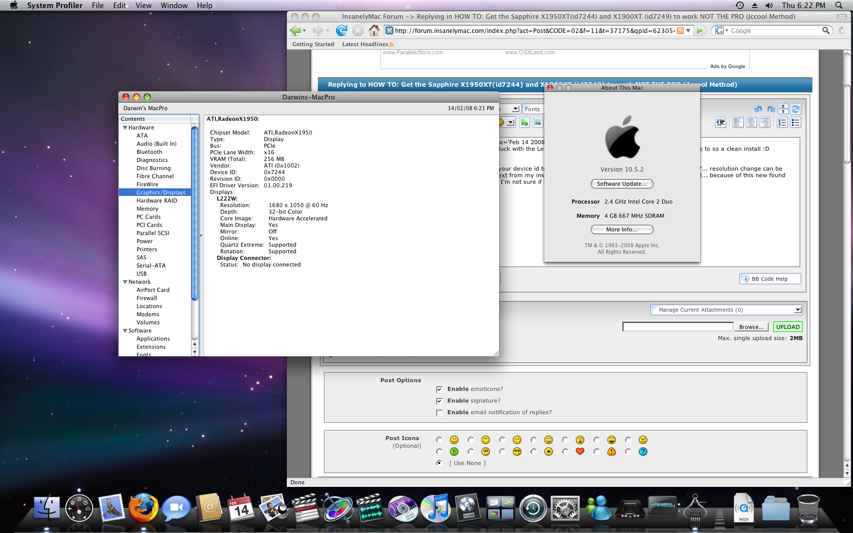

ddrdark: that's exactly what happened to me, when I updated to 10.5.2 :(. That's why I'm doing a fresh installation, and trying to use X1950XT with EFI support.
So far, I've mannaged to get the full hardware support through EFI, with Quarz Extreme, and without any driver installer. I've only made changes in 'ATIRadeonX1000.kext' file - I've added my DEVICEID number (0x72441002) to the rest of them.
Now it's time to update to 10.5.2. Crossing my fingers.
ps: I'll post the HEX file for EFI support for the X1950XT, when I'll make sure it works in 10.5.2.
Thanks a lot chipxsd, I've VGA-strings working too... well with 10.5.1 works nice, but with 10.5.2... I think that EFI strings only give support for resolution change, by the way I never added any device Id to atiraedon1000.kext :)
thanks anyway! hope you can fix it ^_^
Another success story! Mine also works perfectly. I included my com.apple.boot.plist file, so X1950XT users can get their GPUs working natively in 10.5.2.
