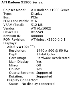

I was having troubles getting my 1900GT (rev2!!) to work so I bought a 1900XT. That worked perfectly, i got full hardware support. Now i wanted to get te stupid 1900GT to work to, since its an almost identical card. Yesterday i got it working. It's very easy too.
Here is how I got my 1900GT to work on 10.5.2:
-put 1900GT beside HD3870 on windows machine in 2nd vga-slot
-boot windows
-run ATIwinflash and make sure you save the bios off the 1900GT
-start Rabit 2.1 and modify the bios to device id 7249 instead of the original 724b
-you can also edit the bios for higher clocks while your at it
-flash the bios into your card, the card needs to be a second card or it won't work
-once the device id has changed OSX will work fine on this card
NOTE: as far as I know you can only mod a rev2 card's devide id!!!
So I say, try this, if it works for you too please edit it into the hardware compatibilty list! :)

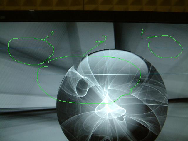

I update 10.5.2 and install "x1950xt 10.5.2 efi-vga installer 0.1 p35...." jccool method my but my hackintosh locked sometimes when I start xbench (on testing openGL).
And I always see "lines" at the monitor see at below when using normaly:
