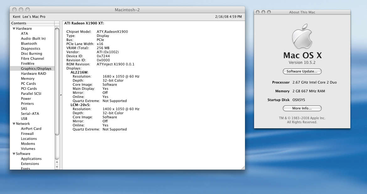

Lone Wolf Posted February 16, 2008 Share Posted February 16, 2008 Another success story! Mine also works perfectly. I included my com.apple.boot.plist file, so X1950XT users can get their GPUs working natively in 10.5.2.Again, this is only for the Saphire X1950XT id7244 graphic cards (256Mb). Another thing, I'd like to add ... I found this on forum.netkas.org. ps: delete the .txt extension of the attached file. pps: I just figured out, it was you DDrDark, who posted the thing I quoted from the netkas forum I Hope you don't mind. Ok, I tried your method, but I failded I had a perfect working 10.5.1 system + JCCool drivers, then I updated to 10.5.2 and everything was fine. Finally I update the graphic package, and I didn't have QE anymore (resolution still works). then I tried to follow your methods, but I'm not sure I did everything correctly: 1. I added in the Boot.plist the long EFI string, I tried both with 1 and 0 (with my mobo, I think this is the correct one) 2. I opened the Info.plist of ATIRadeonX1000.kext and added the ID under <key>IOPCIMatch</key>, where I found other similar strings Is this correct? Should I need other kext? Thanks in advance for any help! Link to comment https://www.insanelymac.com/forum/topic/37175-how-to-get-the-sapphire-x1950xtid7244-and-x1900xt-id7249-to-work-not-the-pro-jccool-method/page/24/#findComment-627071 Share on other sites More sharing options...
jccool Posted February 16, 2008 Author Share Posted February 16, 2008 @Lone Wolf, Hi, From what your saying, after 5.2 gfx update you still had res change, which means you still had my modded natit kext. Make sure if you are using pc efi for res change that you completly rid of Natit.kext, if your not using pc efi for res change, leave natit in there. To check if your pc efi vga is working, under graphics in system profiler check for efi driver, if that is writen there, your using it right, if not, try to fix it. As for QE/CI to ensure functionality, copy atix1000 to your desktop then edit the plist. then install with kexthelper b7... then reboot, Good Luck, Jccool Link to comment https://www.insanelymac.com/forum/topic/37175-how-to-get-the-sapphire-x1950xtid7244-and-x1900xt-id7249-to-work-not-the-pro-jccool-method/page/24/#findComment-627079 Share on other sites More sharing options...
Lone Wolf Posted February 16, 2008 Share Posted February 16, 2008 @Lone Wolf, Hi, From what your saying, after 5.2 gfx update you still had res change, which means you still had my modded natit kext. Make sure if you are using pc efi for res change that you completly rid of Natit.kext, if your not using pc efi for res change, leave natit in there. To check if your pc efi vga is working, under graphics in system profiler check for efi driver, if that is writen there, your using it right, if not, try to fix it. As for QE/CI to ensure functionality, copy atix1000 to your desktop then edit the plist. then install with kexthelper b7... then reboot, Good Luck, Jccool Well, my System Profiler is identical to yours, apart CI (Software) and QE (Not Supported), so I presume I'm using the EFI driver (same version you have). Obviously, if the Apple updates didn't change the Natit.kext, I', still using yours So probably this is the problem... When you say "completly rid of Natit.kext" you mean I have to remove it (together with Extensions.mkext I guess) or to install the one provided by Netkas (or Apple)? Sorry if this is a n00b question, but I still have to understand which extensions are modified and which not Link to comment https://www.insanelymac.com/forum/topic/37175-how-to-get-the-sapphire-x1950xtid7244-and-x1900xt-id7249-to-work-not-the-pro-jccool-method/page/24/#findComment-627123 Share on other sites More sharing options...
Lone Wolf Posted February 16, 2008 Share Posted February 16, 2008 Great, I did it! Removing Natit.kext was enough. In the end, it wasn't so difficult Link to comment https://www.insanelymac.com/forum/topic/37175-how-to-get-the-sapphire-x1950xtid7244-and-x1900xt-id7249-to-work-not-the-pro-jccool-method/page/24/#findComment-627331 Share on other sites More sharing options...

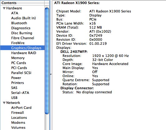

demonicbunny Posted February 18, 2008 Share Posted February 18, 2008 Not sure if anyway would be interested but I've generated EFI strings for X1900XT running on my Gigabyte GA-P35C-DS3R If my understanding is correct you shouldn't need to amend the ATIRadeonX1000.kext as the card is already supported. My card has a Device ID of 0x7249. Quite simply you should only need to remove the injector you're using, add the hex string to your com.apple.boot.plist and rebuild your KEXT cache. Once your reboot you should see the card in the System Profiler listed like the screenshot i've attached. I've also attached the HEX string that worked for me. I created this string using gfxutil and the instructions on the NETKAS forum. On a side note, i've also created an EFI string for my onboard sound (ALC889a), if anyone is interested. Regards 1900.hex.txt Link to comment https://www.insanelymac.com/forum/topic/37175-how-to-get-the-sapphire-x1950xtid7244-and-x1900xt-id7249-to-work-not-the-pro-jccool-method/page/24/#findComment-630954 Share on other sites More sharing options...
