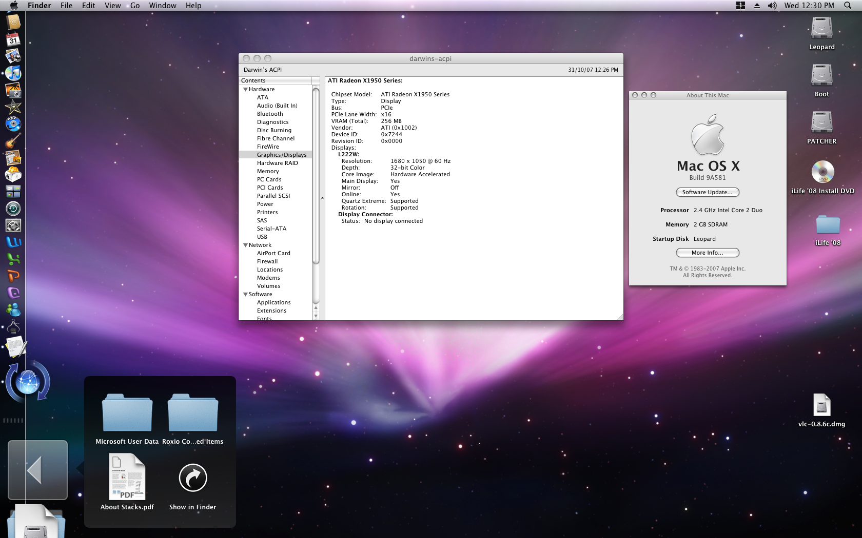

Below is what mine looks like @ 1680x1050 on 10.5 9a581 GM

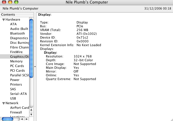

Yeah i do remember having full resolution options once (I think 10.4.7 or 10.4.6 I still have 10.4.7 dvd so could confirm if needed....) without blur, how would i go about getting the ID for you???
ID is 0x71c2
I have 10.4.7 JAS AMD/Intel, 10.4.8 AMD SSE3 Combo Update, 10.4.8 AMD TEST and current installation is a clean 10.4.8 AMD FINAL install
I'm more than happy and willing to test out any drivers although i will confess i don't really understand all the terminal commands etc still a n00bie with macs and linux :P however with direction we all learn in the end :)
feel free to contact me using WLM/MSN messenger or email or skype or PM or whatever, I'm a pretty open and reachable guy :P

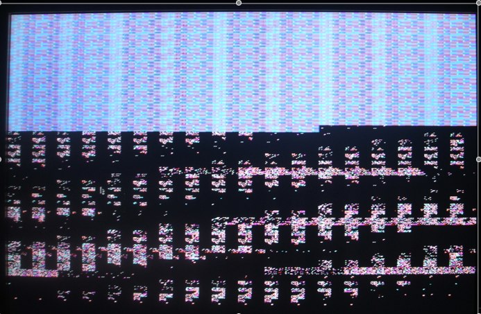

Boris Installer resulted in this :)
managed to use uninstall script again to return to 'normal' :D
I didn't thoroughly read your problem descriptions, but the BLUR really catch me.
In my experience, blur will occur if we use bad quality (cheap one) vga splitter (one monitor for two PC). Do you use it??

Hello,
wow, that screenshot is really shfouked up! well i sent you a pm on how to get your device id, once you gimme that, ill do the same as i did on mine and give you directions for terminal,
