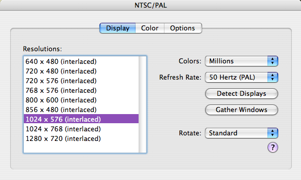

delish Posted July 9, 2007 Share Posted July 9, 2007 Apple's DVI-PAL/NTSC adapter works for TV out options are "overscan" and "best for video" Link to comment https://www.insanelymac.com/forum/topic/37175-how-to-get-the-sapphire-x1950xtid7244-and-x1900xt-id7249-to-work-not-the-pro-jccool-method/page/13/#findComment-404604 Share on other sites More sharing options...
jnolla Posted July 9, 2007 Share Posted July 9, 2007 Apple's DVI-PAL/NTSC adapter works for TV outoptions are "overscan" and "best for video" That means I would have to give up one of my LCD's out of the two, so I can use my Sony Broadcast monitor. The idea here is to be able to host two DVI-D LCD's, and have the video be the 3rd connector (VIVO), to monitor color changes while in FCP 6. I want to gain the video out port accessible in this card. Link to comment https://www.insanelymac.com/forum/topic/37175-how-to-get-the-sapphire-x1950xtid7244-and-x1900xt-id7249-to-work-not-the-pro-jccool-method/page/13/#findComment-404609 Share on other sites More sharing options...
delish Posted July 9, 2007 Share Posted July 9, 2007 x19X0 cards are dualhead only afaik so even if you get TV-Out/HDTV port to work you will still only get 1 DVI + TV-Out/HDTV. In windows I have to disable one monitor to be able to activate TV-Out. I have also tried to get a tripple setup to work, but so far getting a second gfx-card to work haven't been successful, I have tried with a old Mac edition radeon 7000 PCI flashed to PC rom, but only the card I select to post in BIOS work, the other doesn't initialize/load drivers. Link to comment https://www.insanelymac.com/forum/topic/37175-how-to-get-the-sapphire-x1950xtid7244-and-x1900xt-id7249-to-work-not-the-pro-jccool-method/page/13/#findComment-404625 Share on other sites More sharing options...
