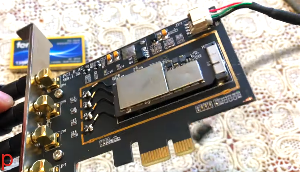

floodlitworld Posted January 17 Share Posted January 17 I've been following this project for a few months now, and it's seriously impressive. I have a Fenvi-T919 with a BCM_20702B0 chipset. Will this ever be within the scope of this project, or is it not possible to support this chipset using this method? 1 Link to comment https://www.insanelymac.com/forum/topic/361710-broadcom-fullmac-wi-fi-support-on-macos-sonoma-sequoia-and-tahoe-without-root-patches/page/15/#findComment-2846524 Share on other sites More sharing options...
schrup21 Posted January 17 Share Posted January 17 3 hours ago, floodlitworld said: Fenvi-T919 with a BCM_20702B0 This is the Bluetooth chip of the BCM94360CD module on the Fenvi. Unfortunately, there is no Fullmac firmware for it – it is not supported. The module should be replaceable with a BCM943602CDP; both should have the same antenna connectors. Fenvi T919 Spoiler 3 Link to comment https://www.insanelymac.com/forum/topic/361710-broadcom-fullmac-wi-fi-support-on-macos-sonoma-sequoia-and-tahoe-without-root-patches/page/15/#findComment-2846526 Share on other sites More sharing options...

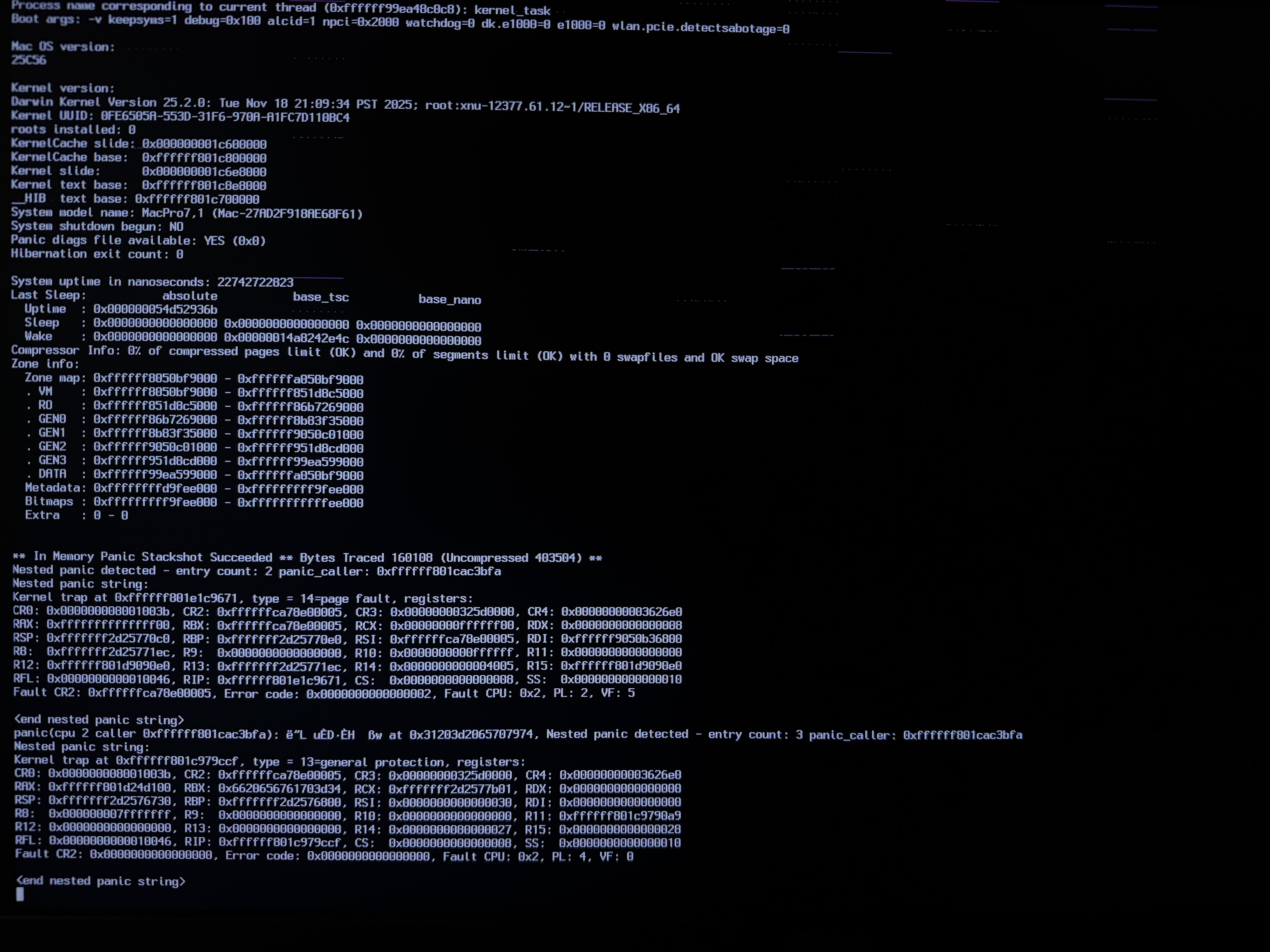

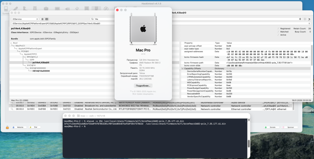

NEOSoftWare Posted January 19 Share Posted January 19 Unable to boot the system: - Module BCM943602CS (0x14E4, 0x43BA) - BIOS Vt-d - disable - DisableIoMapper - true, DisableIoMapperMapping - true - File loaded: /usr/local/share/firmware/wifi/brcmfmac43602-pcie_7.35.177.61.bin - Device path: PciRoot(0x0)/Pci(0x1C,0x2)/Pci(0x0,0x0) - Properties set: bcmc-firmware-hash and bcmc-firmware-path When enabling the AppleBCMWLANCompanion.kext kext, I get a kernel panic Spoiler Third-party modules like iOSkywalkFamily.kext, AirportBrcmFixup.kext, IO80211FamilyLegacy.kext, etc. are missing. Without AppleBCMWLANCompanion.kext, the system boots (Wi-Fi, of course, doesn't work). Spoiler Link to comment https://www.insanelymac.com/forum/topic/361710-broadcom-fullmac-wi-fi-support-on-macos-sonoma-sequoia-and-tahoe-without-root-patches/page/15/#findComment-2846667 Share on other sites More sharing options...
jlrycm Posted January 20 Share Posted January 20 (edited) 7 hours ago, NEOSoftWare said: Unable to boot the system: - Module BCM943602CS (0x14E4, 0x43BA) - BIOS Vt-d - disable - DisableIoMapper - true, DisableIoMapperMapping - true - File loaded: /usr/local/share/firmware/wifi/brcmfmac43602-pcie_7.35.177.61.bin - Device path: PciRoot(0x0)/Pci(0x1C,0x2)/Pci(0x0,0x0) - Properties set: bcmc-firmware-hash and bcmc-firmware-path When enabling the AppleBCMWLANCompanion.kext kext, I get a kernel panic Hide contents Third-party modules like iOSkywalkFamily.kext, AirportBrcmFixup.kext, IO80211FamilyLegacy.kext, etc. are missing. Without AppleBCMWLANCompanion.kext, the system boots (Wi-Fi, of course, doesn't work). Hide contents @NEOSoftWare With VTD disabled, you have to define the device property bcmc-disable-io-mapper as 01000000 in your config.plist file as explained in the repo manual. Otherwise, you’ll have to enable VTD. If your Ethernet requires VTD to be disabled, the property bcmc-disable-io-mapper is required to be set as 01000000 in the config file. Edited January 20 by jlrycm Link to comment https://www.insanelymac.com/forum/topic/361710-broadcom-fullmac-wi-fi-support-on-macos-sonoma-sequoia-and-tahoe-without-root-patches/page/15/#findComment-2846672 Share on other sites More sharing options...
NEOSoftWare Posted January 20 Share Posted January 20 4 hours ago, jlrycm said: @NEOSoftWare With VTD disabled, you have to define the device property bcmc-disable-io-mapper as 01000000 in your config.plist file as explained in the repo manual. Otherwise, you’ll have to enable VTD. If your Ethernet requires VTD to be disabled, the property bcmc-disable-io-mapper is required to be set as 01000000 in the config file. Thanks, that helped. I have a Realtek 8111 network card, and it doesn't seem to matter whether VTD is enabled or not. In the BIOS, VTD - enable, bcmc-disable-io-mapper 00000000 - the computer won't boot and freezes. If I set the BIOS to VTD - disable, bcmc-disable-io-mapper 01000000, the computer boots, WiFi works, but sleep mode doesn't work. The screen goes blank, the USB power goes out (I can see this from the indicator on the mouse), but the fans don't stop, and I can't wake it up with either the power button or USB devices. Can you tell me how to fix this? Link to comment https://www.insanelymac.com/forum/topic/361710-broadcom-fullmac-wi-fi-support-on-macos-sonoma-sequoia-and-tahoe-without-root-patches/page/15/#findComment-2846679 Share on other sites More sharing options...
jlrycm Posted January 21 Share Posted January 21 (edited) On 1/20/2026 at 3:47 AM, NEOSoftWare said: Thanks, that helped. I have a Realtek 8111 network card, and it doesn't seem to matter whether VTD is enabled or not. In the BIOS, VTD - enable, bcmc-disable-io-mapper 00000000 - the computer won't boot and freezes. If I set the BIOS to VTD - disable, bcmc-disable-io-mapper 01000000, the computer boots, WiFi works, but sleep mode doesn't work. The screen goes blank, the USB power goes out (I can see this from the indicator on the mouse), but the fans don't stop, and I can't wake it up with either the power button or USB devices. Can you tell me how to fix this? @NEOSoftWare I don’t know if you are using Tahoe so I’m sharing this FYI: mieze added Tahoe support to VTD for Realtek 8111 kext in the release below linked. If nothing else in your build forces you to disable VTD, you should keep VTD enabled in the BIOS and config file (disableiomapper set to false) and use both Mieze kext and AppleBCMcompanion kext. AppleBCMcompanion kext will deliver better wifi speeds with VTD enabled. Forget about sleep as this kext has not been updated yet to support sleep. https://github.com/Mieze/RTL8111_driver_for_OS_X/releases Edited January 21 by jlrycm Link to comment https://www.insanelymac.com/forum/topic/361710-broadcom-fullmac-wi-fi-support-on-macos-sonoma-sequoia-and-tahoe-without-root-patches/page/15/#findComment-2846730 Share on other sites More sharing options...
