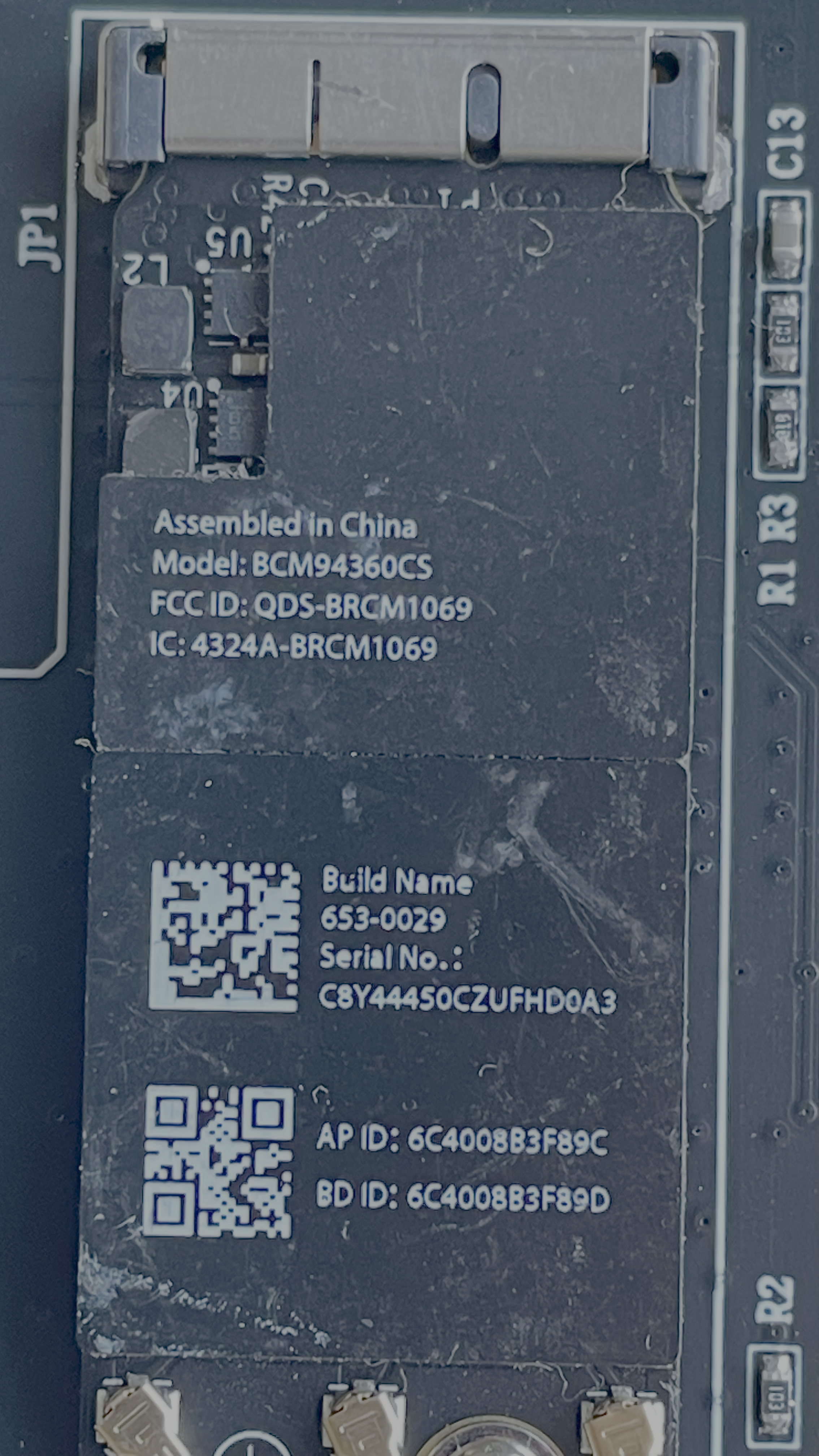

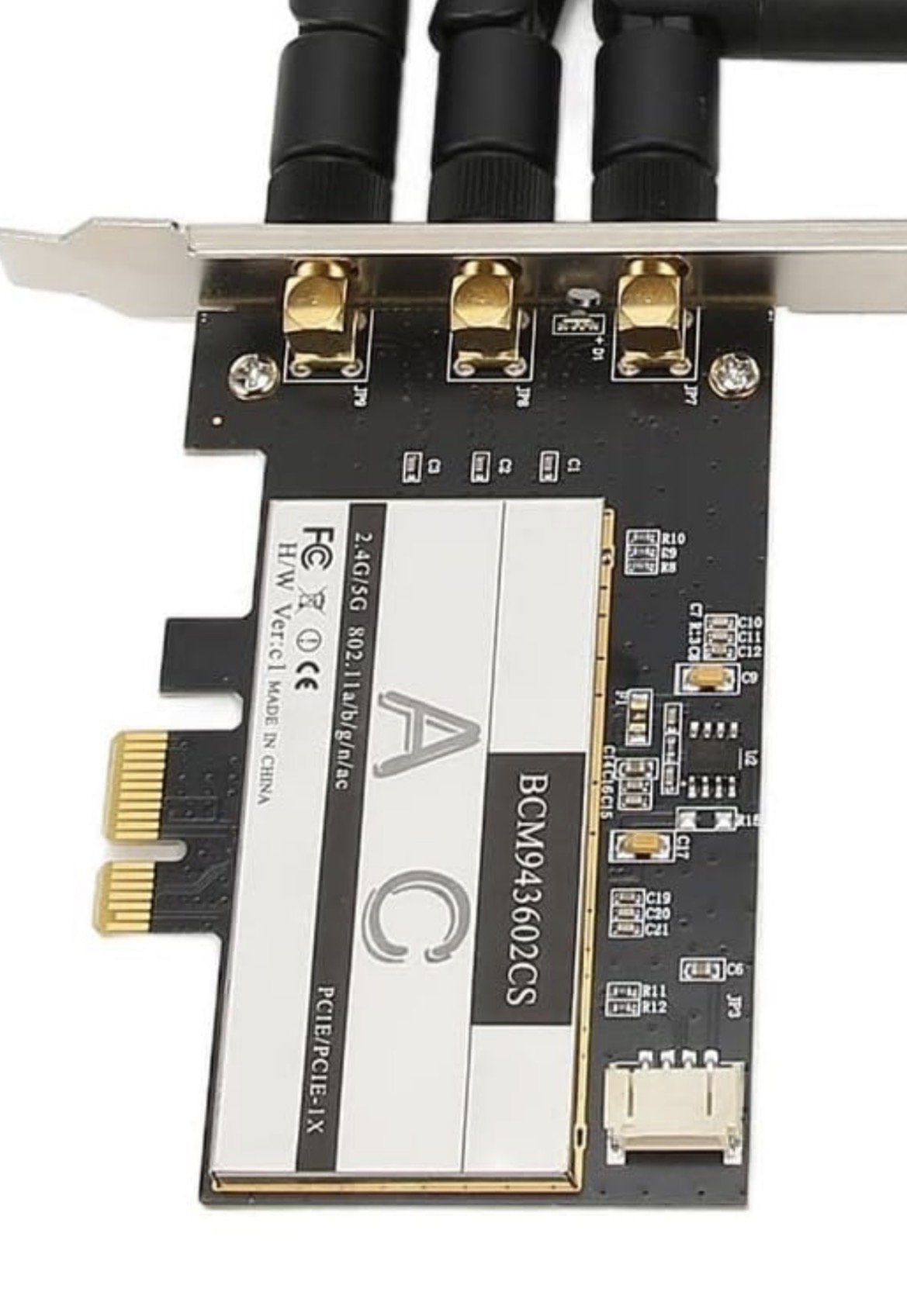

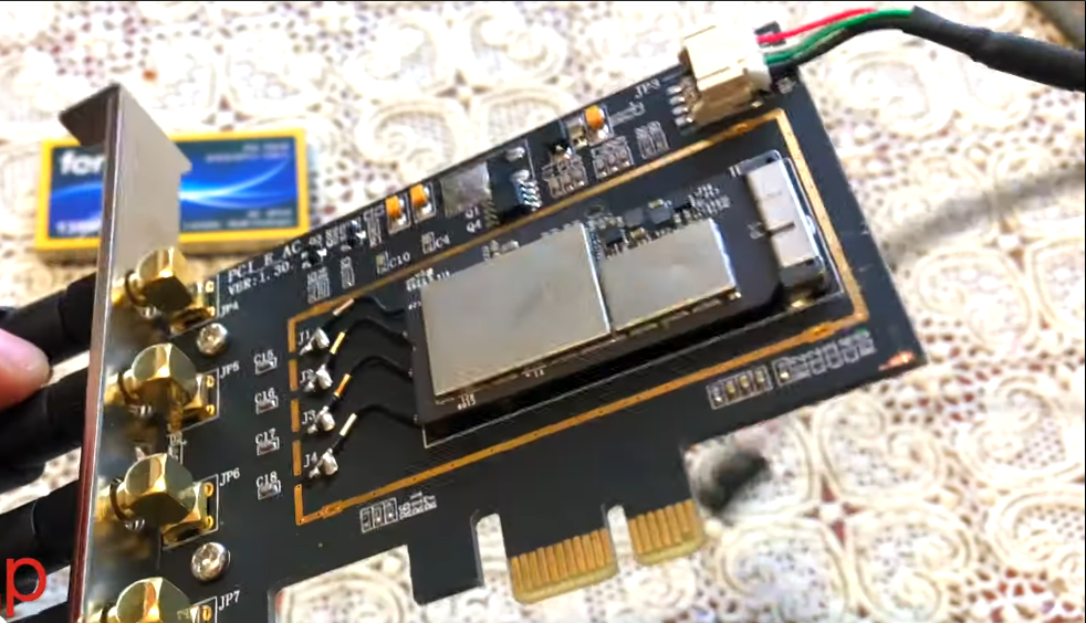

kgp Posted November 11, 2025 Share Posted November 11, 2025 (edited) 29 minutes ago, Mac Hosehead said: Actually, the BCM43602CDP has different size antenna connections so it will not work in the same card adapter. Some things about the photo: If the shield really says BCM43602CS then a different card has been put in the adapter. I assume it can be swapped with the right card. Another thing is that the photo shows no wires hooked up to the antenna connections on the card. I don't know how that is supposed to work. Kinda screwy all around. you are right, I was just assuming that he confused BCM4360CS with BCM43602CS. Looking now closely to the image of his originating post, it rather seems, that he has been cheated by the seller: A BCM43602CDP would certainly not be compatible with this adapter, as it needs 4 antennas. The BCM43602CS would have been the right card for swapping anyway. Thanks for your correction. Appreciated! Edited November 12, 2025 by KGP-iMacPro 1 Link to comment https://www.insanelymac.com/forum/topic/361710-broadcom-fullmac-wi-fi-support-on-macos-sonoma-sequoia-and-tahoe-without-root-patches/page/13/#findComment-2843575 Share on other sites More sharing options...

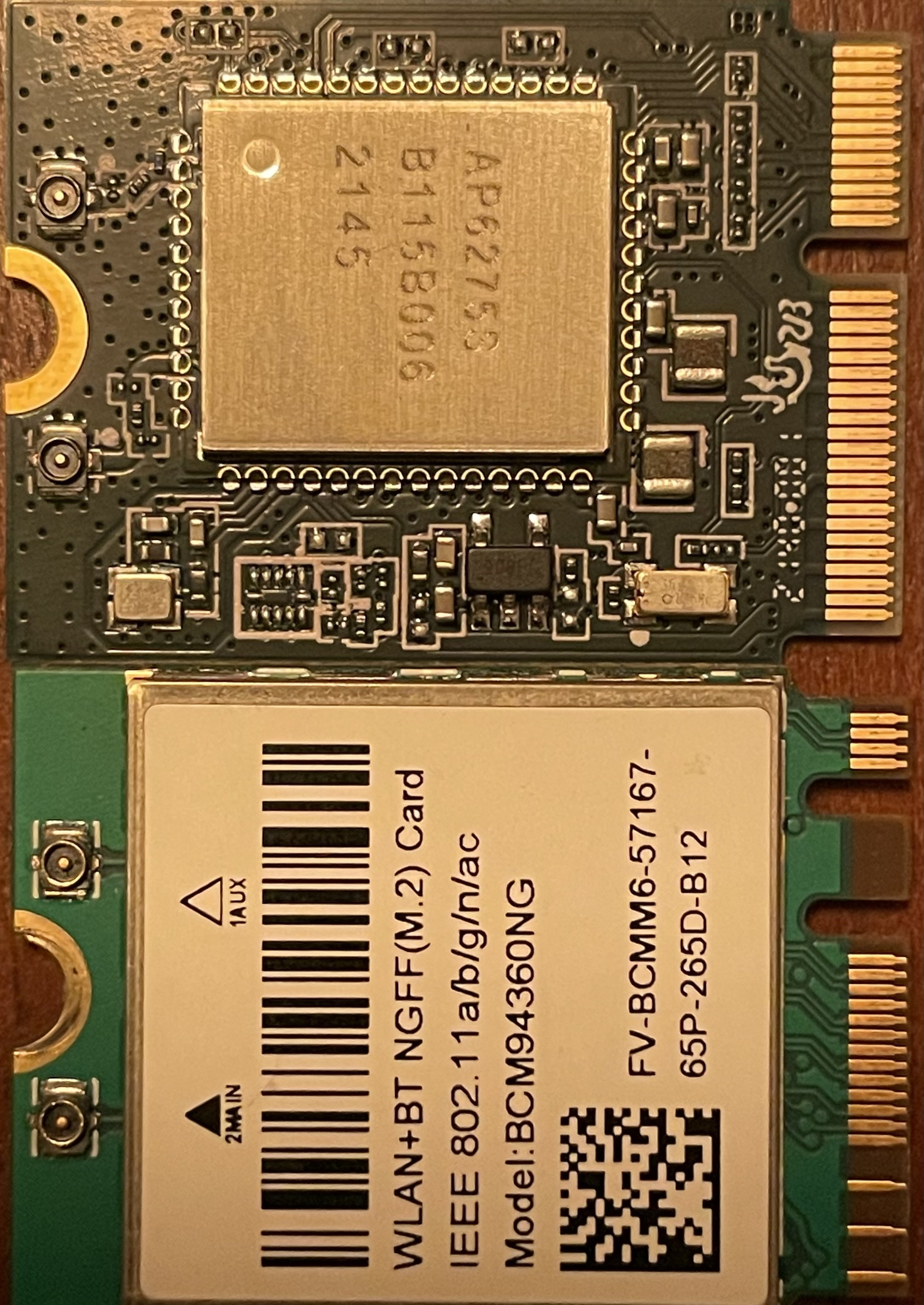

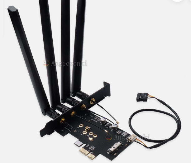

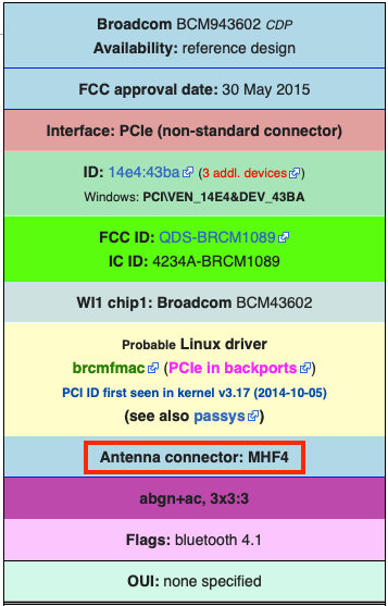

schrup21 Posted November 12, 2025 Share Posted November 12, 2025 (edited) 6 hours ago, Mac Hosehead said: BCM43602CDP The CDP might eventually fit in a Fenvi T919? The BCM94360CD within the Fenvi has MHF1 Connectors (while a BCM94360CS has MHF4) Spoiler MHF1 vs MHF4 Spoiler Although wikidevi.wi-cat.ru says BCM943602CDP has also MHF4 Spoiler Edited November 12, 2025 by schrup21 1 Link to comment https://www.insanelymac.com/forum/topic/361710-broadcom-fullmac-wi-fi-support-on-macos-sonoma-sequoia-and-tahoe-without-root-patches/page/13/#findComment-2843578 Share on other sites More sharing options...
kgp Posted November 12, 2025 Share Posted November 12, 2025 1 hour ago, schrup21 said: The CDP might eventually fit in a Fenvi T919? The BCM94360CD within the Fenvi has MHF1 Connectors (while a BCM94360CS has MHF4) Reveal hidden contents MHF1 vs MHF4 Reveal hidden contents Although wikidevi.wi-cat.ru says BCM943602CDP has also MHF4 Reveal hidden contents I purchased this PCIe adapter for my BCM943602CDP on Ebay Germany quite some time ago. The antenna connectors fit perfectly, and the BCM943602CDP module sits solid, even though there are no dedicated holes to secure it with screws: Link to comment https://www.insanelymac.com/forum/topic/361710-broadcom-fullmac-wi-fi-support-on-macos-sonoma-sequoia-and-tahoe-without-root-patches/page/13/#findComment-2843581 Share on other sites More sharing options...
Jessy Lou Posted November 12, 2025 Share Posted November 12, 2025 I pull out the metal box which was covering the device, and oh surprise surprise: KGP-iMacPro you are right, I've been nicely cheated by the reseller. My device is not a BMC943602CS but a BMC94360CS. So, while I'm waiting for the real card to arrive, I'm going to read carefully your advices concerning my config.plist. Without waiting any longer, I can tell you that I didn't cleaned-up my config.plist with the MinKernel on: a.) Lilu.kext MinKernel 10.0.0 b.) VirtualSMC.kext MinKernel 10.0.0 c.) WhateverGreen.kext MinKernel 12.0.0 d.) AppleALC.kext MinKernel 12.0.0 e.) IntelMausi.kext MinKernel 13.0.0 As for Tahoe, I'm working with another config.plist dedicated to Tahoe with a proper SMBIOS. I'm going also check whether IntelMausi.kext works under Tahoe with DisableIOMapper= false, i.e. AppleVTD enabled (which is the case for the actual Sequoia config.plist). Anyway: thank you to all of you. @eSaF: don't be upset, I wanted first to ensure I had the right device, which now is not a point anymore. 1 Link to comment https://www.insanelymac.com/forum/topic/361710-broadcom-fullmac-wi-fi-support-on-macos-sonoma-sequoia-and-tahoe-without-root-patches/page/13/#findComment-2843583 Share on other sites More sharing options...
kgp Posted November 12, 2025 Share Posted November 12, 2025 (edited) 32 minutes ago, Jessy Lou said: I pull out the metal box which was covering the device, and oh surprise surprise: KGP-iMacPro you are right, I've been nicely cheated by the reseller. My device is not a BMC943602CS but a BMC94360CS. So, while I'm waiting for the real card to arrive, I'm going to read carefully your advices concerning my config.plist. Without waiting any longer, I can tell you that I didn't cleaned-up my config.plist with the MinKernel on: a.) Lilu.kext MinKernel 10.0.0 b.) VirtualSMC.kext MinKernel 10.0.0 c.) WhateverGreen.kext MinKernel 12.0.0 d.) AppleALC.kext MinKernel 12.0.0 e.) IntelMausi.kext MinKernel 13.0.0 As for Tahoe, I'm working with another config.plist dedicated to Tahoe with a proper SMBIOS. I'm going also check whether IntelMausi.kext works under Tahoe with DisableIOMapper= false, i.e. AppleVTD enabled (which is the case for the actual Sequoia config.plist). Anyway: thank you to all of you. @eSaF: don't be upset, I wanted first to ensure I had the right device, which now is not a point anymore. Well, I configured for you a config.plist, that is universal and works with any version of macOS, including Tahoe. You can take it or leave it.. 😉. I don't catch the point why to use different EFI's or config.plists with different versions of macOS, if not deemed necessary. Using a different SMBIOS for Sequoia and Tahoe would even implement, that you register two different machines at Apple... I propose to use SMBIOS MacPro7,1 or one SMBIOS of your choice for all macOS versions. And yes, please let me know, if IntelMausi.kext works under Tahoe with DisableIOMapper= false, i.e. AppleVTD enabled. It is important for my summary. 👍 Edited November 12, 2025 by KGP-iMacPro Link to comment https://www.insanelymac.com/forum/topic/361710-broadcom-fullmac-wi-fi-support-on-macos-sonoma-sequoia-and-tahoe-without-root-patches/page/13/#findComment-2843585 Share on other sites More sharing options...

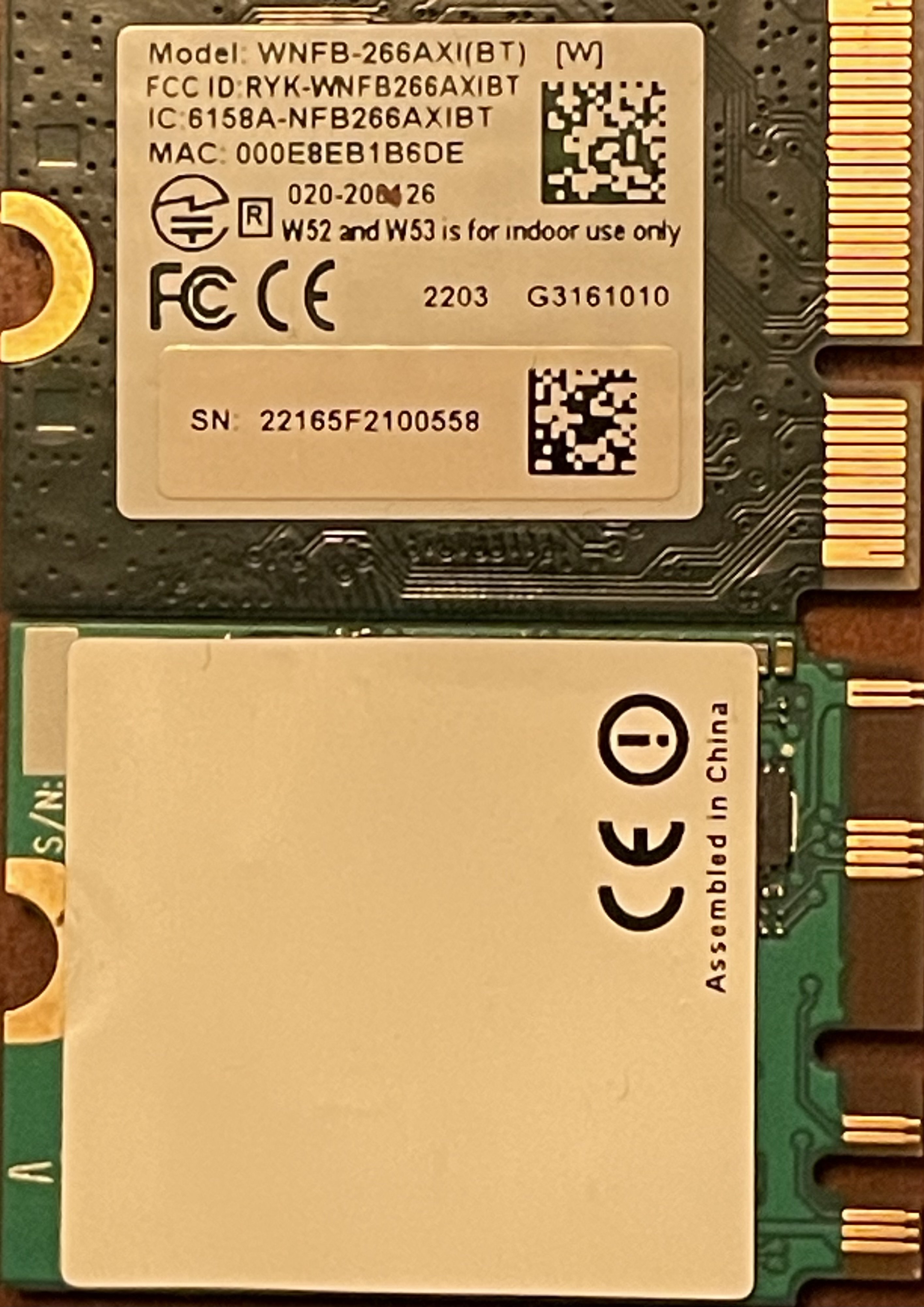

schrup21 Posted November 15, 2025 Share Posted November 15, 2025 On 11/5/2025 at 5:19 PM, dracon said: SparkLAN adapters Out of curiosity I ordered a WNFB-266AXi. Bad news: the module has an M-Key plug, my M.2 slot is A-Key. Normally M.2 Wifi modules have A+E and thus fit in an A slot - but not an E-Key module. I was able to find a "Riser" adapter with A+E plug and apparently M slot (I ordered) but I doubt that it works that way Here the comparison Spoiler Spoiler Link to comment https://www.insanelymac.com/forum/topic/361710-broadcom-fullmac-wi-fi-support-on-macos-sonoma-sequoia-and-tahoe-without-root-patches/page/13/#findComment-2843716 Share on other sites More sharing options...
