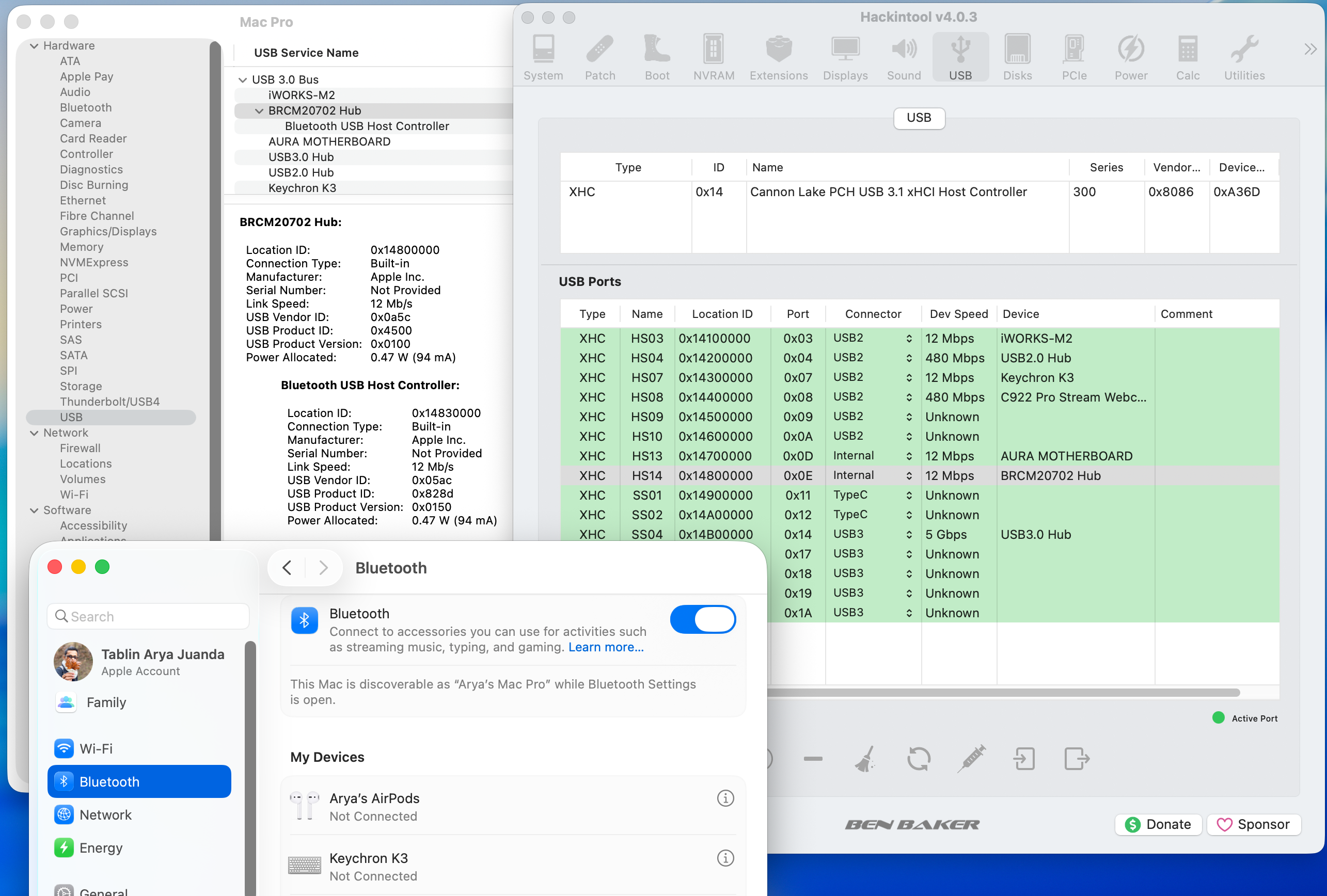

I am using the T919 and my bluetooth does not work. Anything you did to get it working. Can you share your EFI to compare
because i m using mini itx Mobo so i use M.2 Wifi card, the BT is connected over USB interface, in my case is internal usb port in my motherboard, im my specific mobo its HS13(internal mobo aura) and HS14(internal usb to M2 port)
for Fenvi 919 its need to connect the USB from pci card to a usb header, make sure that usb port is enable in mapping. CMIIW
  Reveal hidden contents
Thanks, you actually gave me a crucial clue as to why the BT was not working. I rechecked my USBMap.kext and see that I did not include that when I excluded unwanted ports. I remapped and now it's back. Thanks

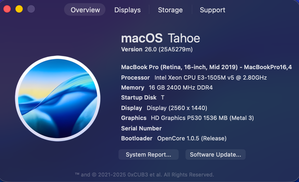

8 hours ago, ivak4eto said:

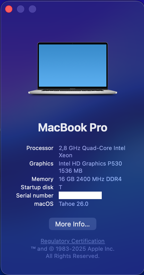

Finally got Tahoe on Dell Latitude 5510.
PROS: That euphoric feeling of being able to install it!
CONS: It's sluggish, so it didn't really worth the effort...
Is it a new installation or on an update? I am asking you this, cause on my matebook is also sluggish on an update and smooth on a new installation 😁

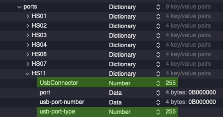

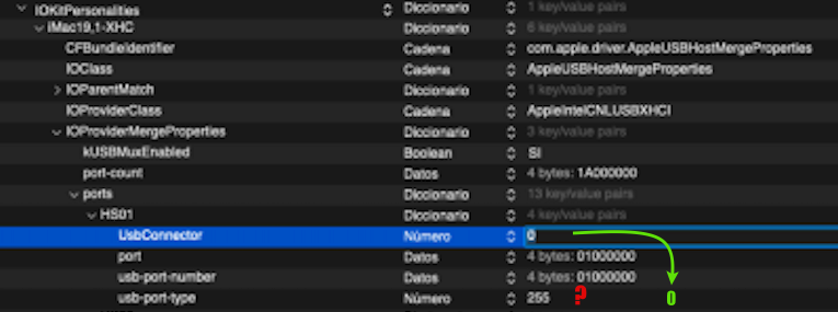

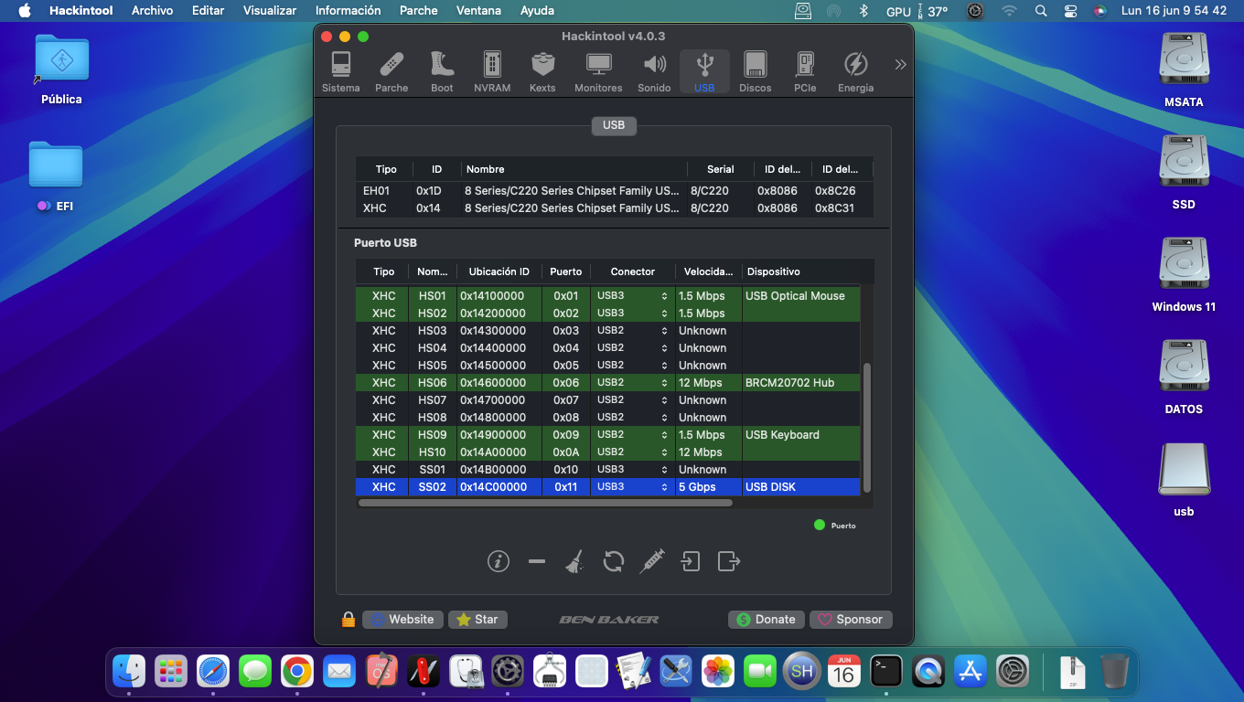

NEW: more research with Tahoe although in Sequoia and Tahoe you can use the USBMap.kext kext together with the SSDT SSDT-UIAC.aml and it creates the logical ports less than 15 the HSxx and SSxx in my case although it appears reflected the USB3.0 are not mounted as uUSB3.0 they are mounted in HSxx More cases have been reported with my specific chip we understand that this method is not working properly yet “Cannon Lake PCH USB 3.1 xHCI Host Controller” solution see screenshot
On the other hand in Hasweel the kext in question does work in OLD:
New install - I tried it on two different laptops: Skylake with HD P530 is sluggish, while Kabi Lake with HD 630 is fine.

From your screenshot
Spoiler

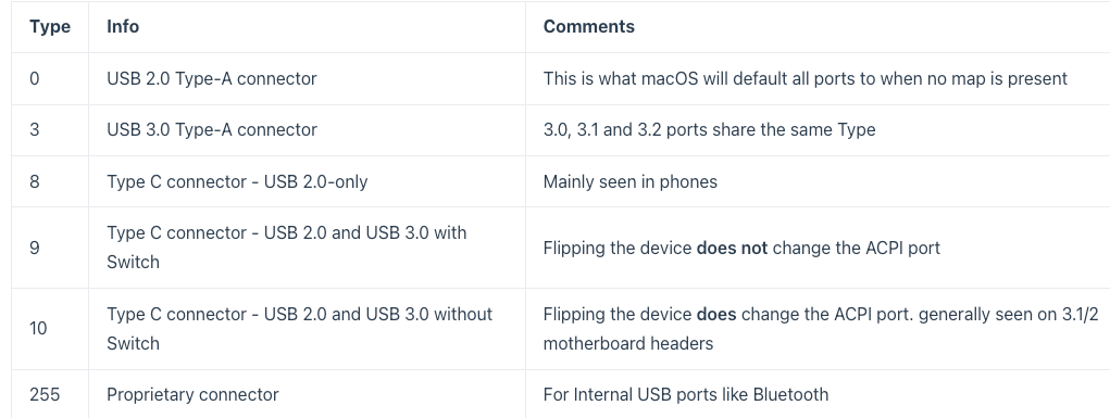

I don't understand why if the USBConnector is 0 you define it as 255

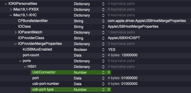

USBConnector and usb-port-type , they must have the same value
A couple of examples
Spoiler
Edited by Anto65
Just now, Anto65 said:
De a captura de pantalla
  Revelar contenidos ocultos
No entiendo por qué si el conector USB es 0 lo defines como 255
USBConnectorusb-port-type , deben tener el mismo valor

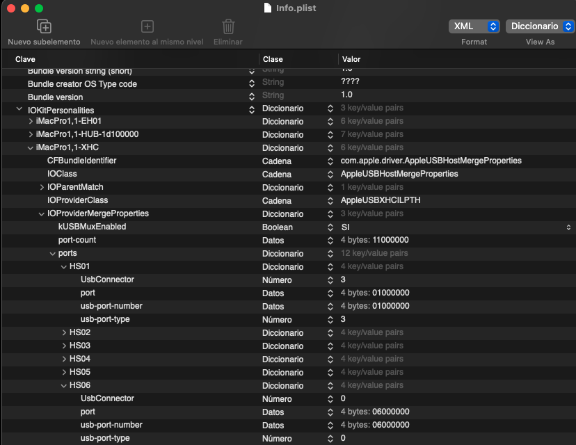

I continue investigating with respect to Hasweel, having carefully reviewed the kext, I find that HSxx ports have been assigned the value 3 instead of 0. I cannot find the apparent reason for this, but on this computer the OLD: it has correctly mounted the USB 3.0

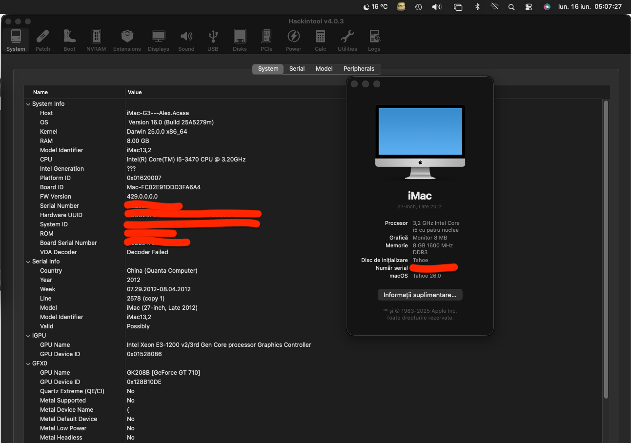

Hackintosh can be really interesting sometimes. My motherboard is Asus H110M-D. After updating the EFI folder I use, the installation is successful. I use Ventura, Sequoia and Thaoe with the same EFI. So far, normal. I wanted to see what the result would be with EFI folders belonging to different motherboards. And I tried with the EFI shared by @Ludox Interesting, but the installation is still successful. Another EFI is still successful. I guess the EFI does not matter for Asus H110M-D. 🤔😆

20 minutes ago, Anto65 said:
Corrected like this
