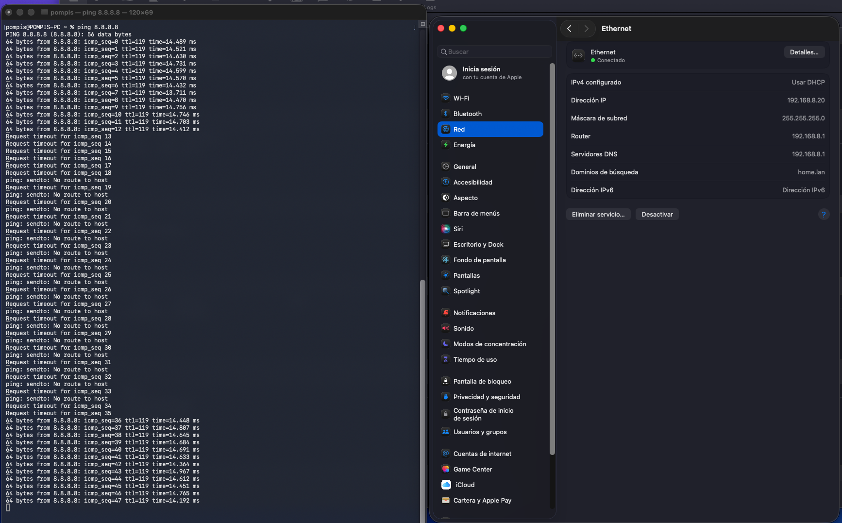

D-an-W Posted June 17, 2025 Share Posted June 17, 2025 13 minutes ago, PoMpIs said: Is this why the i226v loses connection in Tahoe? I read this earlier in the thread and will test it when I get home… ”What i found with the I226-V in Sequoia is that if you use the kexts and patch to get Broadcom wifi working then the appleIGC.kext wont wrk and the I226-V Lan wont work but if you disable the patch for IOSskyfamily.kext and related kexts and patches then it works.” 1 Link to comment https://www.insanelymac.com/forum/topic/361162-pre-release-macos-tahoe/page/32/#findComment-2833912 Share on other sites More sharing options...
PoMpIs Posted June 17, 2025 Share Posted June 17, 2025 5 minutes ago, D-an-W said: I read this earlier in the thread and will test it when I get home… ”What i found with the I226-V in Sequoia is that if you use the kexts and patch to get Broadcom wifi working then the appleIGC.kext wont wrk and the I226-V Lan wont work but if you disable the patch for IOSskyfamily.kext and related kexts and patches then it works.” I don't use Wi-Fi on that device, but every few minutes it loses internet access. I have to disable it in settings and then enable it again and it works again for another two minutes, and so on continuously. Link to comment https://www.insanelymac.com/forum/topic/361162-pre-release-macos-tahoe/page/32/#findComment-2833914 Share on other sites More sharing options...

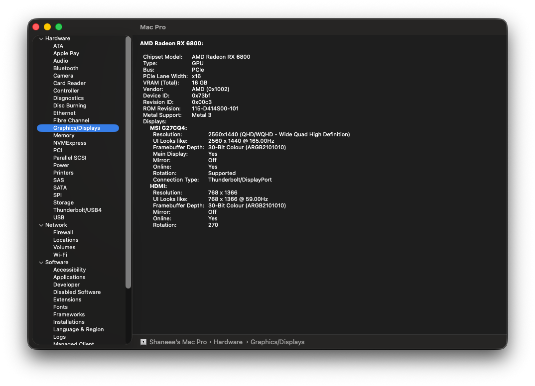

Shaneee Posted June 17, 2025 Share Posted June 17, 2025 2 hours ago, SavageAUS said: I just wanted to see if anyone else was experiencing the gray bar on the login screen (approx 1/3 screen) instead of the full screen wallpaper? No grey bar but login screen is a fraction of the resolution but this was an issue for me on Sequoia too... Possibly because of second monitor being a different size and rendering first for some reason. Spoiler 1 Link to comment https://www.insanelymac.com/forum/topic/361162-pre-release-macos-tahoe/page/32/#findComment-2833922 Share on other sites More sharing options...

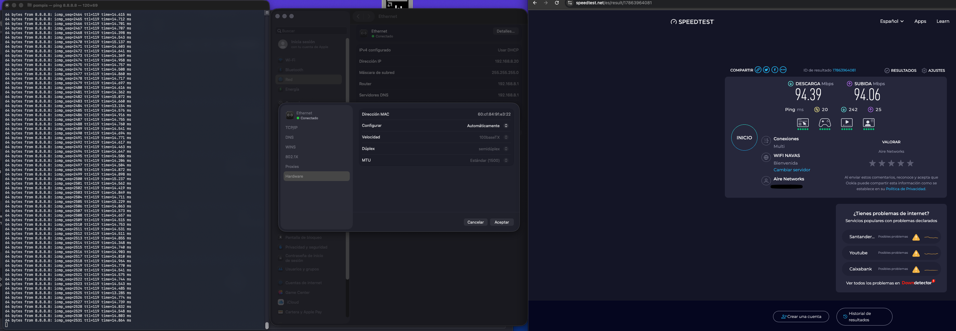

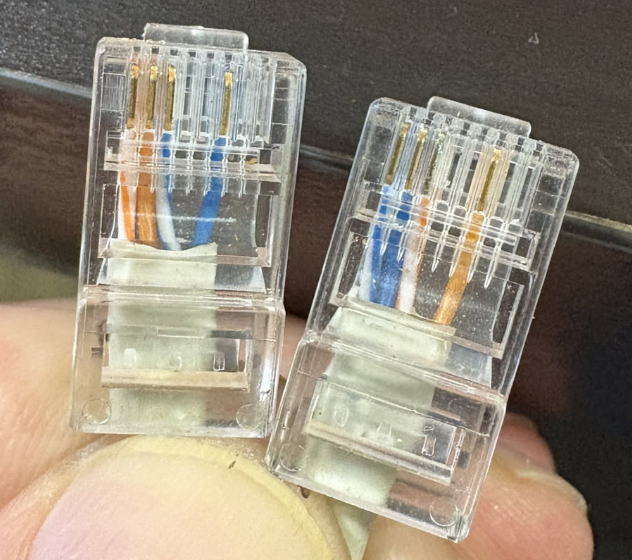

PoMpIs Posted June 17, 2025 Share Posted June 17, 2025 Oops... I've found the problem. The integrated I226V on my Asus x870F gaming motherboard works fine if I connect it at a maximum of 100Mbps... I had to make a network cable to be able to lower it to 100Mbps, because with the AppleIGC.kext driver it can't be changed in settings, or at least even if I set it manually it doesn't do anything, it stays at the maximum of the switch which is 2.5Gbps and as soon as it exceeds 100Mbps of traffic the card drops... At 100Mbps it works perfectly. Link to comment https://www.insanelymac.com/forum/topic/361162-pre-release-macos-tahoe/page/32/#findComment-2833925 Share on other sites More sharing options...

SavageAUS Posted June 17, 2025 Share Posted June 17, 2025 No grey bar but login screen is a fraction of the resolution but this was an issue for me on Sequoia too... Possibly because of second monitor being a different size and rendering first for some reason. Spoiler Both my monitors are identical besides one being 144hz and one is 165hz I think. Sent from my iPhone using Tapatalk Link to comment https://www.insanelymac.com/forum/topic/361162-pre-release-macos-tahoe/page/32/#findComment-2833928 Share on other sites More sharing options...

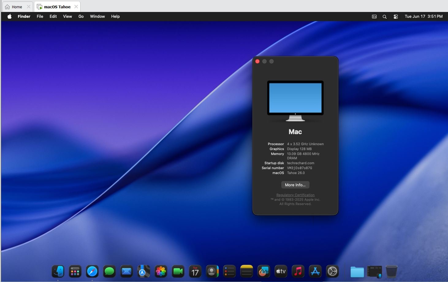

macky1 Posted June 17, 2025 Share Posted June 17, 2025 For a bit of fun. I installed Tahoe via VMware. 😀 4 Link to comment https://www.insanelymac.com/forum/topic/361162-pre-release-macos-tahoe/page/32/#findComment-2833934 Share on other sites More sharing options...

dogansan Posted June 17, 2025 Share Posted June 17, 2025 (edited) 1 hour ago, PoMpIs said: Oops... I've found the problem. The integrated I226V on my Asus x870F gaming motherboard works fine if I connect it at a maximum of 100Mbps... I had to make a network cable to be able to lower it to 100Mbps, because with the AppleIGC.kext driver it can't be changed in settings, or at least even if I set it manually it doesn't do anything, it stays at the maximum of the switch which is 2.5Gbps and as soon as it exceeds 100Mbps of traffic the card drops... At 100Mbps it works perfectly. @PoMpIs, would you so kind to explain how you made an ethernet cable throttling the speed down to 100Mbps ? It sounded me like a magic. And I wonder if you have any specific settings in config.plist other than AppleIGC.kext. One guy in Applelife told me he runs i226-V without AppleIGC.kext and AMFI.kext . But when I do this it can not login after bbot process , just black screen. Here is the link https://applelife.ru/threads/ustanovka-macos-tahoe-26-beta-na-intel-pc.2979499/page-17#post-1064929 Update: After a lot hassle, I found the solution here https://github.com/SongXiaoXi/AppleIGC/issues/23 . It is so simple only by enabling DisableIoMapper or DisableIoMapperMapping to True Edited June 17, 2025 by dogansan 2 1 Link to comment https://www.insanelymac.com/forum/topic/361162-pre-release-macos-tahoe/page/32/#findComment-2833943 Share on other sites More sharing options...
macky1 Posted June 17, 2025 Share Posted June 17, 2025 28 minutes ago, eSaF said: Here you are saying something like just for fun. Fun is a bad word as far as Tahoe is concerned. Well done though gives hope the possibility is there as an alternative. Cheers. Trust me I say it sarcastically because I havent managed to load Tahoe on my PC yet. But congrats on your install.😀 1 Link to comment https://www.insanelymac.com/forum/topic/361162-pre-release-macos-tahoe/page/32/#findComment-2833944 Share on other sites More sharing options...

PoMpIs Posted June 17, 2025 Share Posted June 17, 2025 22 minutes ago, dogansan said: @PoMpIs, would you so kind to explain how you made an ethernet cable throttling the speed down to 100Mbps ? It sounded me like a magic. And I wonder if you have any specific settings in config.plist other than AppleIGC.kext. One guy in Applelife told me he runs i226-V without AppleIGC.kext and AMFI.kext . But when I do this it can not login after bbot process , just black screen. Here is the link https://applelife.ru/threads/ustanovka-macos-tahoe-26-beta-na-intel-pc.2979499/page-17#post-1064929 To make a 100Mbps cable, use only 4 cables... Like this: White-orange orange white-blue blue ********** white-blue blue white-orange orange Photo: It worked perfectly for me, but at 100Mbps it's useless; it's not a viable solution... I'm using an AMD motherboard. On Intel motherboards (at least on older systems), having IntelVTD enabled in the BIOS and I believe Disableiomapper in the OC usually works without AppleIGC. 2 1 Link to comment https://www.insanelymac.com/forum/topic/361162-pre-release-macos-tahoe/page/32/#findComment-2833948 Share on other sites More sharing options...
