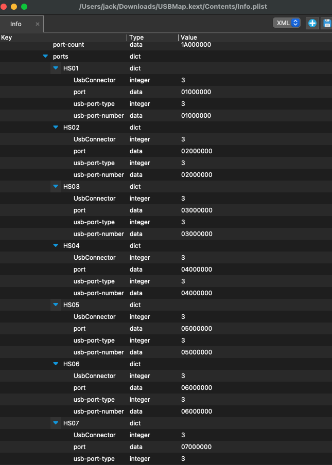

Hello Sir
But where does the info.plist file come from, in which you can modify the USB ports?
I use this USBMap-master and after  letters D, Q, P, A, K
I get the USBMap.kext file, but there's no improvement upon reboot.
regards

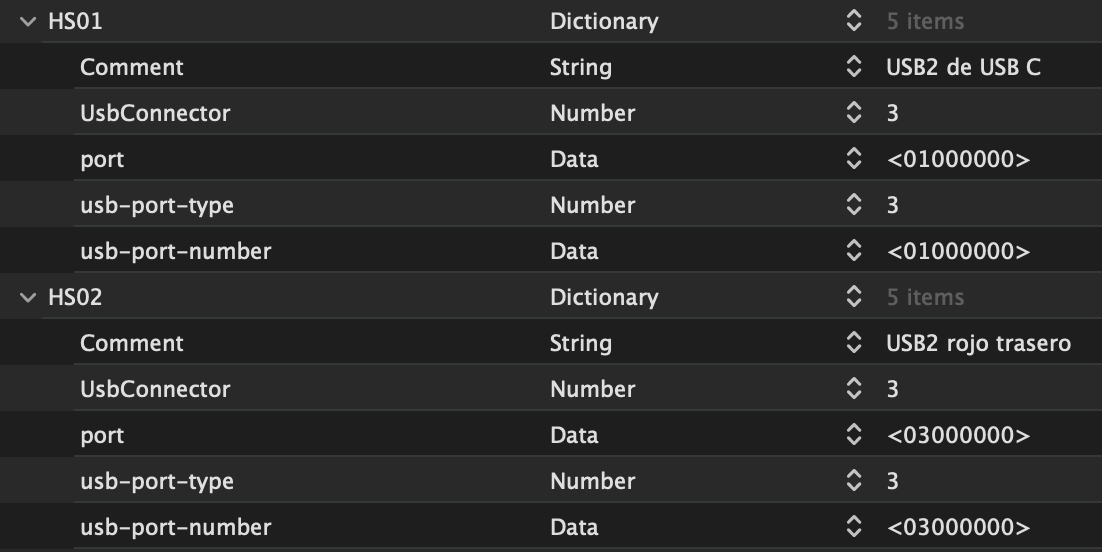

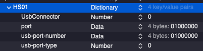

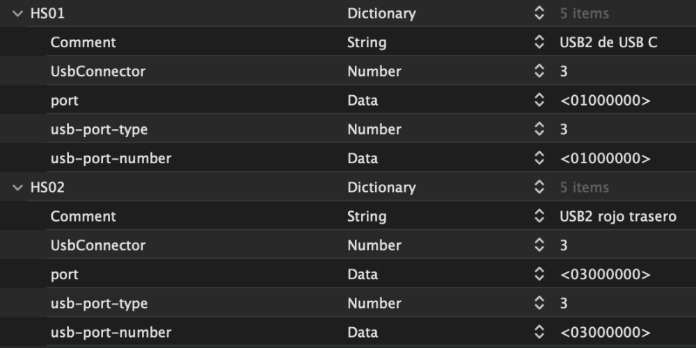

28 minutes ago, Anto65 said:

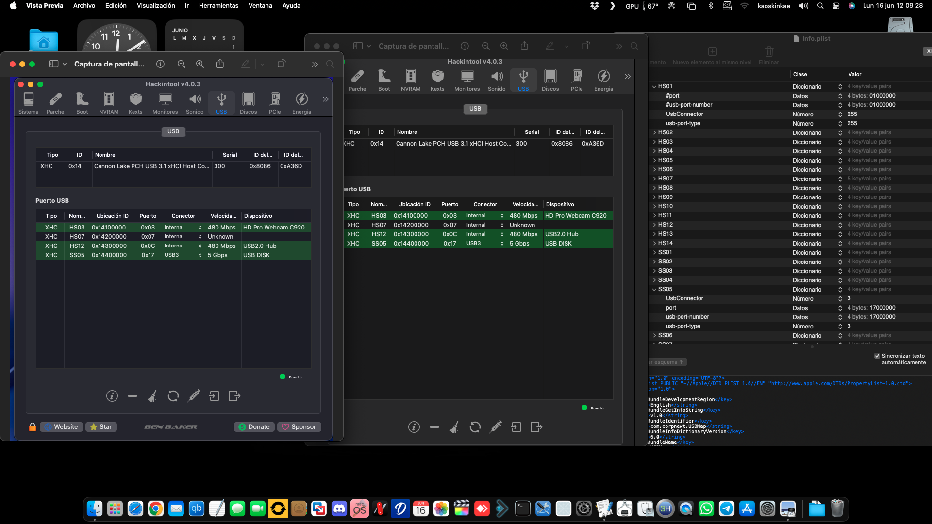

Solved there, do things slowly and without haste, my mistakeimage.thumb.png.f7a1c0090d7ab4c691a12ed26cc8f144.png is that I added all the HS and SS devices but in the unavailable ones I put # working in both systems
  • Like 3
15 minutes ago, kaoskinkae said:
Solved there, do things slowly and without haste, my mistake is that I added all the HS and SS devices but in the unavailable ones I put # working in both systems
And yes, you have to do it calmly, I understand that after several unsuccessful attempts, one makes some mistakes

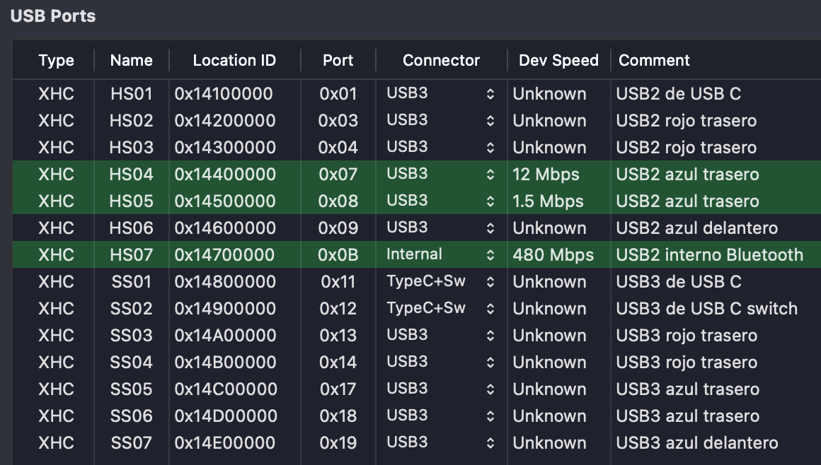

@arya  @Anto65
Indeed, USBMAp.kext was wrong, I rebuild it again (BT internal port as 255) and Fenvi Bluetooth works as before.
USBMap.kext has the properties it used up until Sequoia along with the new ones required by Tahoe. It seems to work fine on Tahoe and earlier macOS.
Spoiler
As a bonus, Hackintool displays USB ports correctly, which wasn't the case before.
Spoiler

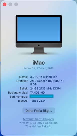

I can now confirm and brag that my Teaho is 100% working. Even my trackpad is now working without having to first plug a usb mouse. Thank you everyone for your assistance and guidance  in this Hackintosh journey. I am now waiting to see what the next beta is going to bring our way and wish everyone still struggling to eventually get it right 😁
