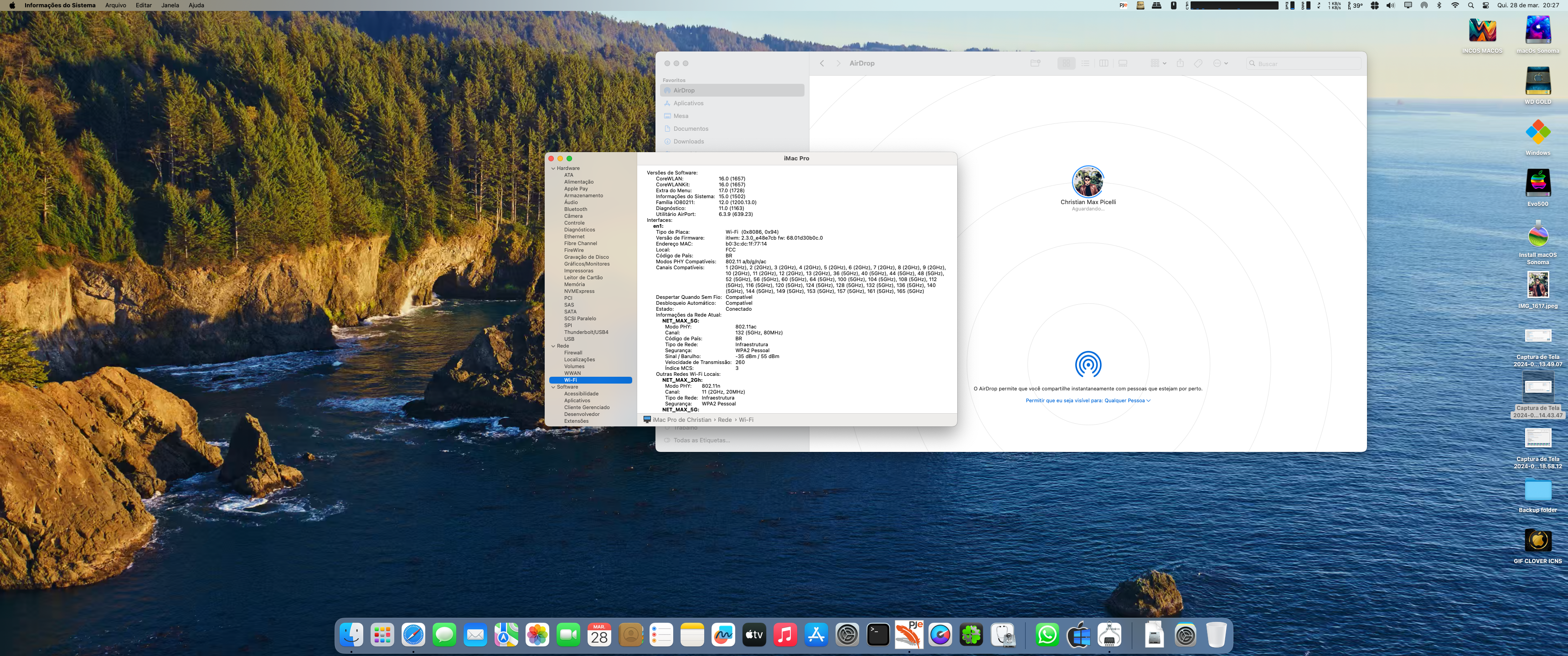

Hi my friend works from Desktop to iPhone for while, and I believe it's not Bluetooth or even Wireless, but permission or configuration from Kext.
See my Desktop Airdrop intel Wireless + Broadcom BT to my Iphone
Spoiler
  • Haha 1
see my friend @miliuco and above too
My Lenovo 100% intel Wifi and BT to my Desktop intel Wifi + BRCM BT
And both to my Iphone
The "secret" to me is Clover and compiled Kexts and Bootloader with GCC compiler

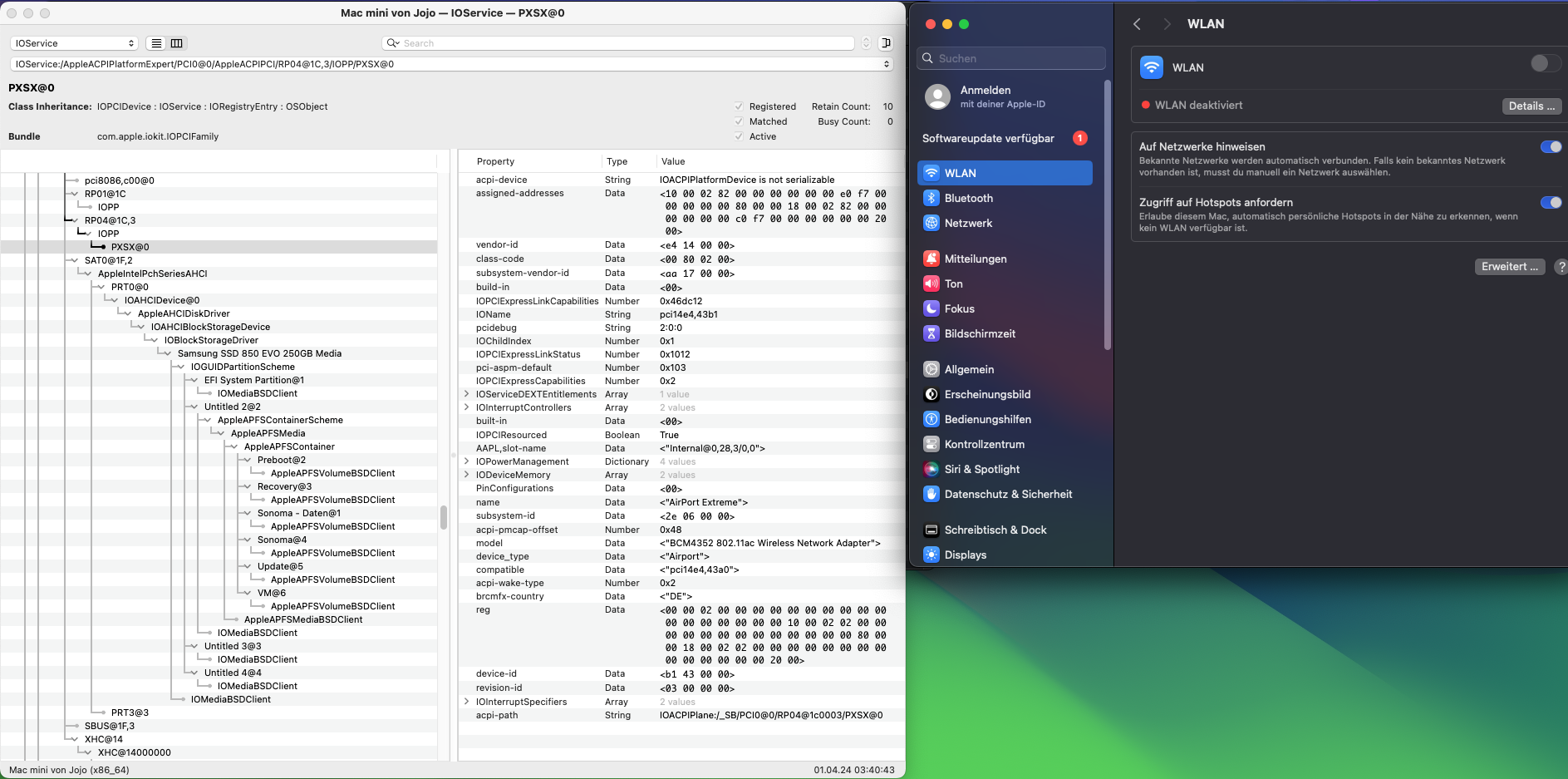

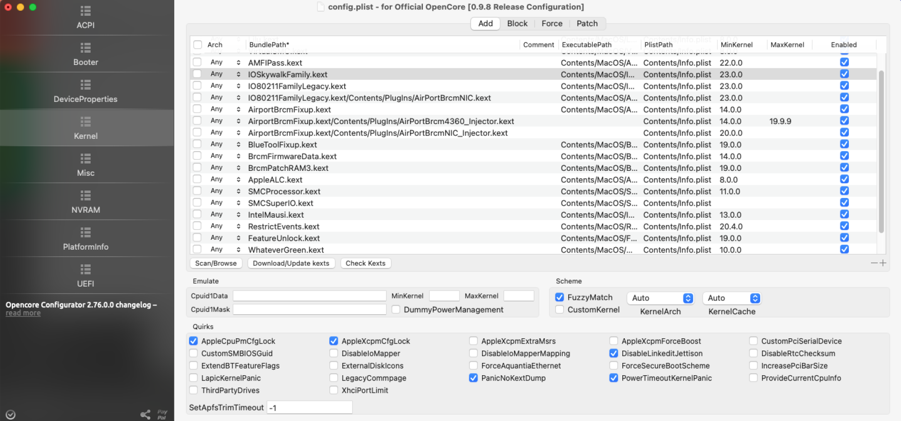

Hello everyone,

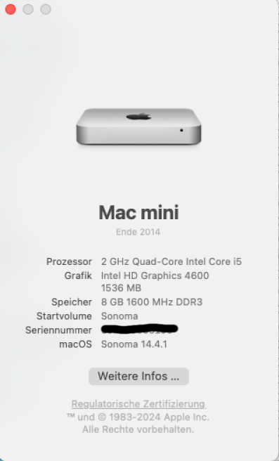

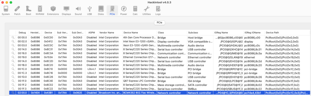

I have a "Lenovo ThinkCentre M93 Tiny" with the Mini PCI-E WIFI card BCM94352HMB. As far as Ventura, the WIFI worked without any problems.
But now I can't get the WIFI card to work under Sonoma. I've read everything here over and over again 20 times. Unfortunately I can't come to a positive solution.
The system is configured as Mac Mini 7,1 and I made all the settings for WIFI as described here.

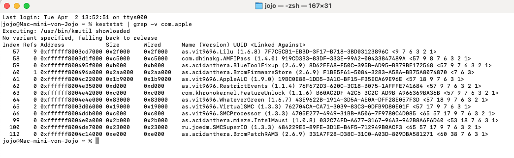

Here are screenshots of my system.
2024-03-2919_23_21-192_168_10.23(Macmini)RealVNCViewer.png.d7c6c9317beb45c29504b4f2b569c6a9.png
2024-03-2919_15_52-192_168_10.23(Macmini)RealVNCViewer.thumb.png.3913ee618fc459b6f4f7a28a95b74387.png
2024-03-2919_16_47-192_168_10.23(Macmini)RealVNCViewer.thumb.png.e7e8783a20de3a9e083052894f696ca2.png
2024-03-2919_17_58-192_168_10.23(Macmini)RealVNCViewer.thumb.png.c15b779a3071126276e12684bf1e62ed.png
2024-03-2919_18_45-192_168_10.23(Macmini)RealVNCViewer.thumb.png.ec4b472cf61860bdc3b1e2d991e8c973.png

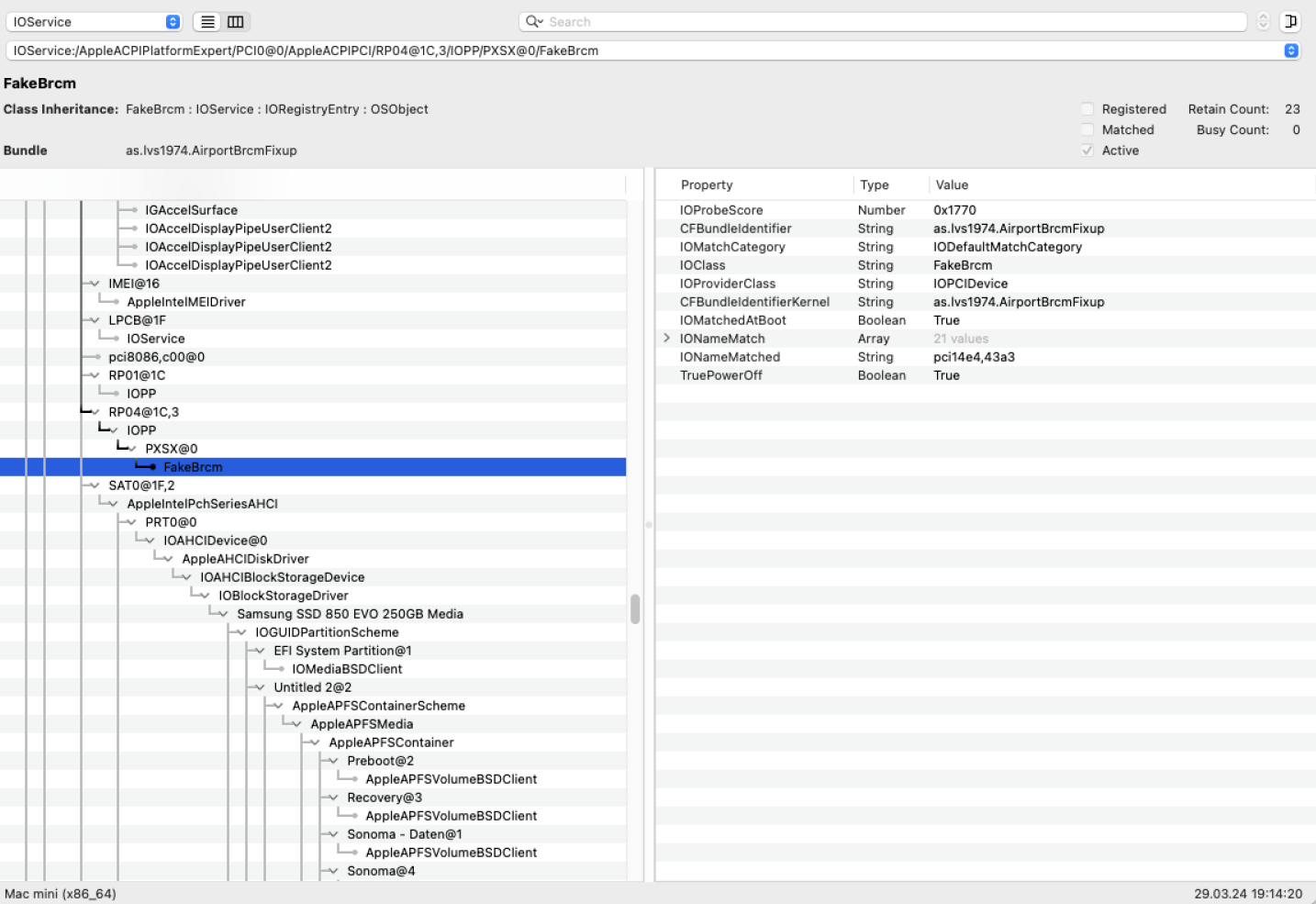

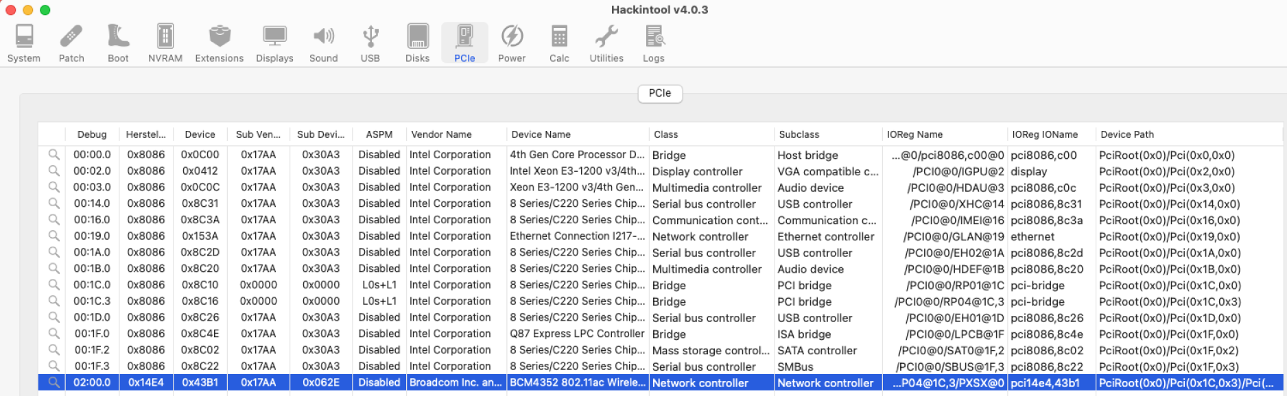

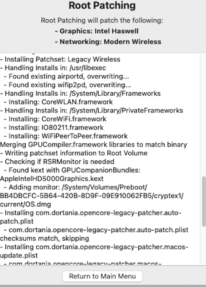

During root patching, the graphics and WIFI cards were correctly recognized and the graphics card is also patched correctly.
2024-03-2919_24_12-192_168_10.23(Macmini)RealVNCViewer.thumb.png.cef9e0de38d8f11ef5a4c9d69c9cda25.png
But the WIFI card is not patched properly. Tha WIFI card is displayed here as a FakeBCM card.
2024-03-2919_14_23-192_168_10.23(Macmini)RealVNCViewer.thumb.png.05382482cdd57c9c6d58924b27c56c26.png
I hope you can help me.
Edited by witjojo

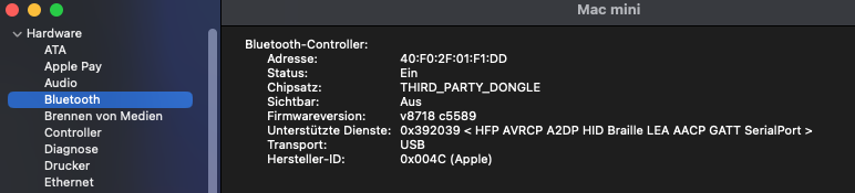

Hi Max,
I have now switched my SMBIOS to MacBook Pro 15.2 and repached again. But no difference, no WiFi.

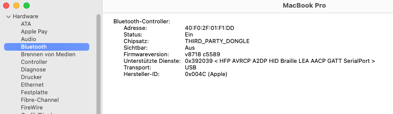

I noticed that Bluetooth is also recognized as a third party dongle. That wasn't the case at Ventura.
Here is my EFI. I deleted IO80211FamilyLegacy.kext from the EFI, because I can only upload 10 MB.
EFI.zip
Edited by witjojo
15 hours ago, witjojo said:
Hello everyone,

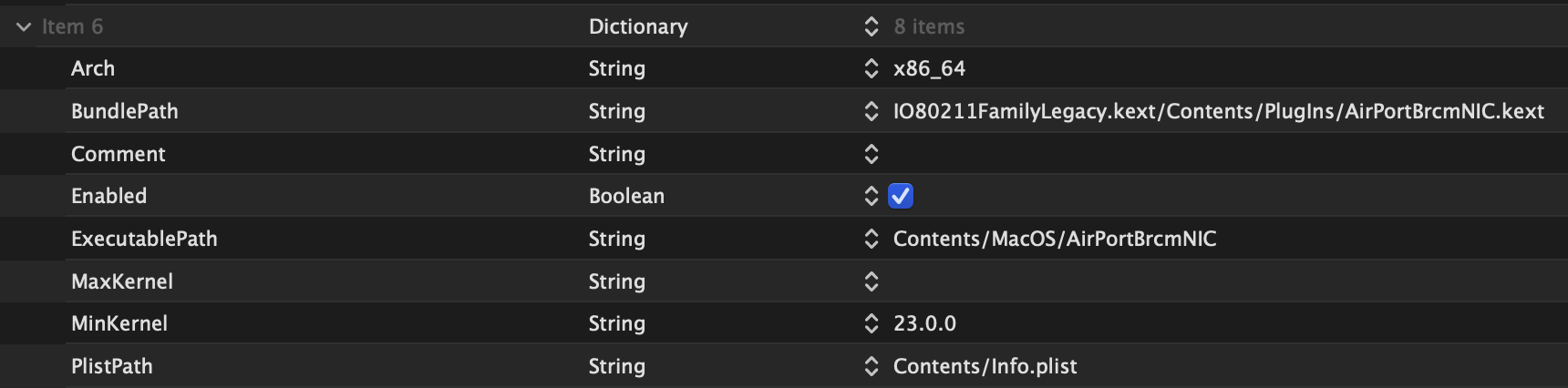

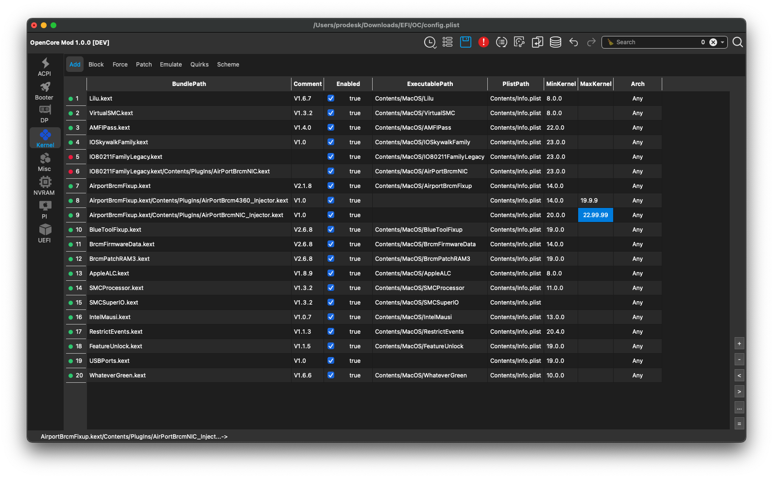

1 - AirportBrcmFixup.kext/Contents/PlugIns/AirPortBrcmNIC_Injector.kext , Add Max Kernel 22.99.99
2 - Your EFI has missing IO80211FamilyLegacy.kext
Macmini7,1 is good for your Hardware
Edited by datafeedexpert
  • Thanks 1
1. I thnk Max Kernel 22.99.99 is not necessary.
2. I deleted IO80211FamilyLegacy.kext from the EFI, because I can only upload 10 MB. It's inside my EFI.
I think if Macmini 7,1 or MacBook Pro 15,2 is not important.
Try Adding Max Kernel 22.99.99
its confirmed from my side i am having same hardware & the same issue when updated to Sonoma 14.4
That can't be right, can it?
Sonoma is 23.0.0 and if Max Kernel is 22.99.99 then AirportBrcmFixup.kext/Contents/PlugIns/AirPortBrcmNIC_Injector.kext will not be injected.
This would mean that AirPortBrcmFixup.kext is not needed for Sonoma. Only the IOSkywalkFamily.kext and IO80211FamilyLegacy.kext and the root patching?
I have changed to Max Kernel 22.99.99. But I still don't have WiFI.
If you have the same hardware, can you give me your EFI to test? Maybe I have errors somewhere else in settings, ACPI, USB, etc.
@witjojo

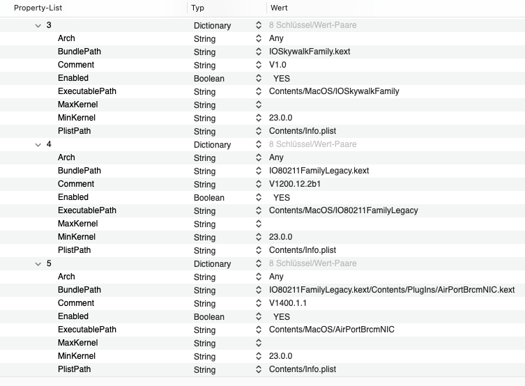

Load IO80211FamilyLegacy.kext/Contents/PlugIns/AirPortBrcmNIC.kext instead of AirportBrcmFixup.kext/Contents/PlugIns/AirPortBrcmNIC_Injector.kext.
Spoiler
Maybe you need extra kexts but try the above and comment.

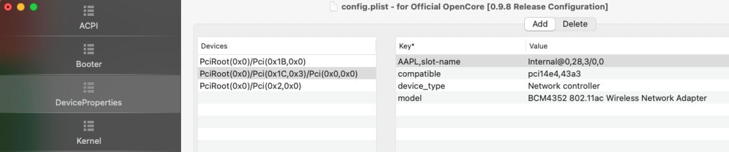

Hi @witjojo try use this first, without open config.plist with another program, only ProperTree or PlistEdit Pro.
Test first and don't forget us Reset Nvram on boot.
Good Lucky

I now used your EFI. Then NVRAM reset and re-root patched with OpenCore Legacy Patcher.
The system boots perfectly. But unfortunately still no WIFI.
Strangely, Bluetooth is also shown as a third party dongle.
Why isn't the BCM94352HMB card recognized/patched correctly? The card worked up to Ventura, but with the "AirportBrcmFixup.kext/Contents/PlugIns/AirPortBrcm4360_Injector.kext".
@datafeedexpert can you help further? Or are there any other experts who can help me?
Edited by witjojo

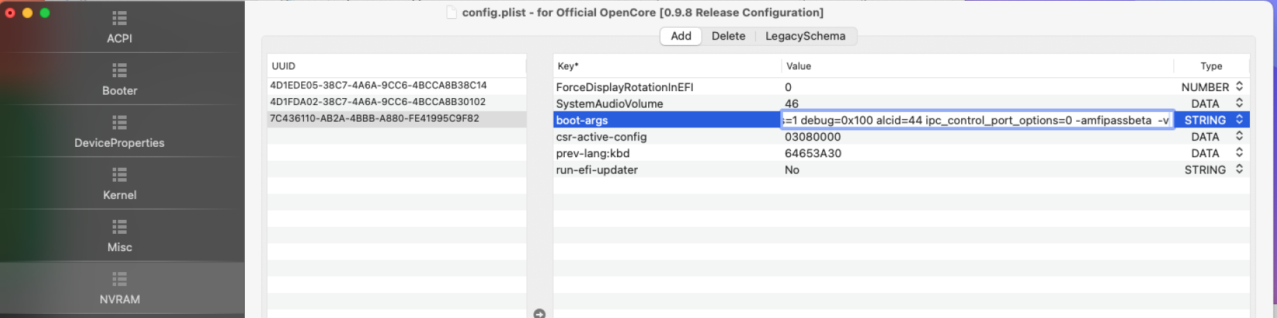

  • Add -brcmfxbeta if AirportBrcnFixup and the Skywalk etc won't load. (Thanks @deeveedee) Verify loaded kexts by using kextstat | grep -v com.appleFollow @cankiulascmnfye 's Step too
I add -brcmfxbeta and amfi=0x80 but AirportBrcnFixup and the Skywalk etc won't load. And no WIFI.

And I really only need the 3 kext below and the Patcher for the BCM94352HMB card? The AirportBrcmFixup is not needed, right?
I think you have to build OCLP using @cankiulascmnfye mentioned changes using Morden / Legacy , i think your  BCM94352HMB is a Legacy card
