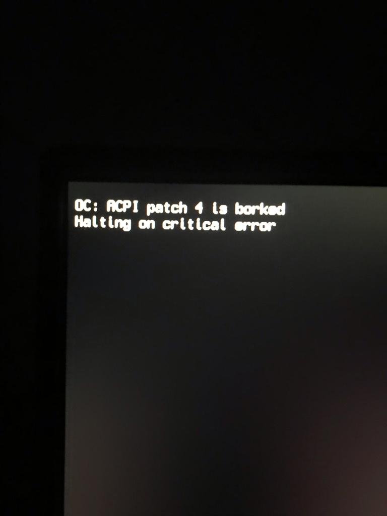

ammoune78 Posted April 13, 2020 Share Posted April 13, 2020 9 minutes ago, Download-Fritz said: @ammoune78 idk what AGPMEnable is, but it does not have ExecutablePath set... maybe upload your EFI folder Sure, without it and TSCAdjustReset clover don't boot, so i guess it would be the same maybe with OP. I sometimes get OP: ACPI patch 4 is borked, and i don't know what does it mean. Here's the actual EFI folder with OP 0.5.7 downloaded from the release section: EFI.zip Link to comment https://www.insanelymac.com/forum/topic/350754-opencore-general-discussion/page/159/#findComment-2717171 Share on other sites More sharing options...

ammoune78 Posted April 13, 2020 Share Posted April 13, 2020 Didn't see it at all, until you mentioned it, thanks. How about the OP: ACPI patch 4 is borked: Quote I don't catch for what it point Link to comment https://www.insanelymac.com/forum/topic/350754-opencore-general-discussion/page/159/#findComment-2717174 Share on other sites More sharing options...
mhaeuser Posted April 13, 2020 Share Posted April 13, 2020 @ammoune78 of course it is, 1) you cannot replace something with something else of different length and 2) you replace the ASCII string "Device (RTC)" instead of the bytecode that represents this expression (ACPI is not text)... just don't apply the patch at all actually, what is it supposed to even fix? 1 Link to comment https://www.insanelymac.com/forum/topic/350754-opencore-general-discussion/page/159/#findComment-2717176 Share on other sites More sharing options...
ammoune78 Posted April 13, 2020 Share Posted April 13, 2020 It's just cosmetic, with no fix, i was wondering to don't replace the entire RTC code found on the whole of the DSDT, this is why. Thats the mistake, i used the ASCII string instead of the bytes, because of different language. But even if i delete it I have the same thing, for: LPC0 to LPCB and the upcoming patches that will be in the line 4. Why it skips 0, 1, 2, 3, and only point on 4, is it a single code error for the whole, or line sensitive? Link to comment https://www.insanelymac.com/forum/topic/350754-opencore-general-discussion/page/159/#findComment-2717178 Share on other sites More sharing options...

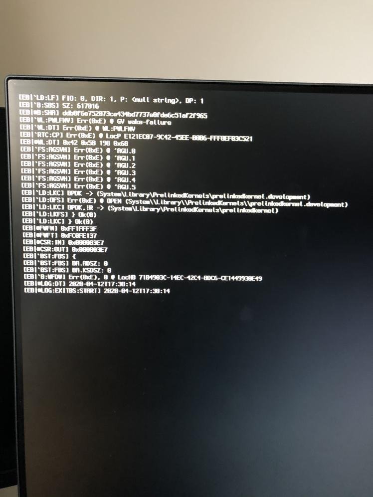

Helipilot2 Posted April 13, 2020 Share Posted April 13, 2020 (edited) Can anyone help me with the following error? Today i tried to upgrade to 0.5.7 but i get the following error: (i replaced FWRUNTIME to Openruntime, Replaced the SSDT files, and upgraded the config, but without luck) GA-Z170m-D3H, i5-6600K, 32GB crucial DDR4 ram, Gigabyte RX 480 Gaming 8 GB, Samsung evo 960 m.2 SSD. EFI-4.zip Edited April 13, 2020 by Helipilot2 Link to comment https://www.insanelymac.com/forum/topic/350754-opencore-general-discussion/page/159/#findComment-2717187 Share on other sites More sharing options...

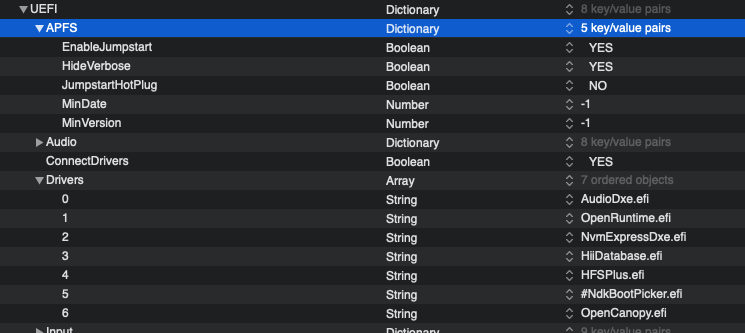

Andres ZeroCross Posted April 13, 2020 Share Posted April 13, 2020 (edited) @vit9696 i used latest commit of OpenCorePkg and AppleSupportPkg,, i have set "MinDate" and "MinVersion" of APFS section to "-1" but still my Mojave Entry is not shown. OpenCore only shows Windows, MX Linux, and my Catalina Entry,, Mojave entry is dissapeared Any clue??? Edited April 13, 2020 by Andres ZeroCross Link to comment https://www.insanelymac.com/forum/topic/350754-opencore-general-discussion/page/159/#findComment-2717239 Share on other sites More sharing options...

iGPU Posted April 14, 2020 Share Posted April 14, 2020 18 hours ago, Download-Fritz said: @ammoune78 of course it is, 1) you cannot replace something with something else of different length and 2) you replace the ASCII string "Device (RTC)" instead of the bytecode that represents this expression (ACPI is not text)... just don't apply the patch at all actually, what is it supposed to even fix? I want to remove code from DSDT using patch, so replacement is by definition shorter. This works in Clover, but not with OC. Image in Spoiler shows how I'd like it to work. As a work-around, I've tried padding with space (20) and other values. but nothing works: padding either fails to boot, or at best, boots with a corrupted DSDT file. Is there a way around this? Spoiler Link to comment https://www.insanelymac.com/forum/topic/350754-opencore-general-discussion/page/159/#findComment-2717329 Share on other sites More sharing options...

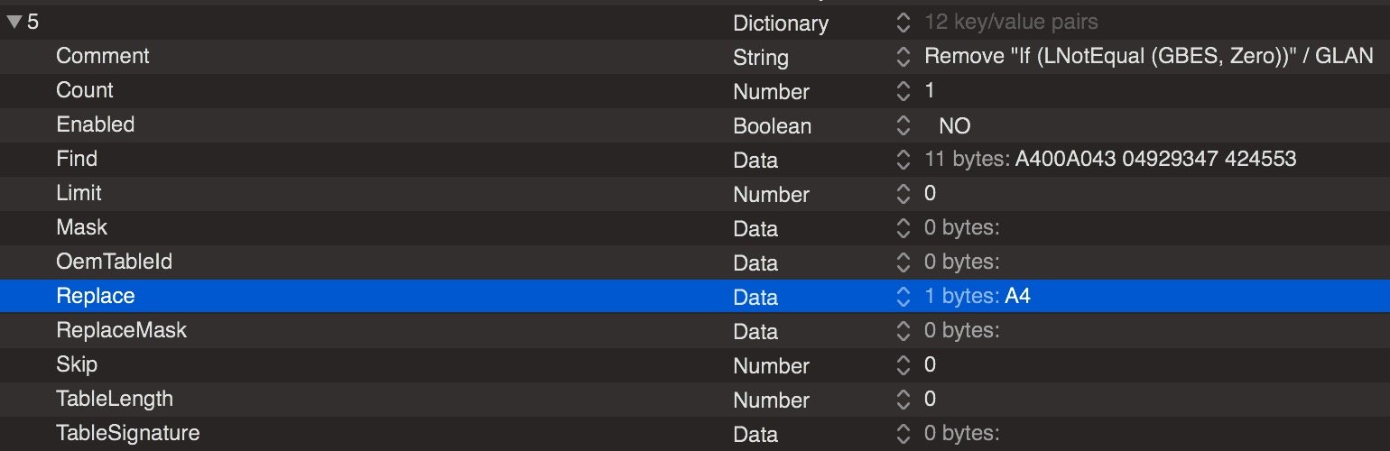

mhaeuser Posted April 14, 2020 Share Posted April 14, 2020 2 hours ago, iGPU said: I want to remove code from DSDT using patch, so replacement is by definition shorter. This works in Clover, but not with OC. Image in Spoiler shows how I'd like it to work. As a work-around, I've tried padding with space (20) and other values. but nothing works: padding either fails to boot, or at best, boots with a corrupted DSDT file. Is there a way around this? Reveal hidden contents Junk like unmatched sizes will never be supported, that is your ticket to hell. You need to pad with A3 (no-op, you are in the middle of code...), AML is not ASCII 1 Link to comment https://www.insanelymac.com/forum/topic/350754-opencore-general-discussion/page/159/#findComment-2717339 Share on other sites More sharing options...

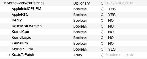

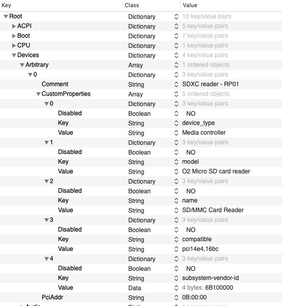

xdnuos Posted April 14, 2020 Share Posted April 14, 2020 Hi Open Core Project team ! I have a few questions related to patching process in general with Open Core. 1. What about (Clover) config.plist /Devices/Arbitrary ? One example is that on my Latitude E6530 I have O2 SD card reader 2. What about the Kernel and kext patches: AppleIntelCPUPM,Apple RTC... ? Example (Clover): Thanks for the excellent work that you people are doing. Link to comment https://www.insanelymac.com/forum/topic/350754-opencore-general-discussion/page/159/#findComment-2717351 Share on other sites More sharing options...
