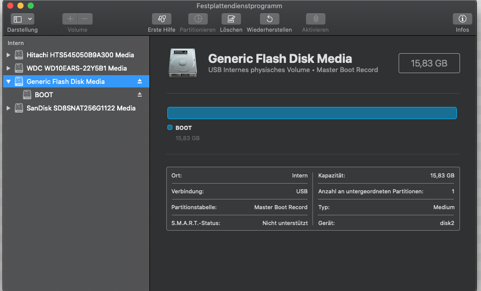

can0199 Posted April 18, 2020 Share Posted April 18, 2020 (edited) Hello folks, has some one an idea why my usb devices are recognized as intern storage ? I want to install windows via bootcamp this not working because the error "no external flash drive was found" occurs. after some research i realized that all usb 2.0 are recognized as "intern" my usb type c flash drive is recognized correctly but also not working on bootcamp ^^ thanks in advanced Edited April 18, 2020 by can0199 fix misspelling Link to comment https://www.insanelymac.com/forum/topic/350754-opencore-general-discussion/page/163/#findComment-2718070 Share on other sites More sharing options...

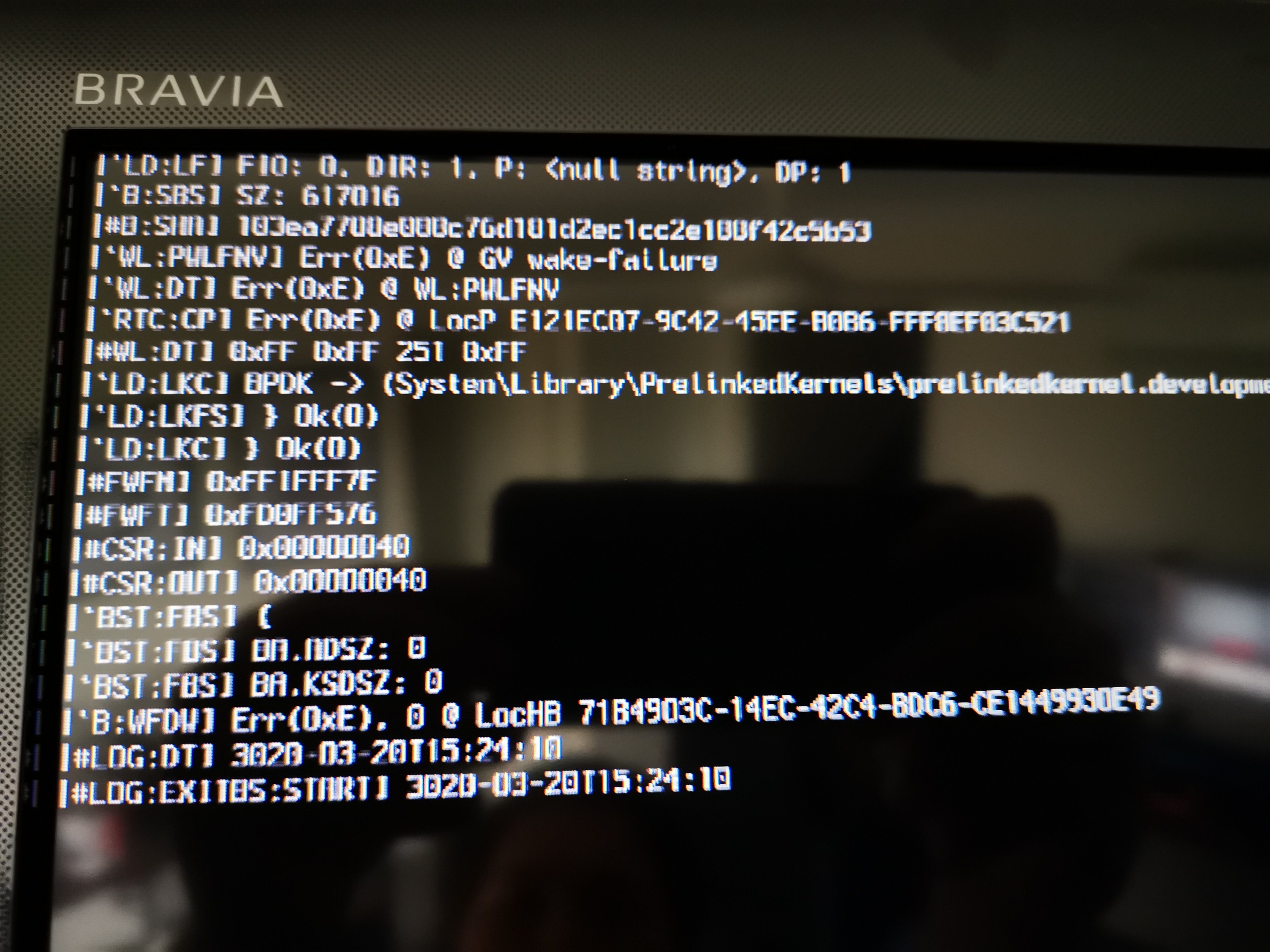

flashgear Posted April 19, 2020 Share Posted April 19, 2020 Hello guys, Long time lurker and finally took the plunge with OC on a i7 7700 and Gigabyte H110M-S2H. I'm pretty familiar with Clover and the like. Upon booting the installer, I get the attached screenshot error, not sure what to do with this? OC 5.6. Any assistance here please :) Link to comment https://www.insanelymac.com/forum/topic/350754-opencore-general-discussion/page/163/#findComment-2718151 Share on other sites More sharing options...

moozuki Posted April 19, 2020 Share Posted April 19, 2020 41 minutes ago, flashgear said: Hello guys, Long time lurker and finally took the plunge with OC on a i7 7700 and Gigabyte H110M-S2H. I'm pretty familiar with Clover and the like. Upon booting the installer, I get the attached screenshot error, not sure what to do with this? OC 5.6. Any assistance here please Been seeing this alot, on OC 0.5.7 since the last OS update. Only on the Ryzentosh, the skylake is on OC 0.5.6 with latest OS 10.15.4 SU with no such issue. I think it is coming from boot.efi and not OC though, not sure. Some times have to restart multiple times to get it to boot. Link to comment https://www.insanelymac.com/forum/topic/350754-opencore-general-discussion/page/163/#findComment-2718162 Share on other sites More sharing options...
mhaeuser Posted April 19, 2020 Share Posted April 19, 2020 @moozuki Borked Ryzen patches are off-topic. @flashgear Disable "MSR lock", "CPU CFG lock", or whatever the name is for your FW or, if unavailable, use the PowerManagement Kernel quirks Link to comment https://www.insanelymac.com/forum/topic/350754-opencore-general-discussion/page/163/#findComment-2718163 Share on other sites More sharing options...

flashgear Posted April 19, 2020 Share Posted April 19, 2020 Now I have a blank screen after I select "macOS - External" in the loader screen. Goes blank as soon I select it, where as my previous post above I could see the error text. Using an RX Vega 64, any ideas?? Link to comment https://www.insanelymac.com/forum/topic/350754-opencore-general-discussion/page/163/#findComment-2718176 Share on other sites More sharing options...
mikorist Posted April 19, 2020 Share Posted April 19, 2020 4 hours ago, flashgear said: Hello guys, Long time lurker and finally took the plunge with OC on a i7 7700 and Gigabyte H110M-S2H. I'm pretty familiar with Clover and the like. Upon booting the installer, I get the attached screenshot error, not sure what to do with this? OC 5.6. Any assistance here please I have same error - OC 0.5.7 - running macOS Catalina 10.15.4 install USB.... laptop G50-70 With 10.15.3 I have no errors 1 Link to comment https://www.insanelymac.com/forum/topic/350754-opencore-general-discussion/page/163/#findComment-2718177 Share on other sites More sharing options...

ammoune78 Posted April 19, 2020 Share Posted April 19, 2020 (edited) 7 hours ago, flashgear said: Hello guys, Long time lurker and finally took the plunge with OC on a i7 7700 and Gigabyte H110M-S2H. I'm pretty familiar with Clover and the like. Upon booting the installer, I get the attached screenshot error, not sure what to do with this? OC 5.6. Any assistance here please The best you can do is here, to fix and turn off CFG Lock manually. Then no need: AppleCpuPmCfgLock: Yes AppleXcpmCfgLoc: Yes I like this reply Edited April 19, 2020 by ammoune78 2 Link to comment https://www.insanelymac.com/forum/topic/350754-opencore-general-discussion/page/163/#findComment-2718194 Share on other sites More sharing options...
rottenpants Posted April 19, 2020 Share Posted April 19, 2020 47 minutes ago, ammoune78 said: The best you can do is here, to fix and turn off CFG Lock manually. Then no need: AppleCpuPmCfgLock: Yes AppleXcpmCfgLoc: Yes I like this reply On laptops its a pain.... In my case I can't turn off CFG Lock because my EUFI firmware is locked by the oem so I have to use those 2 quirks witch is not ideal... Don't know if it affects power management but hey at least I can boot Link to comment https://www.insanelymac.com/forum/topic/350754-opencore-general-discussion/page/163/#findComment-2718200 Share on other sites More sharing options...
ammoune78 Posted April 19, 2020 Share Posted April 19, 2020 9 minutes ago, rottenpants said: On laptops its a pain.... In my case I can't turn off CFG Lock because my EUFI firmware is locked by the oem so I have to use those 2 quirks witch is not ideal... Don't know if it affects power management but hey at least I can boot Yeah, oems are s*****g LapTop fimwares, nothing to do unless someone with same hardware found a trick. But in my case, no CFG Lock option on the firmware settings, this helped me to leave that screen and go to the next step . 1 Link to comment https://www.insanelymac.com/forum/topic/350754-opencore-general-discussion/page/163/#findComment-2718204 Share on other sites More sharing options...
