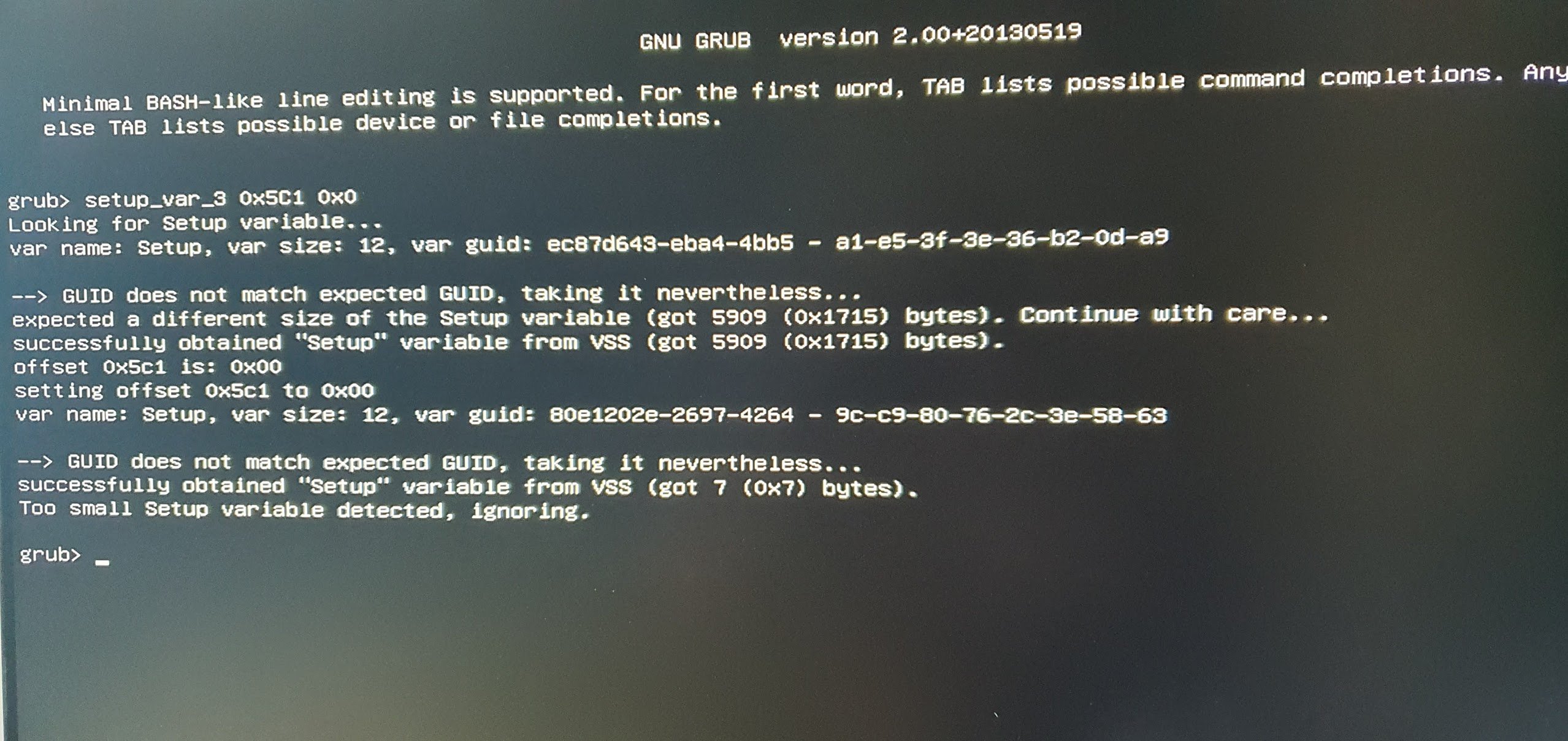

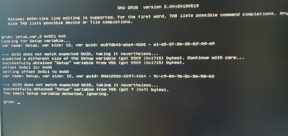

Disable AppleCpuPmCfgLock and AppleXcpmCfgLock from the config, then reboot and enter the offset value shown in your UEFI.rom from the Modified GRUB Shell, as shown in that guide.

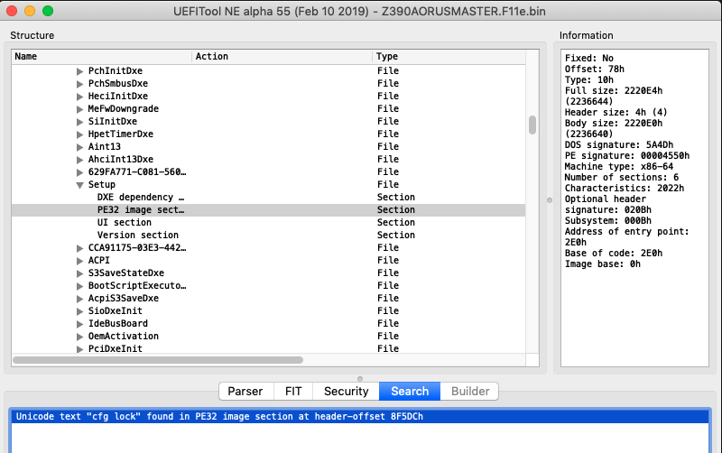

Take a screenshot of your bios opened by UEFITool, and searched for the CFG Lock word, need to know if you have one result from the search or 5
41 minutes ago, ammoune78 said:
What message?
What message ----> same as your screenshot in your post (sorry for my bad English)
UEFiTool show only one line for PE32 section. Screenshot and setup.txt attached
setup.txt
setup.txt
setup_var 0x5c1 0x00 is the current one that you need to do.

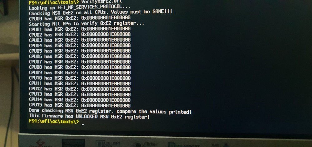

Also before to do that, you need to check with VerifyMsrE2.efi if your MoBo allow disabling CFG Lock or not, before doing that steps.

Check if your mobo has unlocked CFG or not:
Quote
If you got Offset xxxxx is 0x00, then it's already unlocked, if you've got 0x01 then you need to check:
Quote

The CFG Lock is now Unlocked, booting with the:
AppleCpuPmCfgLock: No
AppleXcpmCfgLoc: No
and the setup_var_3 0xxxx 0x00 is showing 0x00, get it unlocket.
Booting fine, just have to see if i'm doing a mistake in the config, need some work on it, and figure out what the problem. Also in the documentation, they say, need to re-check many times to know what we are doing. It's true, so many lines to check, then maybe, by mistake, we will forget something, it just need a patience!

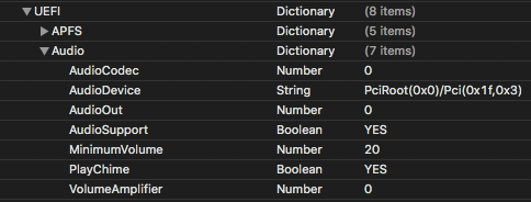

1 hour ago, alkemix said:
I can't hear the sounds in the pre-boot (in the OC boot menu), and yet I think I have set everything correctly:
opencore 0.5.8 nightly official
Please, Can You help me ?
Have you confirmed the correct address of your AudioDevice and codec?

5 minutes ago, SavageAUS said:
Have you confirmed the correct address of your AusdoDevice and codec?
Audiodevice is correct ( gfxutil -f HDEF  ),  audiocodec and audio out are indispensable, How do I know what the values are ?
