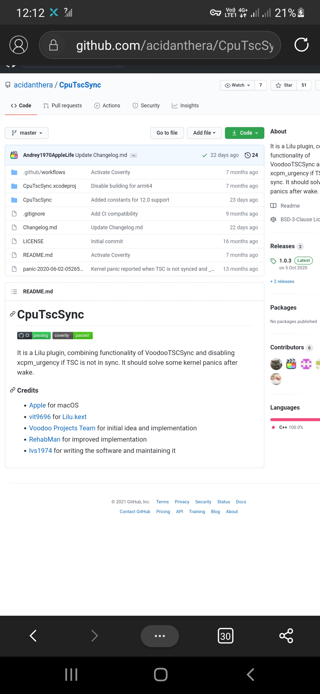

mnfesq Posted June 30, 2021 Share Posted June 30, 2021 (edited) 1 hour ago, ameenjuz said: VoodooTSCSync need for my system on big sur otherwise my laptop is slowdown from sleep after wake How to similar laptop i think you are using skylake cpu When i put to sleep my laptop then doesn't wake anymore until i force restart on macOS 12 just stuck black screen but cpu running during wake the screen is not come I have a Kabylake-R system. So I have an 8000 series cpu but UHD620 gpu. Yes, KP on wake from sleep is from no TSC sync. From what I have read, VoodooTSCSync does not work with Monterey. You may need to wait for an updated kext. Did you try using TSCAdjustReset? I was curious if it would work for you because it approaches the TSC no-sync problem differently than VoodooTSCSync. Also, regarding @Hervé's comment, you might try to remove VoodooTSCSync from your laptop and get wake from sleep to work in Catalina without the TSCSync kext. Do you have full XCPM function? I do, and I think that may be why I don't need a TSCSync kext. Edited June 30, 2021 by mnfesq Link to comment https://www.insanelymac.com/forum/topic/348725-pre-release-macos-monterey/page/27/#findComment-2762026 Share on other sites More sharing options...
ameenjuz Posted June 30, 2021 Share Posted June 30, 2021 31 minutes ago, mnfesq said: I have a Kabylake-R system. So I have an 8000 series cpu but UHD620 gpu. Yes, KP on wake from sleep is from no TSC sync. From what I have read, VoodooTSCSync does not work with Monterey. You may need to wait for an updated kext. Did you try using TSCAdjustReset? I was curious if it would work for you because it approaches the TSC no-sync problem differently than VoodooTSCSync. Also, regarding @Hervé's comment, you might try to remove VoodooTSCSync from your laptop and get wake from sleep to work in Catalina without the TSCSync kext. Do you have full XCPM function? I do, and I think that may be why I don't need a TSCSync kext. Thanks guys for replying I just have to wait for next beta of macOS 12 I used all three these kexts voodootsc tscadjust cputscsync no luck I don't know better why we need these kexts i think that kext need after wake from sleep for disabling xcpm_urgency if TSC is not in sync. It should solve some kernel panics after wake. soory for my poor english Explained here Spoiler Link to comment https://www.insanelymac.com/forum/topic/348725-pre-release-macos-monterey/page/27/#findComment-2762028 Share on other sites More sharing options...

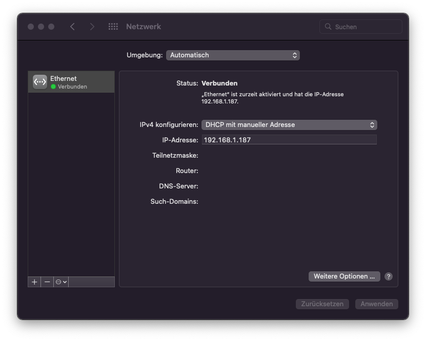

Guest 5T33Z0 Posted July 3, 2021 Share Posted July 3, 2021 (edited) Following this Discussion https://github.com/dortania/bugtracker/issues/213, I managed to get the I225-V Controller working on my Z490 Vision G Board in Monterey beta2… kinda… I had to manually assign the IP and set the Hardware manually to Speed 100baseTX, FullDuplex, Flow Control. Network Settings says, Ethernet is connected, but I cant get online. I get an no connection error Message in Safari. Anybody having an idea how to fix that? Edited July 3, 2021 by 5T33Z0 Link to comment https://www.insanelymac.com/forum/topic/348725-pre-release-macos-monterey/page/27/#findComment-2762202 Share on other sites More sharing options...

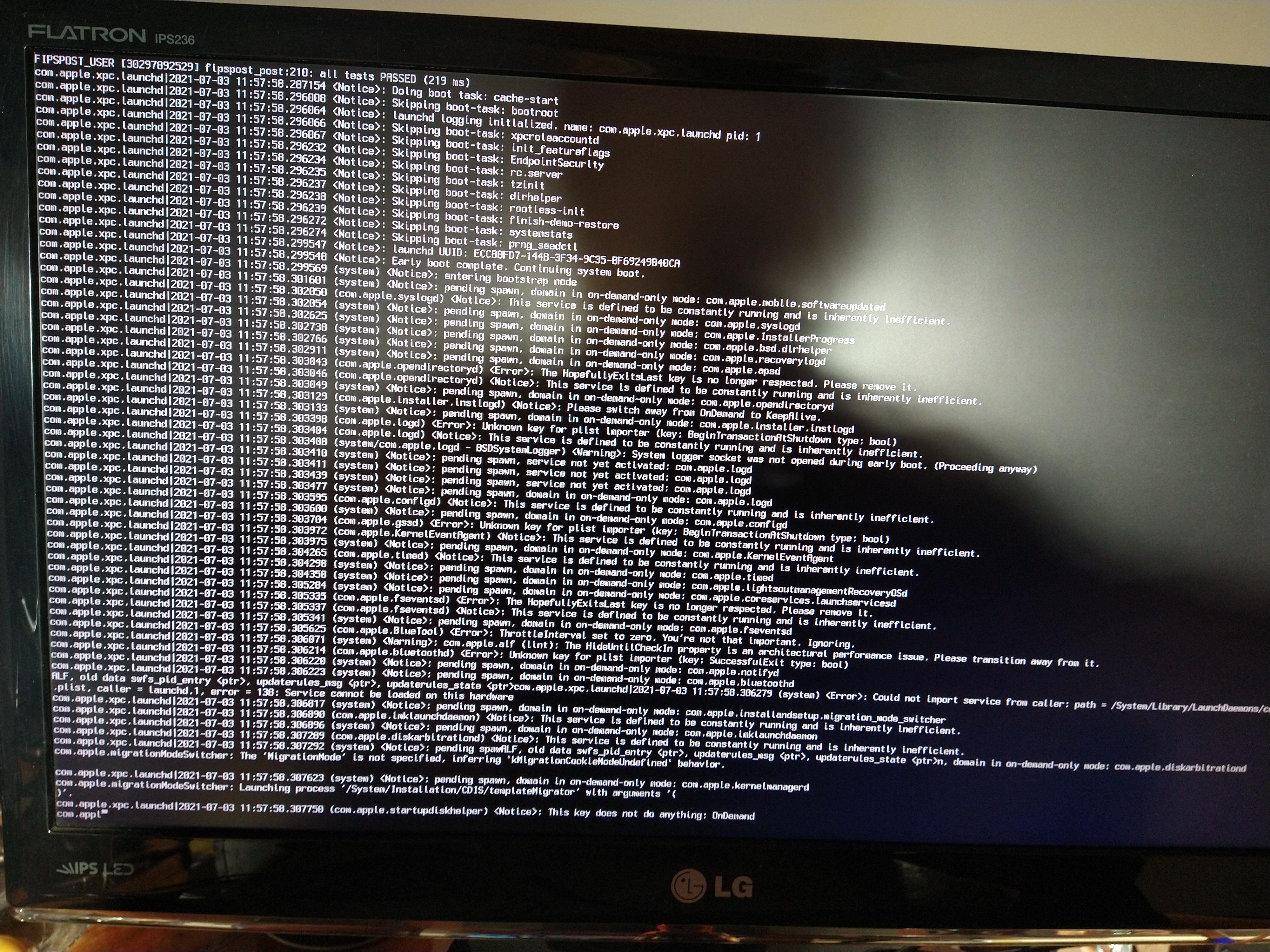

MacWill Posted July 3, 2021 Share Posted July 3, 2021 When rebooting after the update. What can it be? Link to comment https://www.insanelymac.com/forum/topic/348725-pre-release-macos-monterey/page/27/#findComment-2762205 Share on other sites More sharing options...
verleihnix Posted July 3, 2021 Share Posted July 3, 2021 43 minutes ago, MacWill said: When rebooting after the update. What can it be? try to disable securebootmodel 1 Link to comment https://www.insanelymac.com/forum/topic/348725-pre-release-macos-monterey/page/27/#findComment-2762207 Share on other sites More sharing options...

Henties Posted July 3, 2021 Share Posted July 3, 2021 @5T33Z0 I also still got the same problem as you described, with ethernet connecting but not able to use is at all. A slight improvement to the situation under Monterey beta 1. Greetings Henties. Link to comment https://www.insanelymac.com/forum/topic/348725-pre-release-macos-monterey/page/27/#findComment-2762209 Share on other sites More sharing options...
Guest 5T33Z0 Posted July 3, 2021 Share Posted July 3, 2021 (edited) 2 hours ago, MacWill said: When rebooting after the update. What can it be? Bluetooth… If you are using broadcom you need to BluetoolFixup in Monterey. Can be found in this here thread. Edited July 3, 2021 by 5T33Z0 Link to comment https://www.insanelymac.com/forum/topic/348725-pre-release-macos-monterey/page/27/#findComment-2762212 Share on other sites More sharing options...
