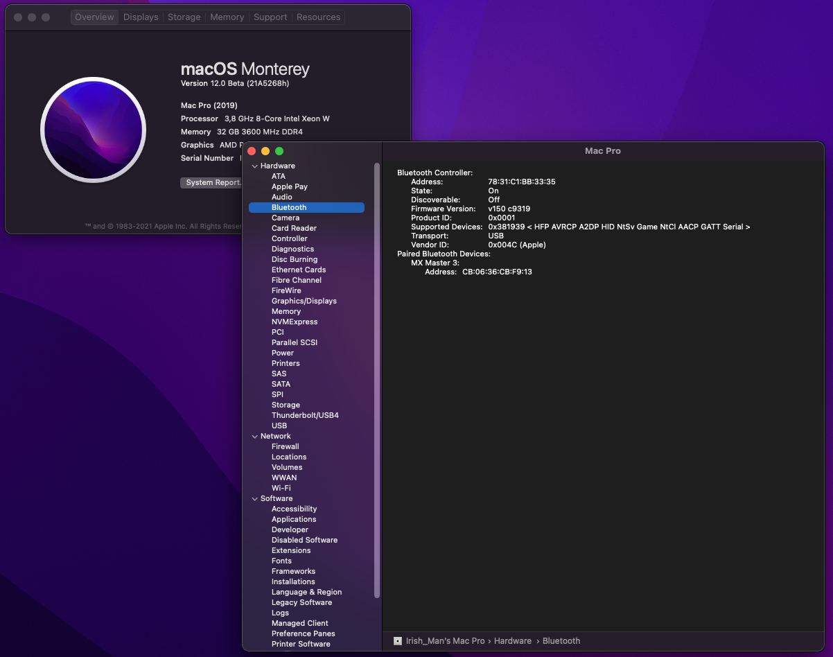

PG7 Posted June 28, 2021 Share Posted June 28, 2021 1 hour ago, greythorne said: Am running Monterey beta 1 on my hardware. When on Big Sur, bluetooth works by using IntelBluetoothFirmware. However, In Monterey bluetooth is not working. I even used a usb bluetooth dongle but still bluetooth not working. Anyone know what i can do? intel Wifi + intel Bluetooth Work a Monterey Spoiler Link to comment https://www.insanelymac.com/forum/topic/348725-pre-release-macos-monterey/page/22/#findComment-2761732 Share on other sites More sharing options...

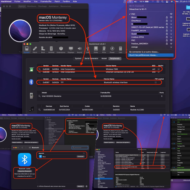

PG7 Posted June 28, 2021 Share Posted June 28, 2021 (edited) Bluetooth Intel & Wifi Intel a MonteRey tested Bluetooth intel = https://openintelwireless.github.io/IntelBluetoothFirmware/FAQ.html#what-does-this-kext-do Kext = IntelBluetoothFirmware.kext + BlueToolFixup.kext NO = IntelBluetoothInjector.kext = KernelPanic Monterey wifi Intel = https://github.com/OpenIntelWireless/itlwm/releases wifi intel x2 = https://github.com/1hbb/OpenIntelWireless-Factory wifi kext 1 = itlwm + Heliport = work = https://openintelwireless.github.io/HeliPort/#chat wifi kext 2 = Airportitlwm alpha = work = https://github.com/OpenIntelWireless/itlwm/releases Edited June 28, 2021 by PG7 Link to comment https://www.insanelymac.com/forum/topic/348725-pre-release-macos-monterey/page/22/#findComment-2761733 Share on other sites More sharing options...
greythorne Posted June 28, 2021 Share Posted June 28, 2021 14 minutes ago, PG7 said: intel Wifi + intel Bluetooth Work a Monterey Hide contents What? Howcome I am unable to run it? I am using the WiFi & Intelbluetooth kext from the same webpage you listed yet my bluetooth option on the bar is greyed. Link to comment https://www.insanelymac.com/forum/topic/348725-pre-release-macos-monterey/page/22/#findComment-2761734 Share on other sites More sharing options...
PG7 Posted June 28, 2021 Share Posted June 28, 2021 1 minute ago, greythorne said: What? Howcome I am unable to run it? I am using the WiFi & Intelbluetooth kext from the same webpage you listed yet my bluetooth option on the bar is greyed. 10 minutes ago, PG7 said: Bluetooth Intel & Wifi Intel a MonteRey tested Bluetooth intel = https://openintelwireless.github.io/IntelBluetoothFirmware/FAQ.html#what-does-this-kext-do Kext = IntelBluetoothFirmware.kext + BlueToolFixup.kext NO = IntelBluetoothInjector.kext = KernelPanic Monterey wifi Intel = https://github.com/OpenIntelWireless/itlwm/releases wifi intel x2 = https://github.com/1hbb/OpenIntelWireless-Factory wifi kext 1 = itlwm + Heliport = work = https://openintelwireless.github.io/HeliPort/#chat wifi kext 2 = Airportitlwm alpha = work = https://github.com/OpenIntelWireless/itlwm/releases follow what i marked Pay attention to only use what I marked because you cannot use the same method you used in Big Sur I've already tested everything I marked and it works as in the prints Hope this helps I use Google translator I hope the translation is comprehensive Link to comment https://www.insanelymac.com/forum/topic/348725-pre-release-macos-monterey/page/22/#findComment-2761735 Share on other sites More sharing options...
greythorne Posted June 28, 2021 Share Posted June 28, 2021 33 minutes ago, PG7 said: follow what i marked Pay attention to only use what I marked because you cannot use the same method you used in Big Sur I've already tested everything I marked and it works as in the prints Hope this helps I use Google translator I hope the translation is comprehensive How and where do i get the BlueToolFixup.kext? Do I need to compile myself or it is available? Link to comment https://www.insanelymac.com/forum/topic/348725-pre-release-macos-monterey/page/22/#findComment-2761739 Share on other sites More sharing options...
greythorne Posted June 28, 2021 Share Posted June 28, 2021 55 minutes ago, PG7 said: follow what i marked Pay attention to only use what I marked because you cannot use the same method you used in Big Sur I've already tested everything I marked and it works as in the prints Hope this helps I use Google translator I hope the translation is comprehensive Ok managed to get the bluetoolfix.kext from dortania. Got bluetooth working, however when logged in, i turned off but cannot turn on back. In Big Sur i can turn on/off any time. Link to comment https://www.insanelymac.com/forum/topic/348725-pre-release-macos-monterey/page/22/#findComment-2761740 Share on other sites More sharing options...
PG7 Posted June 28, 2021 Share Posted June 28, 2021 23 minutes ago, greythorne said: How and where do i get the BlueToolFixup.kext? Do I need to compile myself or it is available? BlueToolFixup.kext.zip 1 Link to comment https://www.insanelymac.com/forum/topic/348725-pre-release-macos-monterey/page/22/#findComment-2761741 Share on other sites More sharing options...
PG7 Posted June 28, 2021 Share Posted June 28, 2021 10 minutes ago, greythorne said: Ok managed to get the bluetoolfix.kext from dortania. Got bluetooth working, however when logged in, i turned off but cannot turn on back. In Big Sur i can turn on/off any time. yes you still have this problem but... you know it's still in precorse don't forget that we're only in the DEV Beta and that there's still a lot of work ahead for the devs to put everything more or less functional correctly. this first step is already working just cannot turn it off you have to use github and see each commit what they repair and test ! google translate 1 Link to comment https://www.insanelymac.com/forum/topic/348725-pre-release-macos-monterey/page/22/#findComment-2761743 Share on other sites More sharing options...

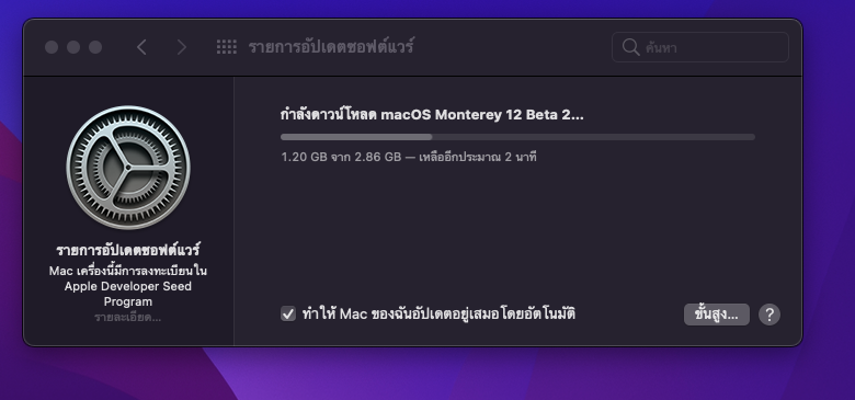

naiclub Posted June 28, 2021 Share Posted June 28, 2021 (edited) Why can't OC update? Now use CLOVER to update instead. Can anyone help me answer? uh, why is it so much faster than the first beta? Edited June 28, 2021 by naiclub 1 1 Link to comment https://www.insanelymac.com/forum/topic/348725-pre-release-macos-monterey/page/22/#findComment-2761766 Share on other sites More sharing options...
Djlild7hina Posted June 28, 2021 Share Posted June 28, 2021 Beta 2 not installing on ASUS X299. keeps kicking me back to beta 1 3 Link to comment https://www.insanelymac.com/forum/topic/348725-pre-release-macos-monterey/page/22/#findComment-2761774 Share on other sites More sharing options...

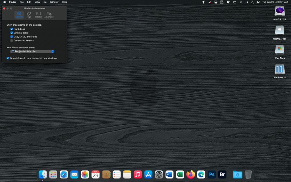

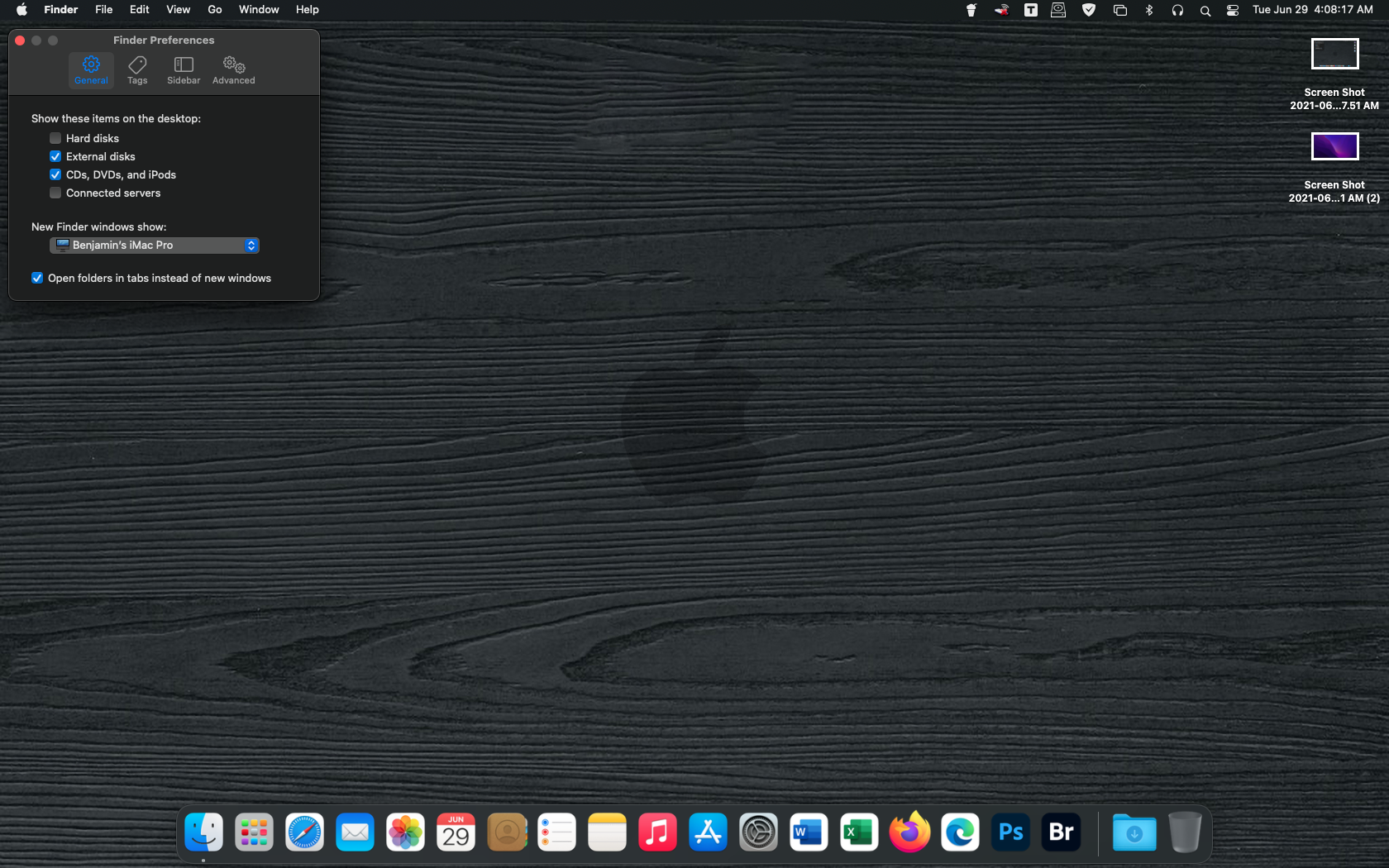

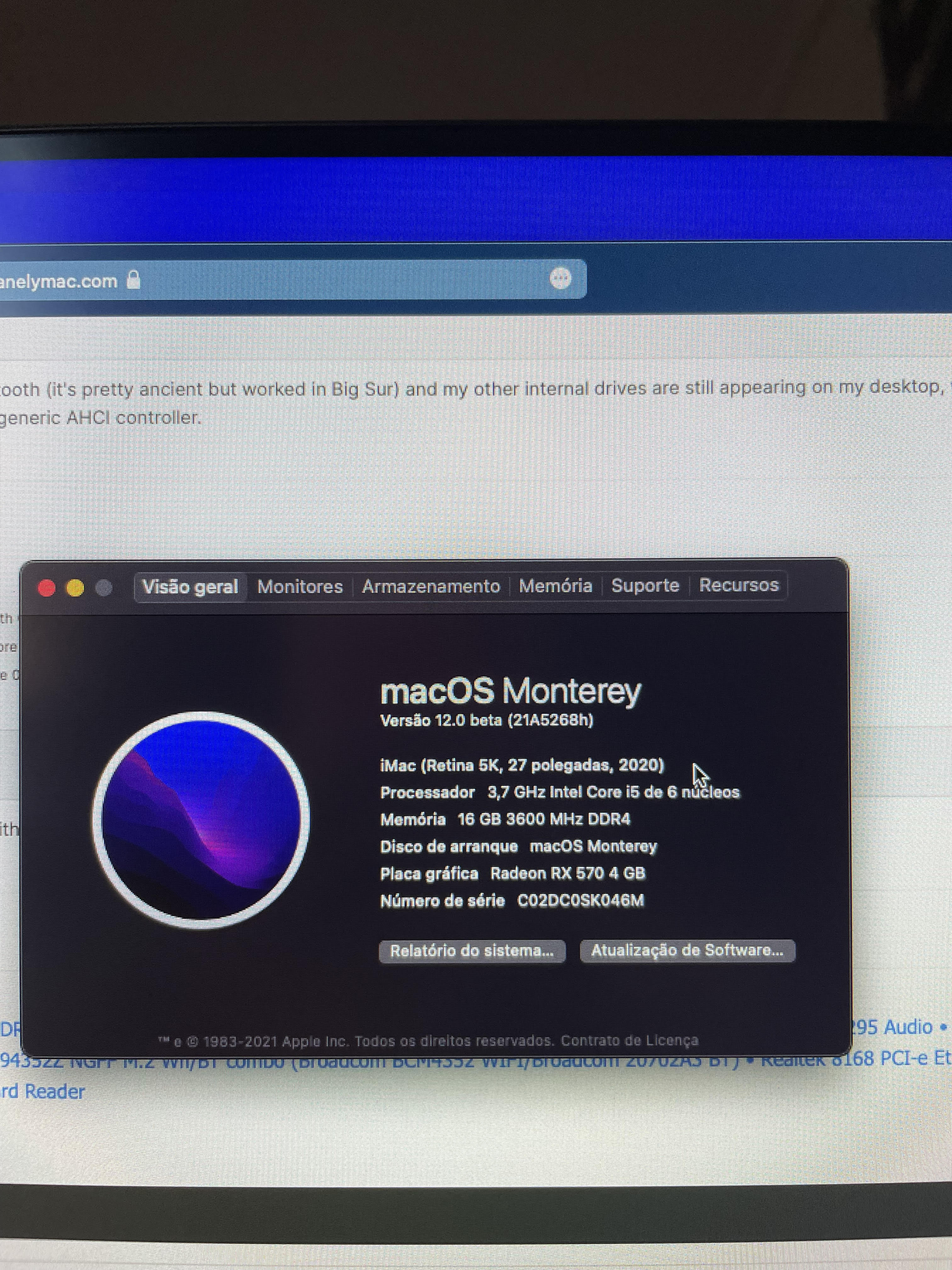

Riley Freeman Posted June 28, 2021 Share Posted June 28, 2021 Updated without any trouble here. Graphics card is now displayed in the ATM screen. Still no bluetooth (it's pretty ancient but worked in Big Sur) and my other internal drives are still appearing on my desktop, with some of them having eject icons in the Finder sidebar (despite being non-removable). I guess something has changed in the generic AHCI controller. 2 Link to comment https://www.insanelymac.com/forum/topic/348725-pre-release-macos-monterey/page/22/#findComment-2761775 Share on other sites More sharing options...

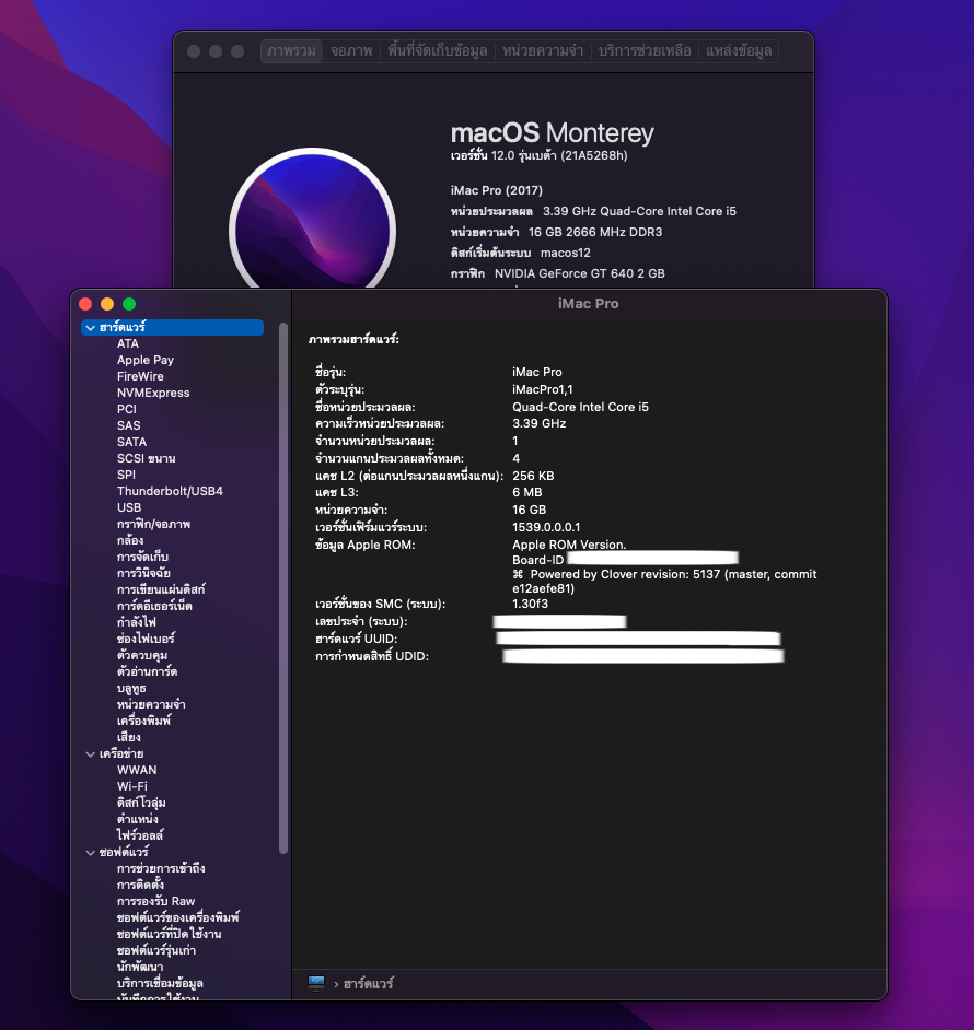

mnfesq Posted June 28, 2021 Share Posted June 28, 2021 I couldn't get beta 2 to install using OC .71 but it installed just fine with Clover 5137. Same thing with bluetooth. Works fine with Clover, not so with OC. Still working on getting it to work with OC. 4 Link to comment https://www.insanelymac.com/forum/topic/348725-pre-release-macos-monterey/page/22/#findComment-2761777 Share on other sites More sharing options...

mnfesq Posted June 28, 2021 Share Posted June 28, 2021 5 minutes ago, MorenoAv said: Hi @mnfesq what bluetooth do you have? I have an Fenvi T- 919 and I can't make It work with OC 0.7.1, I tried everything, but I managed to install Monterey Beta 2, with OC... Thanks I have this module: [0a5c:216f] Dell DW1560 4352+20702 M.2 My problem using OC to install beta 2 is that it would not complete the installation process after the first reboot and the MacintoshHD would never disappear from the OC boot menu. Booting up repeatedly from MacintoshHD did not do anything and booting from the drive with Monterey on it just took me back to beta 1. Mid-installation, I switched from OC to Clover, booted up to MacintoshHD, allowed it to install completely and upon reboot, MacintoshHD was gone from the Clover menu and the installation completed successfully booting to my Monterey partition (taking 2 reboots to complete). 3 Link to comment https://www.insanelymac.com/forum/topic/348725-pre-release-macos-monterey/page/22/#findComment-2761782 Share on other sites More sharing options...
naiclub Posted June 28, 2021 Share Posted June 28, 2021 8 minutes ago, mnfesq said: I have this module: [0a5c:216f] Dell DW1560 4352+20702 M.2 My problem using OC to install beta 2 is that it would not complete the installation process after the first reboot and the MacintoshHD would never disappear from the OC boot menu. Booting up repeatedly from MacintoshHD did not do anything and booting from the drive with Monterey on it just took me back to beta 1. Mid-installation, I switched from OC to Clover, booted up to MacintoshHD, allowed it to install completely and upon reboot, MacintoshHD was gone from the Clover menu and the installation completed successfully booting to my Monterey partition (taking 2 reboots to complete). In my case, OC 0.71 does not detect any updates. do it many times until I have to go back to use CLOVER Link to comment https://www.insanelymac.com/forum/topic/348725-pre-release-macos-monterey/page/22/#findComment-2761783 Share on other sites More sharing options...

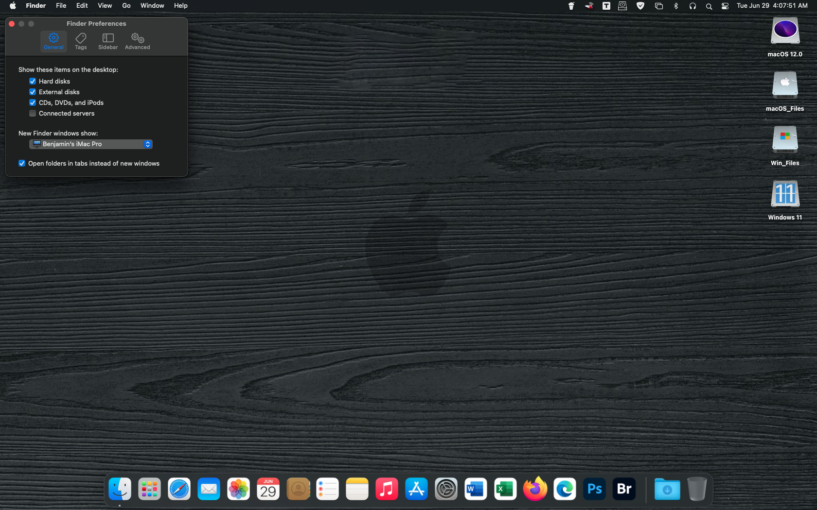

bisdak4920 Posted June 28, 2021 Share Posted June 28, 2021 For my setup, issues in Beta 1, boot delay, windows ssd appearing as external disk, are now gone. For me this build is as stable as Big Sur. 1 1 Link to comment https://www.insanelymac.com/forum/topic/348725-pre-release-macos-monterey/page/22/#findComment-2761787 Share on other sites More sharing options...
