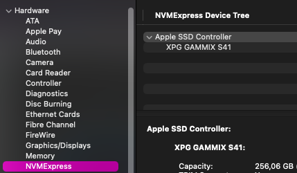

LockDown Posted July 9, 2021 Share Posted July 9, 2021 (edited) Purely cosmetic i guess @tonyx86 unless you fake the ID. All i did is changed the plist from Generic to Apple and up the IOPROBE then made an injector. Someone wrote a better method by using device>properties, but got deleted because of being off topic maybe 😁 Edited July 9, 2021 by ellaosx 1 Link to comment https://www.insanelymac.com/forum/topic/348725-pre-release-macos-monterey/page/30/#findComment-2762534 Share on other sites More sharing options...
miliuco Posted July 9, 2021 Share Posted July 9, 2021 (edited) @ellaosx Yesterday the forum was down for a while. I think your post was deleted in that period of time. And yes it’s cosmetic. Edited July 9, 2021 by miliuco 1 1 Link to comment https://www.insanelymac.com/forum/topic/348725-pre-release-macos-monterey/page/30/#findComment-2762535 Share on other sites More sharing options...
verleihnix Posted July 9, 2021 Share Posted July 9, 2021 7 hours ago, ellaosx said: Purely cosmetic i guess @tonyx86 unless you fake the ID. All i did is changed the plist from Generic to Apple and up the IOPROBE then made an injector. Someone wrote a better method by using device>properties, but got deleted because of being off topic maybe 😁 <key>PciRoot(0x0)/Pci(0x1,0x1)/Pci(0x0,0x0)</key> <dict> <key>AAPL,slot-name</key> <string>Built In</string> <key>IOName</key> <string>pci144d,a806</string> <key>built-in</key> <string>NVMe SSD</string> <key>compatible</key> <string>pci144d,a806</string> <key>device-id</key> <data> BqgAAA== </data> <key>device_type</key> <string>Storage Controller</string> <key>model</key> <string>Apple NVMe M2 Flash Drive</string> <key>name</key> <string>pci144d,a806</string> <key>revision-id</key> <data> AAAAAA== </data> <key>subsystem-id</key> <data> AagAAA== </data> <key>subsystem-vendor-id</key> <data> TRQAAA== </data> <key>vendor-id</key> <data> TRQAAA== </data> </dict> 2 2 Link to comment https://www.insanelymac.com/forum/topic/348725-pre-release-macos-monterey/page/30/#findComment-2762536 Share on other sites More sharing options...
apfelnico Posted July 9, 2021 Share Posted July 9, 2021 On 7/8/2021 at 6:11 AM, ellaosx said: Hello Does anyone know how to change the NVME to be seen as Apple SSD Controller instead of Generic SSD Controller? Thanks! It works like this too: https://www.hackintosh-forum.de/forum/thread/54361-nvmexpress-apple-ssd-controller/?postID=708868#post708868 4 Link to comment https://www.insanelymac.com/forum/topic/348725-pre-release-macos-monterey/page/30/#findComment-2762541 Share on other sites More sharing options...
Stefanalmare Posted July 9, 2021 Share Posted July 9, 2021 3 hours ago, apfelnico said: It works like this too: https://www.hackintosh-forum.de/forum/thread/54361-nvmexpress-apple-ssd-controller/?postID=708868#post708868 Can you share this kext? Link to comment https://www.insanelymac.com/forum/topic/348725-pre-release-macos-monterey/page/30/#findComment-2762553 Share on other sites More sharing options...
apfelnico Posted July 9, 2021 Share Posted July 9, 2021 3 hours ago, Stefanalmare said: Can you share this kext? Tested with macOS Monterey. The Kernel Extension is attached, but you still need to adapt the parameter "IOPCIPRIMARYMATCH" to your controller. X299NVMe.kext.zip 4 1 Link to comment https://www.insanelymac.com/forum/topic/348725-pre-release-macos-monterey/page/30/#findComment-2762569 Share on other sites More sharing options...
Stefanalmare Posted July 9, 2021 Share Posted July 9, 2021 37 minutes ago, apfelnico said: Tested with macOS Monterey. The Kernel Extension is attached, but you still need to adapt the parameter "IOPCIPRIMARYMATCH" to your controller. X299NVMe.kext.zip 3.31 kB · 4 downloads It work. Thank you! 1 Link to comment https://www.insanelymac.com/forum/topic/348725-pre-release-macos-monterey/page/30/#findComment-2762572 Share on other sites More sharing options...
miliuco Posted July 9, 2021 Share Posted July 9, 2021 Thanks @apfelnico and @verleihnix both methods work well. Adapted to WD Black SN750 (15b7:5002). 2 Link to comment https://www.insanelymac.com/forum/topic/348725-pre-release-macos-monterey/page/30/#findComment-2762577 Share on other sites More sharing options...
MacWill Posted July 9, 2021 Share Posted July 9, 2021 28 minutes ago, miliuco said: Thanks @apfelnico and @verleihnix both methods work well. Adapted to WD Black SN750 (15b7:5002). And on another Motherboard as: Gigabyte Z590 Vision G? Link to comment https://www.insanelymac.com/forum/topic/348725-pre-release-macos-monterey/page/30/#findComment-2762580 Share on other sites More sharing options...
miliuco Posted July 9, 2021 Share Posted July 9, 2021 2 hours ago, MacWill said: And on another Motherboard as: Gigabyte Z590 Vision G? Ok, I have the Apfelnico kext, named X299NVMe.kext. I click on the file > Show package content > Contents > open Info.pist. There is a line IOPCIPrimaryMatch, here I have put the vendor-device id of the NVMe disk, not of the mobo. I have 2 M2 disks, both of them are WD SN750 but each one has a different device id > 15b7:5002 and 15b7:5006. In the IOPCIPrimaryMatch line (string) I have writed the 2 values, separated by a space, reversed bytes (first device and then vendor): 0x500215b7 0x500615b7. How do you know vendor and device id of the M2 disk (or disks)? I have looked at Hackintool > PCIe and here it is easy to see these data. 2 1 Link to comment https://www.insanelymac.com/forum/topic/348725-pre-release-macos-monterey/page/30/#findComment-2762590 Share on other sites More sharing options...
MacWill Posted July 9, 2021 Share Posted July 9, 2021 1 hour ago, miliuco said: Ok, I have the Apfelnico kext, named X299NVMe.kext. I click on the file > Show package content > Contents > open Info.pist. There is a line IOPCIPrimaryMatch, here I have put the vendor-device id of the NVMe disk, not of the mobo. I have 2 M2 disks, both of them are WD SN750 but each one has a different device id > 15b7:5002 and 15b7:5006. In the IOPCIPrimaryMatch line (string) I have writed the 2 values, separated by a space, reversed bytes (first device and then vendor): 0x500215b7 0x500615b7. How do you know vendor and device id of the M2 disk (or disks)? I have looked at Hackintool > PCIe and here it is easy to see these data. Perfect! 1 Link to comment https://www.insanelymac.com/forum/topic/348725-pre-release-macos-monterey/page/30/#findComment-2762593 Share on other sites More sharing options...

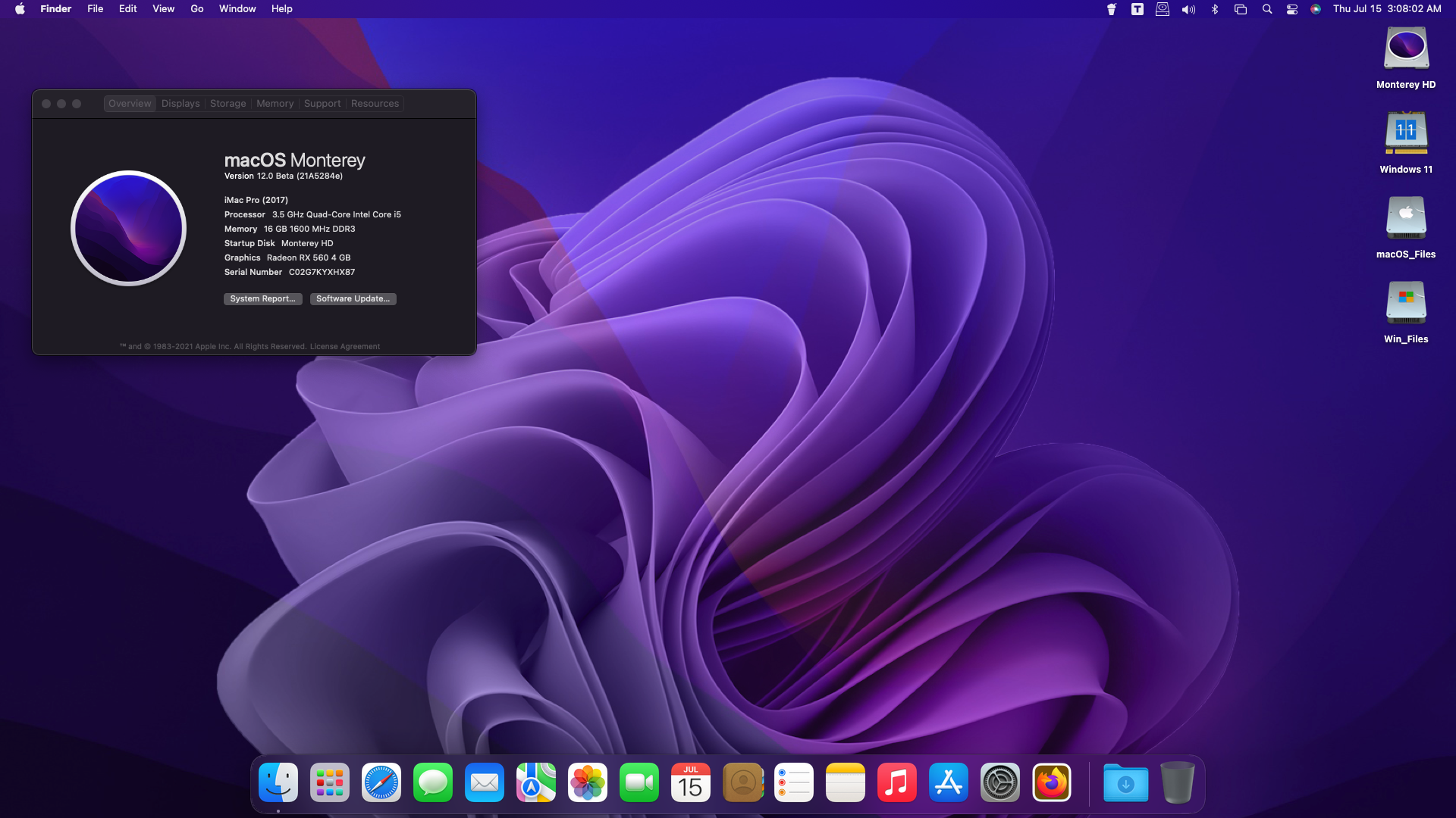

Shaneee Posted July 14, 2021 Share Posted July 14, 2021 I'm getting "Still waiting for root device error" with beta 3 for some reason. Monterey is on a Crucial MX500 SSD. Anyone faced anything similar? There's NVMe load errors during verbose too even though the two NVMe drives house Big Sur and Windows 11. Beta 2 works wonderfully. 1 Link to comment https://www.insanelymac.com/forum/topic/348725-pre-release-macos-monterey/page/30/#findComment-2762867 Share on other sites More sharing options...
Stefanalmare Posted July 14, 2021 Share Posted July 14, 2021 6 minutes ago, Shaneee said: I'm getting "Still waiting for root device error" with beta 3 for some reason. Monterey is on a Crucial MX500 SSD. Anyone faced anything similar? There's NVMe load errors during verbose too even though the two NVMe drives house Big Sur and Windows 11. Beta 2 works wonderfully. Try this. Put your IOPCIPrimaryMatch. X299NVMe.kext.zip Link to comment https://www.insanelymac.com/forum/topic/348725-pre-release-macos-monterey/page/30/#findComment-2762868 Share on other sites More sharing options...
