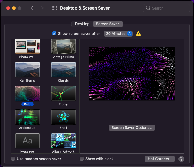

Middleman Posted June 17, 2021 Share Posted June 17, 2021 Not quite working on my Z170. Seems the biggest issue I have at the moment is display wake from sleep - once the system goes to sleep, nothing that I do seems to wake it up. Link to comment https://www.insanelymac.com/forum/topic/348725-pre-release-macos-monterey/page/17/#findComment-2761054 Share on other sites More sharing options...
Middleman Posted June 17, 2021 Share Posted June 17, 2021 Okay I seemed to have partially resolve this. I found what seems to be a warning of sorts in the screensaver section indicating that the display will go to sleep before the screensaver will kick in: When I set this to 1 min, my display could finally wake from sleep. Separate to this I also found a potential fix from Dortania guide, in the form of adding the CFG,CFG_USE_AGDC key to GPU's device properties in EFI. Link to comment https://www.insanelymac.com/forum/topic/348725-pre-release-macos-monterey/page/17/#findComment-2761055 Share on other sites More sharing options...
Stefanalmare Posted June 17, 2021 Share Posted June 17, 2021 17 minutes ago, Middleman said: Okay I seemed to have partially resolve this. I found what seems to be a warning of sorts in the screensaver section indicating that the display will go to sleep before the screensaver will kick in: When I set this to 1 min, my display could finally wake from sleep. Separate to this I also found a potential fix from Dortania guide, in the form of adding the CFG,CFG_USE_AGDC key to GPU's device properties in EFI. Set screen saver start time lower than sleep display. Link to comment https://www.insanelymac.com/forum/topic/348725-pre-release-macos-monterey/page/17/#findComment-2761058 Share on other sites More sharing options...
