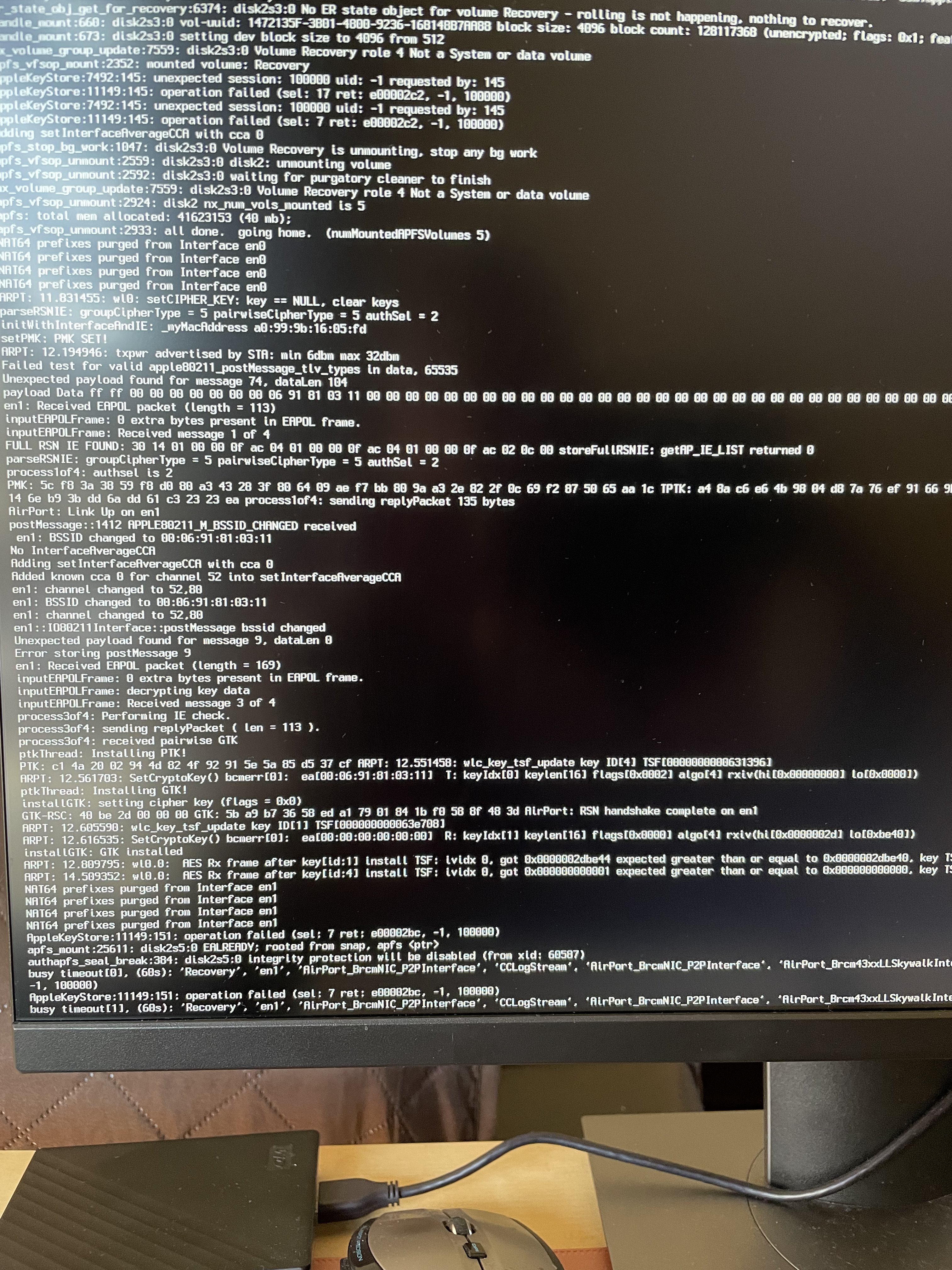

54 minutes ago, MorenoAv said:
Hi guys,
macOS Monterey is a pita, today at first boot, it didn't boot again, I don't know why.
The only way for it to boot was with the usb installer, and it boots fine, anyone could tell me what is wrong?
Thanks
put your OC
it strikes me as something with kext Wifi
1 - block WIFI kext to test boot
2 - deletes the Quirks Patch XHCI limit as it has mapped kext
3 - update the kext such as lilu, whatevergreen, alc and VirtualSMC for the latest one and delete the lilubetaall and other beta args
i'm using google translate
  • Thanks 1

now if any acidanthera developer reads, it would serve something similar to BlueToolFixup also for AirportBrcmFixup that blocks the monterey boot, even using last compiled release

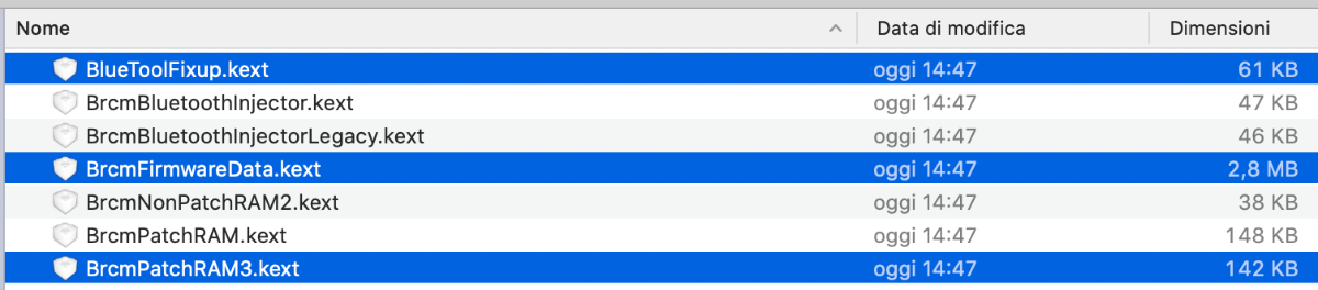

17 hours ago, mnfesq said:
Would you mind posting your compiled BluetoolFixup.kext.  I couldn't get it to compile because I have a bunch of missing files and am too lazy to find and download them but not too lazy to ask you to post your work. :)
Sorry for late reply
I attached my compiled file
use BlueToolFixup.kext BrcmFirmwareData.kext BrcmPatchRAM3.kext for Monterey 12
These above 3 kexts require to work bluetooth
I m using Broadcom Bcm94352z
Remember do not use BrcmBluetoothInjector.kext for Monterey 12
BrcmPatchRAM-2.6.0-RELEASE.zip
  • Thanks 1

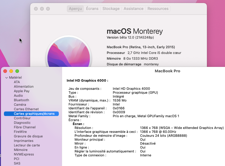

On 6/12/2021 at 1:08 PM, asdesoso said:
Hi @chris1111 there is great news for our HD 4000 laptops, it seems that HD 4000 can now boot up and enable QE/CI with Metal in Monterey.
https://forums.macrumors.com/threads/macos-12-monterey-on-unsupported-macs-thread.2299557/post-30008993
Cheers.
Done HP Probook 6570 b
Program for HP Probook is ready Monterey 12
Read Readme Monterey 12 EN.pdf before
Enjoy
  • Like 6
Thank you so much. Your kext made my USB BT CSR 8510 working again which was normally working OOB till Big Sur.
