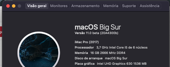

corint1 Posted July 8, 2020 Share Posted July 8, 2020 1 minute ago, dvil said: I have the exact same problem. I've tried all the combinations that I can think off (beta1, beta 2, different OC builds, parameters and kexts combinations) with no success so far. Any hint to solve this problem is very welcome post yor config.plist Link to comment https://www.insanelymac.com/forum/topic/344428-pre-release-macos-big-sur/page/15/#findComment-2729350 Share on other sites More sharing options...
Alex HQuest Posted July 8, 2020 Share Posted July 8, 2020 5 minutes ago, manmo71 said: I have everything working, Graphics both Radeon RX580 and the headless iGPU, audio, USB, WiFi and bluetooth. Does your system plays DRM content (Netflix/Prime Video/Apple TV+)? If so, which kext's and/or boot-args are you using? Link to comment https://www.insanelymac.com/forum/topic/344428-pre-release-macos-big-sur/page/15/#findComment-2729351 Share on other sites More sharing options...
manmo71 Posted July 8, 2020 Share Posted July 8, 2020 Just now, Alex HQuest said: Does your system plays DRM content (Netflix/Prime Video/Apple TV+)? If so, which kext's and/or boot-args are you using? @Alex HQuest I have not tried that as I do not use any of them, but I do have Prime Video. Shall try and update you. 1 Link to comment https://www.insanelymac.com/forum/topic/344428-pre-release-macos-big-sur/page/15/#findComment-2729354 Share on other sites More sharing options...

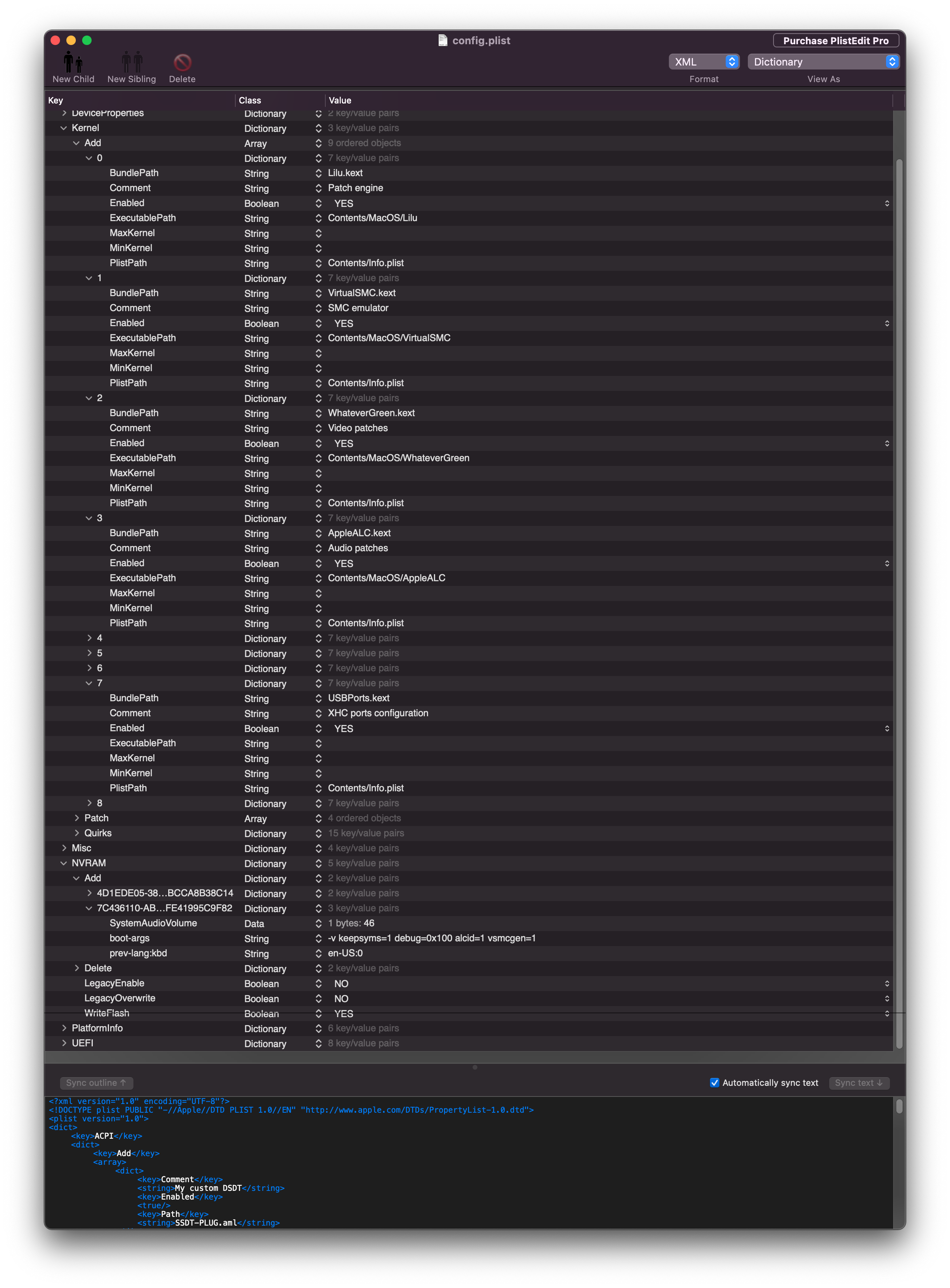

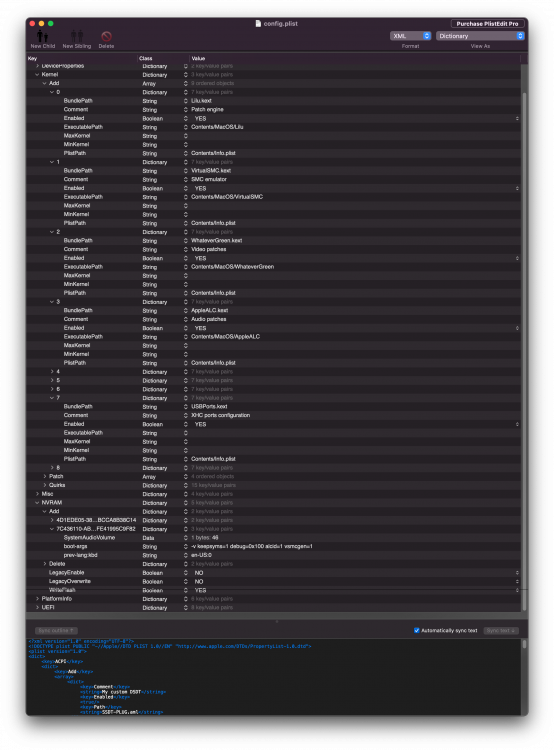

manmo71 Posted July 8, 2020 Share Posted July 8, 2020 (edited) 14 minutes ago, Alex HQuest said: Does your system plays DRM content (Netflix/Prime Video/Apple TV+)? If so, which kext's and/or boot-args are you using? @Alex HQuest I just checked out Prime Video and it works fine. No issues. Here is the screenshot of my config.plist, it includes the kernel section to show you the kexts that I am loading and also the NVRAM section to see the boot-args for yourself if this helps. If you are attempting to install from a USB, just ensure that you do the following in order RESET NVRAM On reboot Select the boot device as OPENCORE Now choose macOS BETA INSTALL I trust things will go smooth. Spoiler Edited July 8, 2020 by manmo71 Some additional info 1 Link to comment https://www.insanelymac.com/forum/topic/344428-pre-release-macos-big-sur/page/15/#findComment-2729357 Share on other sites More sharing options...

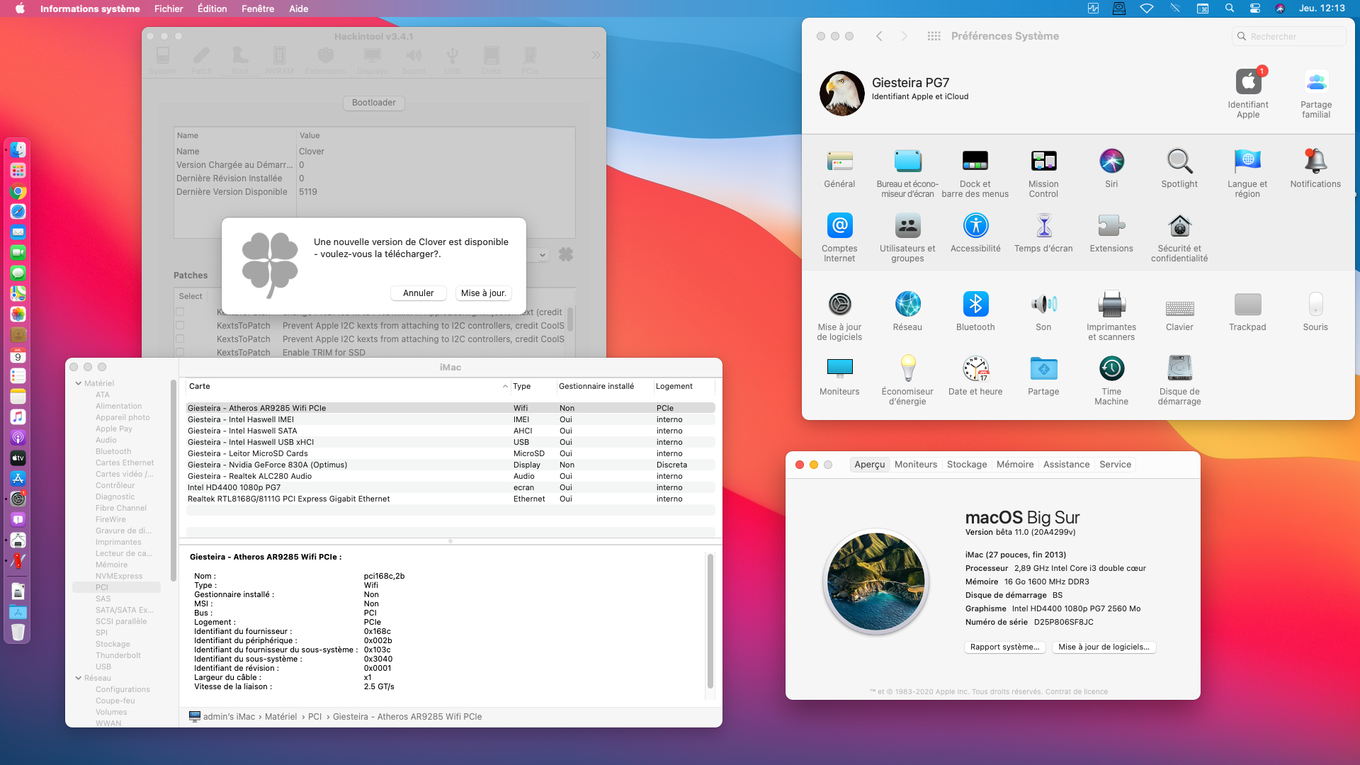

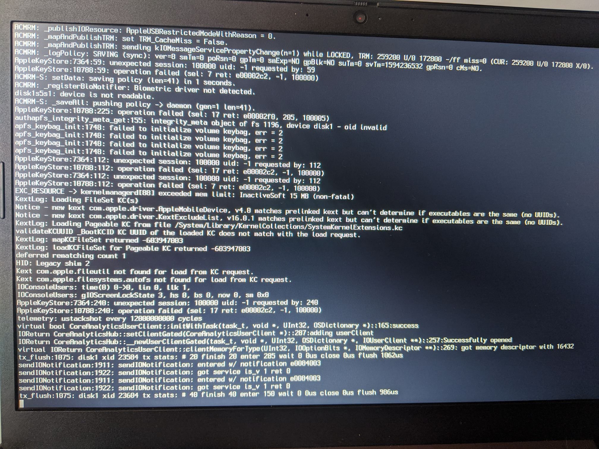

PG7 Posted July 8, 2020 Share Posted July 8, 2020 hello, installation of BigSur Beta Dev 1 and 2 from a USB installer. - the first part passes (3 minutes) restarts, part 2 (29 minutes stays for a long time in "less than 1 minute") then restarts and then we have the problem !!! impossible to enter from that state 3! I've tested everything between the latest kext and the last OpenCore but nothing works! I tested both on the Broadwell HP EliteBook 820 G2 intel core i5-5300U hd 5500 chip = USB error but with the restoration of the image dmg to the HDD the OpenCore Boot works on BigSur and also on Catalina! tested on HP Probook 430 G2 intel i3-5010U HD5500 same result as the first one (boot OK with BigSur restored from an image dmg and on Catalina this is also OK) lastly tested also on the ivy bridge Dell Vostro 2520 intel i3-3110M HD4000 in this I go further with all the steps but at the second reboot (after installation) it simply gives me a display and reboot error I haven't seen anyone anywhere that has successfully installed one of these chips any tips or even resolution, opinions to be able to test I will be willing to do it; sure already for me and other community thank you all sorry my weak english because i am using google translator, Languages I know Portuguese and Français Link to comment https://www.insanelymac.com/forum/topic/344428-pre-release-macos-big-sur/page/15/#findComment-2729367 Share on other sites More sharing options...
manmo71 Posted July 8, 2020 Share Posted July 8, 2020 (edited) Spoiler @pg7 add in boot-args vsmcgen=1 If you are attempting to install from a USB, just ensure that you do the following in order RESET NVRAM On reboot Select the boot device as OPENCORE Now choose macOS BETA INSTALL Try a fresh install again. I too was stuck like you, finally got it to work.... Edited July 8, 2020 by manmo71 Link to comment https://www.insanelymac.com/forum/topic/344428-pre-release-macos-big-sur/page/15/#findComment-2729368 Share on other sites More sharing options...
Andrey1970 Posted July 8, 2020 Share Posted July 8, 2020 8 minutes ago, manmo71 said: add in boot-args vsmcgen=1 vsmcgen=1 not needed with last Lilu from the master. 4 Link to comment https://www.insanelymac.com/forum/topic/344428-pre-release-macos-big-sur/page/15/#findComment-2729369 Share on other sites More sharing options...

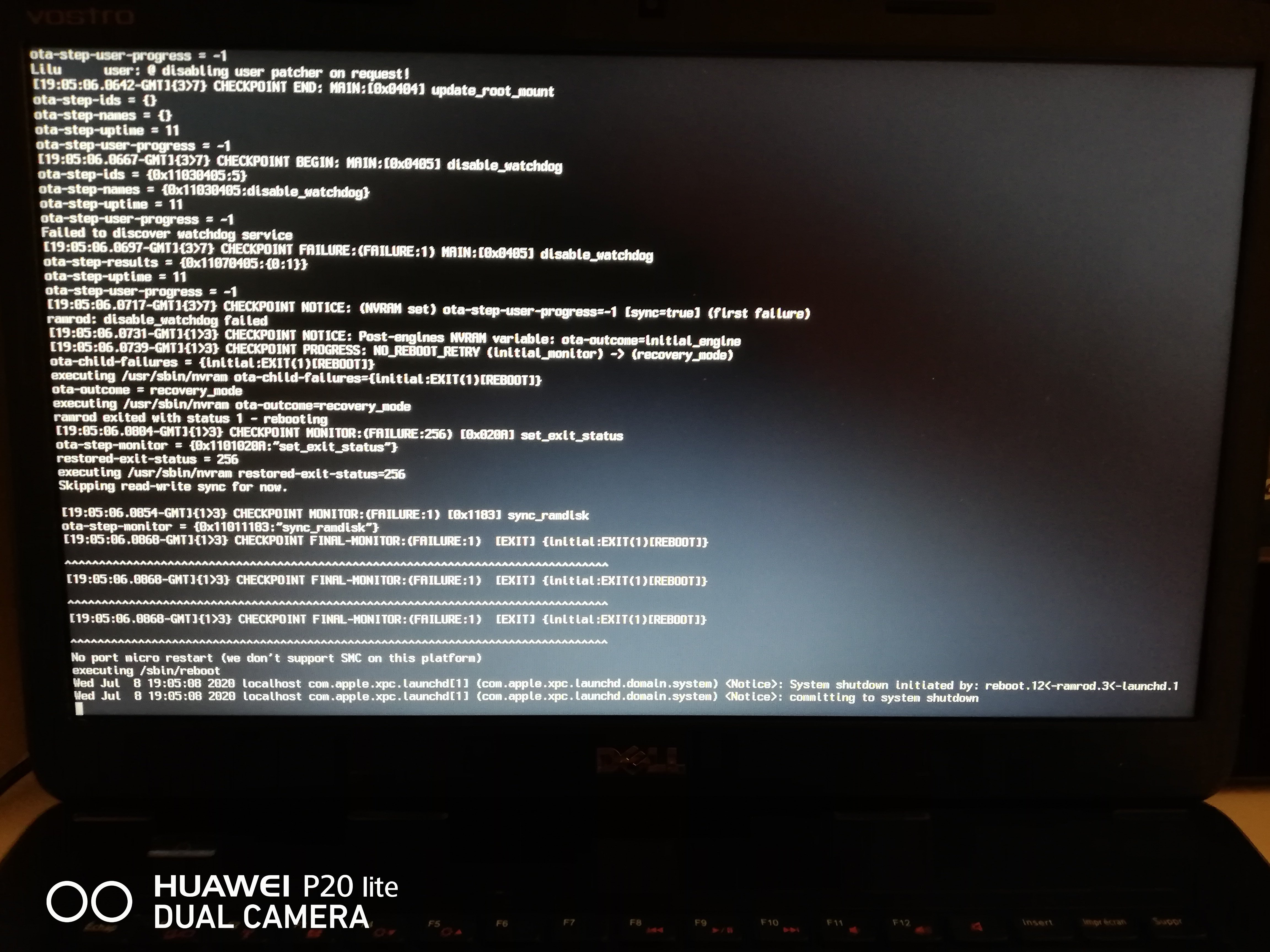

DarkNeptune0 Posted July 8, 2020 Share Posted July 8, 2020 After the 3 minutes the computer reboots, I choose the data partition and after some time it stops here: is this normal or do you have to start again? Link to comment https://www.insanelymac.com/forum/topic/344428-pre-release-macos-big-sur/page/15/#findComment-2729371 Share on other sites More sharing options...

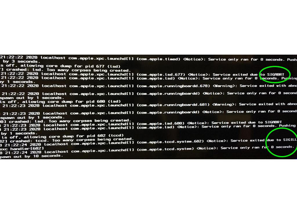

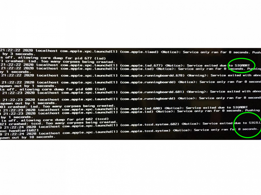

Rocky12 Posted July 8, 2020 Share Posted July 8, 2020 I'm trying to boot from Clover mod Big Sur beta 2 USB Installer but getting those errors service exited due to SIGABRT service exited due to SIGIL L Spoiler 1 1 Link to comment https://www.insanelymac.com/forum/topic/344428-pre-release-macos-big-sur/page/15/#findComment-2729376 Share on other sites More sharing options...

DarkNeptune0 Posted July 8, 2020 Share Posted July 8, 2020 Apparently the problem is that the installer does not write any files, when rebooting after 3 minutes there is no new entry and the hard drive is still blank Link to comment https://www.insanelymac.com/forum/topic/344428-pre-release-macos-big-sur/page/15/#findComment-2729378 Share on other sites More sharing options...

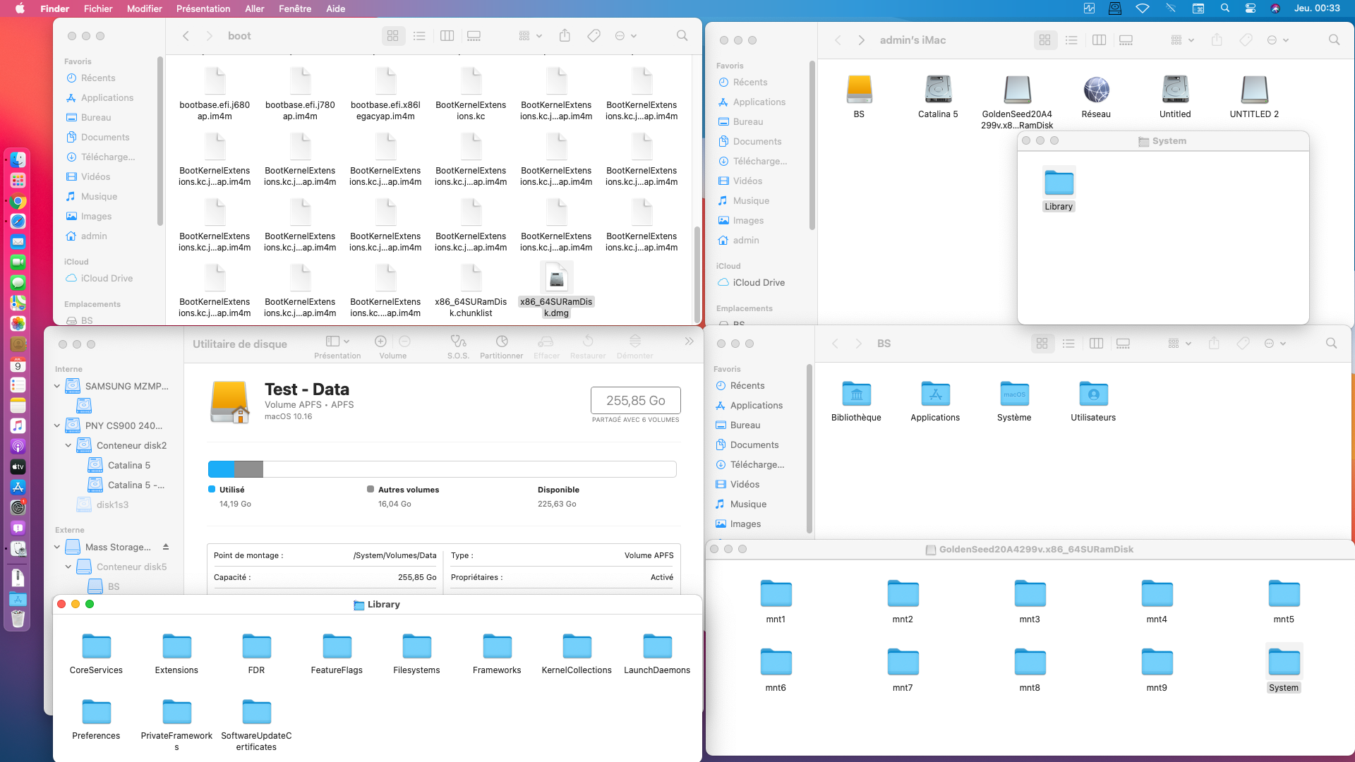

lottenow Posted July 8, 2020 Share Posted July 8, 2020 Here is my EFI with screenshots attached. Did I get my ACPI wrong? I cannot understand whether the problem is related to Big Sur or Open Core or my configuration. Thanks! EFI Big Sur Beta 2.zip BC6FD638-F481-49B0-A729-9297CA06A008.heic CB153E89-D5CE-4398-BEEB-97675A9D2FC7.heic Link to comment https://www.insanelymac.com/forum/topic/344428-pre-release-macos-big-sur/page/15/#findComment-2729379 Share on other sites More sharing options...

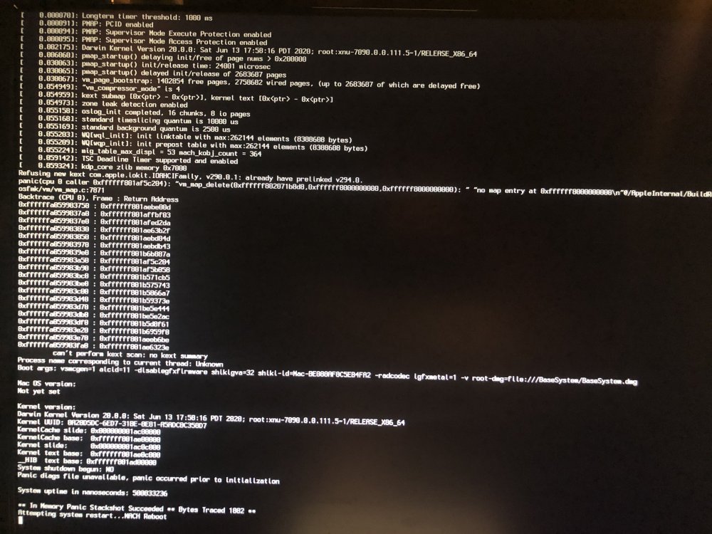

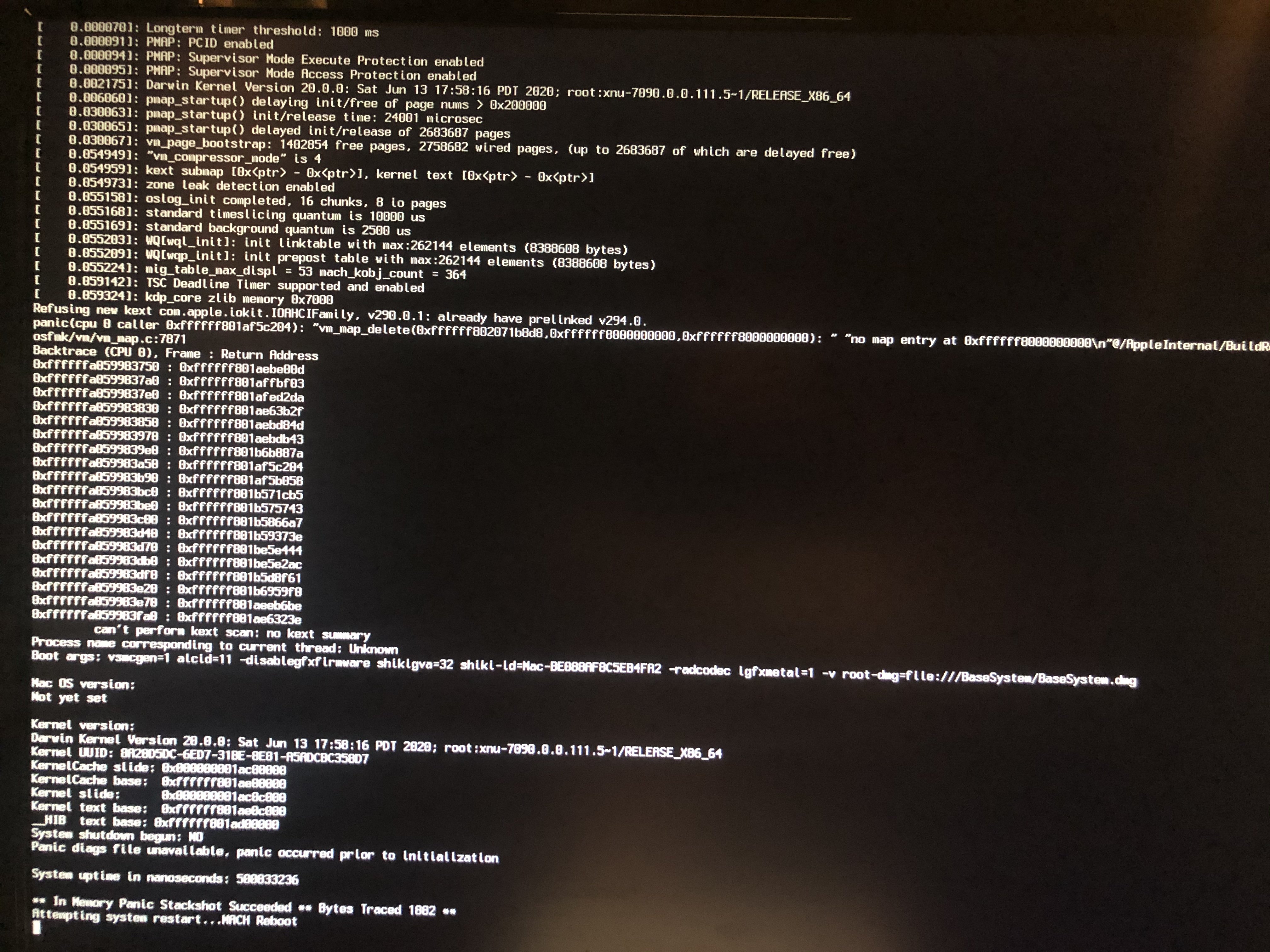

mnfesq Posted July 8, 2020 Share Posted July 8, 2020 16 minutes ago, lottenow said: I am still trying to wrap my head around why Big Sur cannot load internal disks. Has anyone found a solution yet? No luck here but I have made some advances in my understanding of the problem. The problem lies with the new AHCIFamily.kext and more particularly the IOAHCIBlockStorageDriver.kext. It simply cannot read the internal drive information. I tried using the AHCIPortInjector.kext but it did not solve the problem. The problem is NOT that it cannot read internal vs. external drives. The problem is that Big Sur cannot read SATA drives (i.e., drives physically connected to PRT.). You can see this if you use IORegExplorer. I am thinking that this problem is not related to our hardware but I can't say for sure. I have the Intel Series 10 chipset. I have a custom DSDT and, among other things, I changed all references from SAT0 to SATA. Without my custom DSDT, I cannot boot to Big Sur at all so I can't really test whether the problem is in some DSDT patch(es). I also tried changing the SMBIOS from my usual MBP14,3 to iMac19,2 but also without success. I was thinking that Apple might not allow internal drives that do not belong on that Mac model. I may still try some type of MacPro since it can have a variety of internal drives. I was asked by @SavageAUS if I could use a hot-plug SATA port but alas, my laptop does not have one to test that out. BTW, my BIOS has very few options but, by default, it is set to AHCI, not IDE or RAID. In fact, there is no option to change the SATA settings. That's where I am so far. I have not given up but I have spent way too many hours this month not working so that I could try to figure this out. 1 Link to comment https://www.insanelymac.com/forum/topic/344428-pre-release-macos-big-sur/page/15/#findComment-2729380 Share on other sites More sharing options...

lottenow Posted July 8, 2020 Share Posted July 8, 2020 13 hours ago, mnfesq said: No luck here but I have made some advances in my understanding of the problem. The problem lies with the new AHCIFamily.kext and more particularly the IOAHCIBlockStorageDriver.kext. It simply cannot read the internal drive information. I tried using the AHCIPortInjector.kext but it did not solve the problem. The problem is NOT that it cannot read internal vs. external drives. The problem is that Big Sur cannot read SATA drives (i.e., drives physically connected to PRT.). You can see this if you use IORegExplorer. I am thinking that this problem is not related to our hardware but I can't say for sure. I have the Intel Series 10 chipset. I have a custom DSDT and, among other things, I changed all references from SAT0 to SATA. Without my custom DSDT, I cannot boot to Big Sur at all so I can't really test whether the problem is in some DSDT patch(es). I also tried changing the SMBIOS from my usual MBP14,3 to iMac19,2 but also without success. I was thinking that Apple might not allow internal drives that do not belong on that Mac model. I may still try some type of MacPro since it can have a variety of internal drives. I was asked by @SavageAUS if I could use a hot-plug SATA port but alas, my laptop does not have one to test that out. BTW, my BIOS has very few options but, by default, it is set to AHCI, not IDE or RAID. In fact, there is no option to change the SATA settings. That's where I am so far. I have not given up but I have spent way too many hours this month not working so that I could try to figure this out. Thanks for the thorough explanation @mnfesq! Yes, I think the problem lies with the system and the way our ACPIs are configured. Would you mind sharing your EFI folder? What SSDs models are you using? The fact that the SSD does not match the model of the actual SMBIOS is unrelated IMO, as MacBooks and MacMini have different models than what Hackintosh users use anyhow, and they still manage to boot. I tried enabling ThirdPartyDrives as well as TRIM, but that didn't make any difference. I am now trying to see whether I could potentially use the kext from the latest Catalina release, but I obviously get a KP as it is pre-linked in Big Sur. I have already copied this in Kexts, as well as enabling them under Kernel. Is there a way to block a kext from loading in OC or bypass this? Thanks in advance! Link to comment https://www.insanelymac.com/forum/topic/344428-pre-release-macos-big-sur/page/15/#findComment-2729386 Share on other sites More sharing options...
