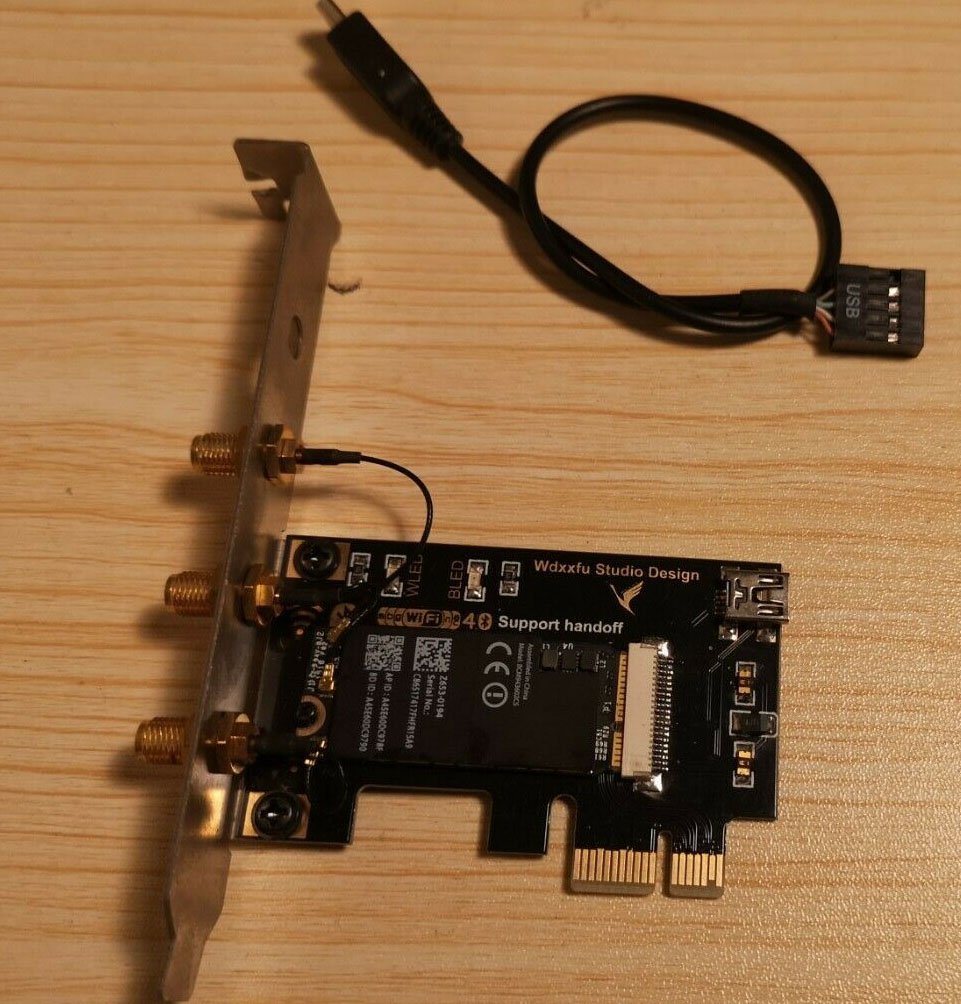

Thanks Guys,
thought I better put a bit gear in my sig so at least you know what I have.
@audiogod the card is this one so I can safely remove the fixup kext as I don't have a watch.
9 minutes ago, scotty pro said:
Thanks Guys,

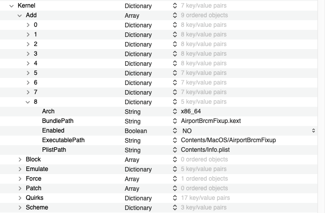

Disable the kext in the config.plist and see how it goes without it. (Don’t just delete the kext as that will break boot up if you do, make sure you disable of remove it from the plist before you do)
you might very well need to use BrcmPatchRAM with that card buddy. See how you get on.
Spoiler
Like So
Edited by AudioGod
Thanks Audiogod will leave plist and kexts alone until I have tried it out. Now just have to find a serial number that Apple will not reject.
