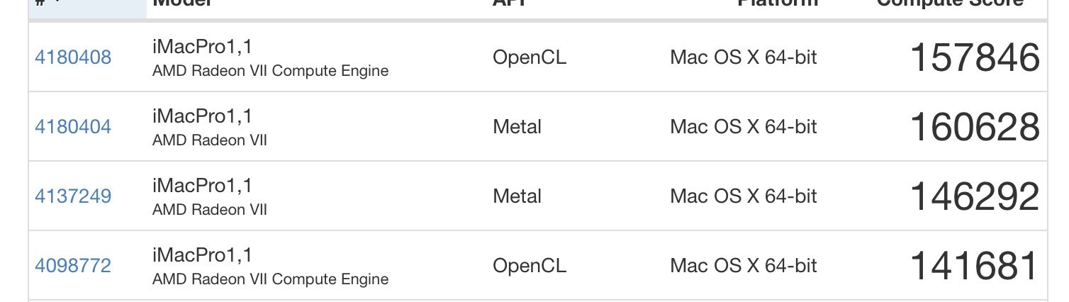

corint1 Posted June 4, 2019 Share Posted June 4, 2019 (edited) catalina ( 10.15) ---- metal some improvements ---opencl same like 14.6 beta .... Edited June 4, 2019 by corint1 Link to comment Share on other sites More sharing options...
corint1 Posted June 4, 2019 Share Posted June 4, 2019 (edited) 1 hour ago, meaganmargaret said: As for the Radeon VII, with those boot patches, things seem almost identical to the 10.14.6 beta. Similar performance, same problem (scratchy audio), at least for me. some improvements on metal test ... over 180 k in geekbench Edited June 4, 2019 by corint1 Link to comment Share on other sites More sharing options...

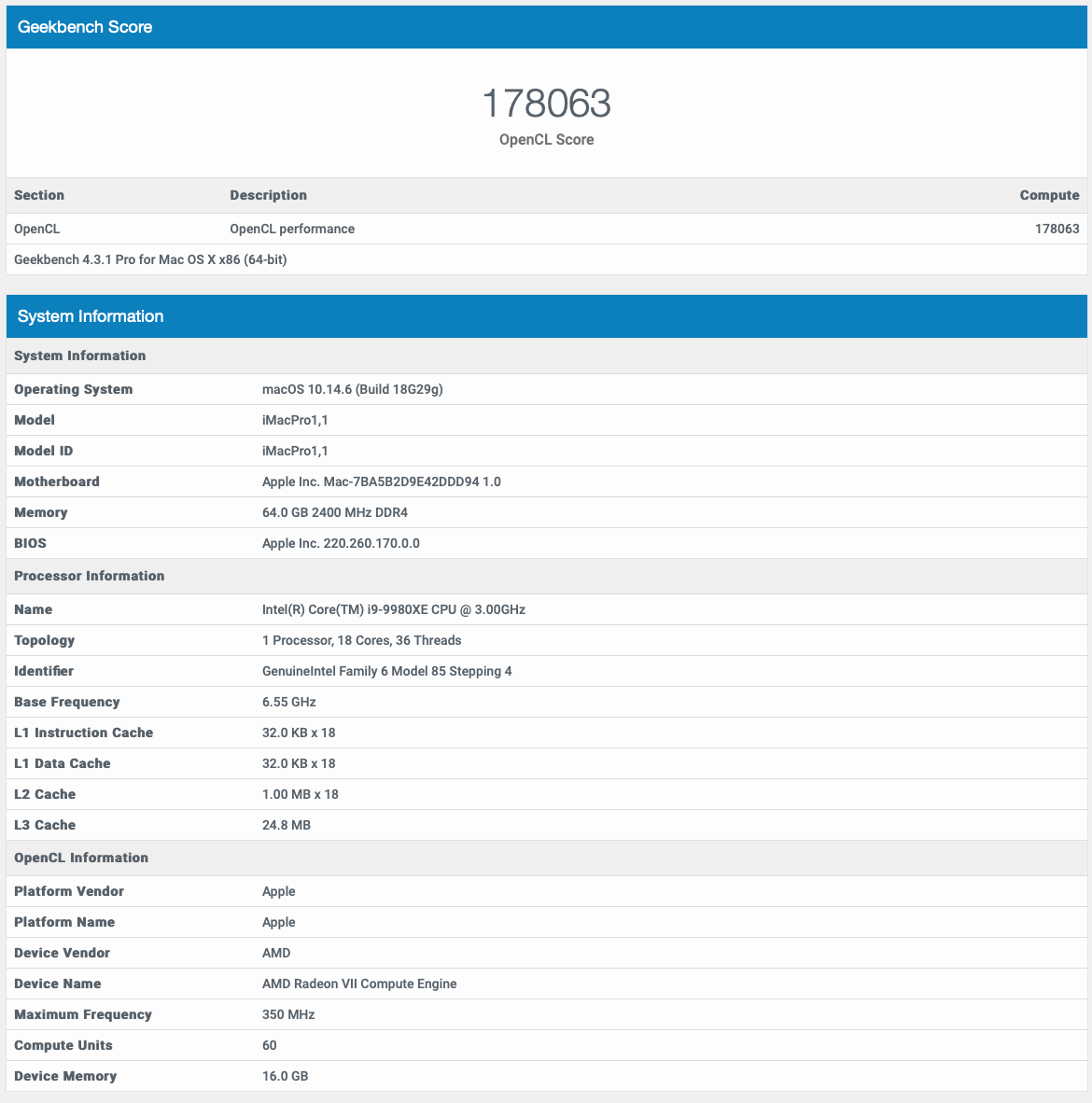

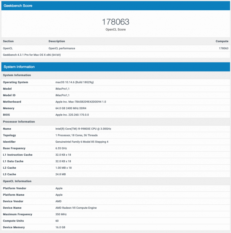

izo1 Posted June 7, 2019 Share Posted June 7, 2019 On 6/4/2019 at 2:20 PM, corint1 said: some improvements on metal test ... over 180 k in geekbench Lately I've been getting this with 10.14.6 Beta 1 (hopefully next beta is around the corner). I touched 180k once but didn't take a screenshot. I am just curious as to why the "maximum frequency" says 350Mhz, even in LuxMark it shows the same thing. This didn't happen with Vega FE I had before. Is it the macOS AMD driver reporting it this way or what? Link to comment Share on other sites More sharing options...
