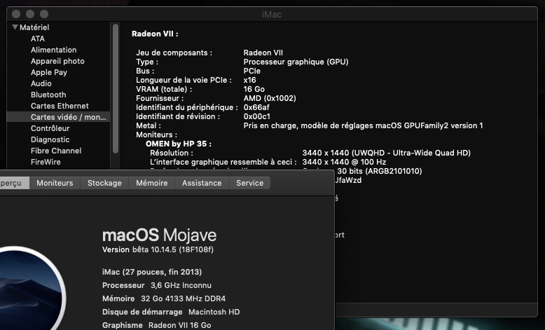

Allubz Posted April 3, 2019 Share Posted April 3, 2019 Great dev work on the VII! Can this card do 10-bit output in macOS? I know the VEGA64 could if you forced it with ResXtreme, but is this still the case, or does the VII natively support 10-bit screens and software? I found this in relation, but it's for Windows: Link to comment Share on other sites More sharing options...

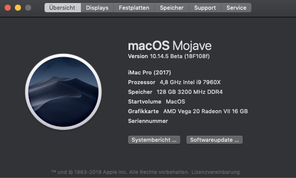

123456789323 Posted April 8, 2019 Share Posted April 8, 2019 What should I say... VII works perfect 1 Link to comment Share on other sites More sharing options...

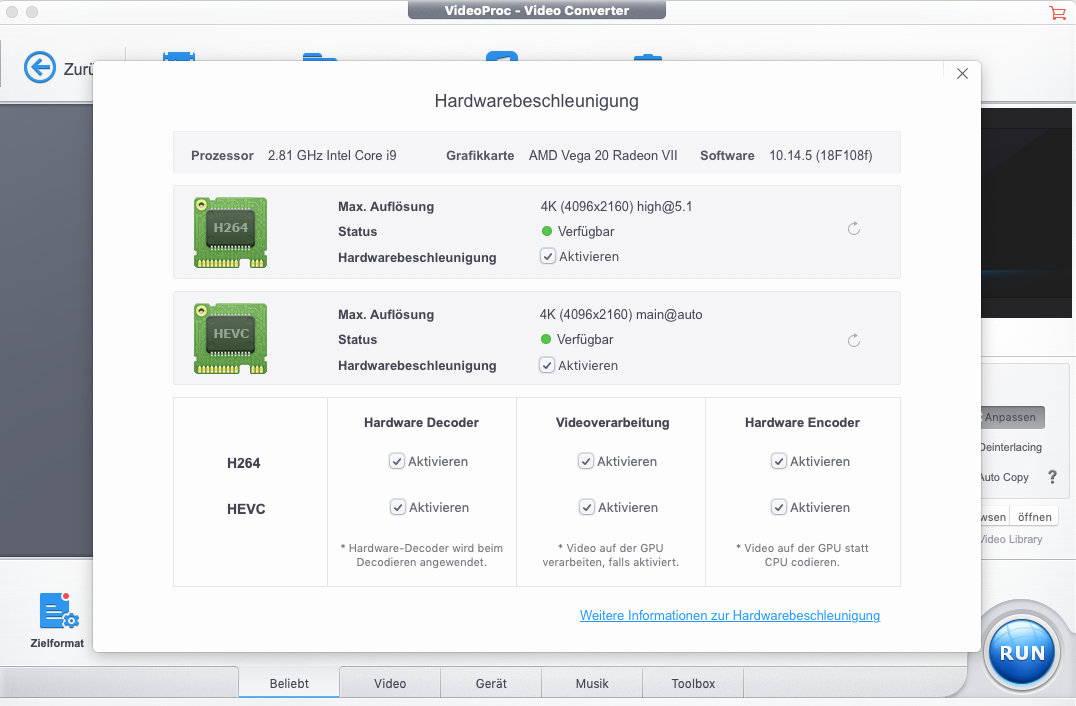

123456789323 Posted April 9, 2019 Share Posted April 9, 2019 Sorry but I don't share any personal EFI-Folders, it would not help you in any kind. N/A because VideoProC search for "AMD" in the name, if not available it will show N/A but it doesn't change anything. The important part is the status if green everything is good Link to comment Share on other sites More sharing options...

bundog Posted April 9, 2019 Share Posted April 9, 2019 20 hours ago, DSM2 said: What should I say... VII works perfect So it gains H.264 hardware decoding in 10.14.15 beta2 ? what mainboard you test VII on ? I tested in 10.14.15beta1, vii has no H264 hardware accelation on X299 mainboard. Late I migh upgrade to 10.14.5 beta2 to see any difference. Why your VII shows up AMD VEAG 20 RADEON VII ? Link to comment Share on other sites More sharing options...

corint1 Posted April 9, 2019 Share Posted April 9, 2019 11 minutes ago, bundog said: Thanks for your quick reply! But still, Is the Vii native supported in 10.14.15 beta2 or you have just modified any driver? as for the text name "AMD VEAG 20 RADEON VII" .... but how did you achieved it? in beta 2 is native ... full acceleration, both h.264 + hvec ... the text name "AMD VEGA 20 RADEON VII" isnt my ... I want this text ... but someone is silent ... Link to comment Share on other sites More sharing options...

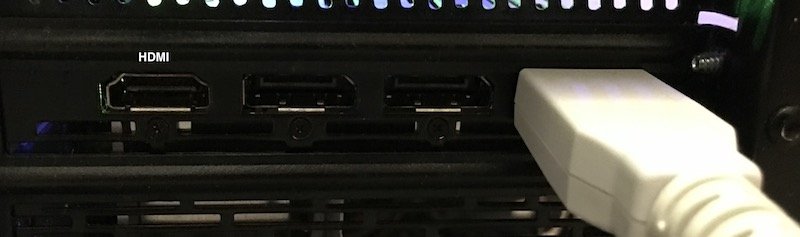

Wozniak Posted April 12, 2019 Share Posted April 12, 2019 2 minutes ago, corint1 said: post your efi folder and your configuration...we dont know about what talking ... in beta 2 radeon 7 work oob ( out of box )...no need any edit or modification ... try DP the farthest away from hdmi ... this port is implicit ... Mmm... I think I did all my tests on the dp port at the right of the hdmi port.. (the first) I will try again on other ports, and I come back. (My config: z390 mb Asus , intel i9 9900k, Igpu intel 630.) Link to comment Share on other sites More sharing options...
corint1 Posted April 12, 2019 Share Posted April 12, 2019 Just now, Wozniak said: Mmm... I think I did all my tests on the dp port at the right of the hdmi port.. (the first) I will try again on other ports, and I come back. (My config: z390 mb Asus , intel i9 9900k, Igpu intel 630.) in this configuration you should not have problems ... post your efi folder there may be more reasons why you get a black screen ... and guessing is hard to find a solution Link to comment Share on other sites More sharing options...
Wozniak Posted April 12, 2019 Share Posted April 12, 2019 39 minutes ago, corint1 said: in this configuration you should not have problems ... post your efi folder there may be more reasons why you get a black screen ... and guessing is hard to find a solution I just found the problem ! Clover was configured with ATI inject. I turn it off. If it can helps someone! Thanks a lot anyway, I finally finished my Mackintosh !! 1 Link to comment Share on other sites More sharing options...
