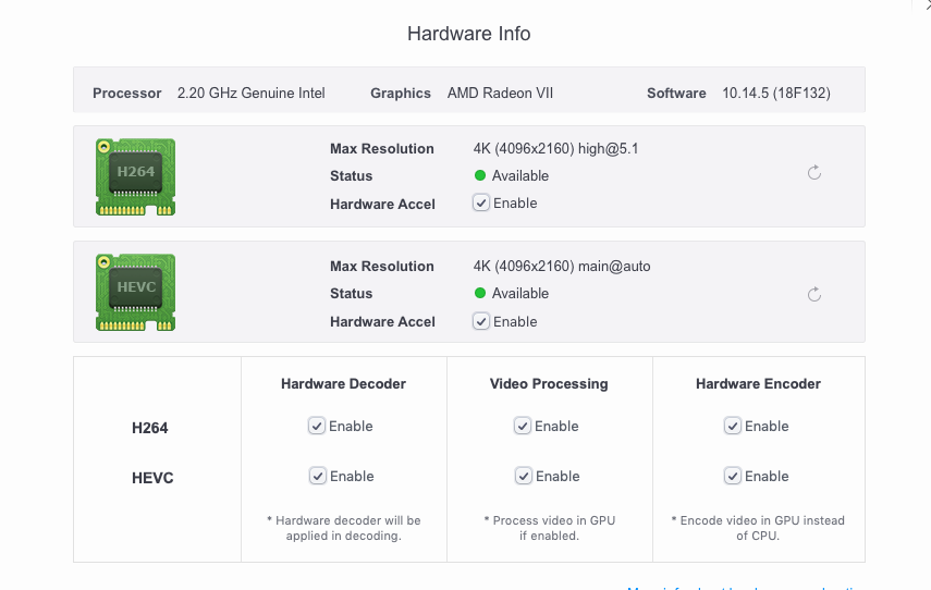

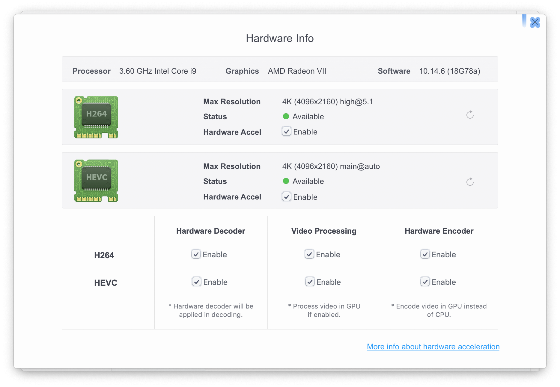

sl0wtarget Posted July 11, 2019 Share Posted July 11, 2019 (edited) On 5/20/2019 at 1:41 AM, Picasso said: I tried your recommendation and everything works fine. FCPX and DaVinci works perfect. The only thing I see is a software VideoProc H264 ¨unavailable¨. A lilu/weg setting to fix this? thx This is exactly what I'm getting now, @Picasso did you resolve this? Before changing to the suggested iMacPro1,1 it was showing as neither available. Thank you @CMMChris UPDATE: HUGE thank you to @CMMChris for patching up my EFI folder for me. For some reason Clover 4988 caused my Hack to freeze at RANDOMSEED after I tried installing it myself, forcing me to revert to 4972, but he got that working as well. Edited July 14, 2019 by sl0wtarget Update 1 Link to comment Share on other sites More sharing options...

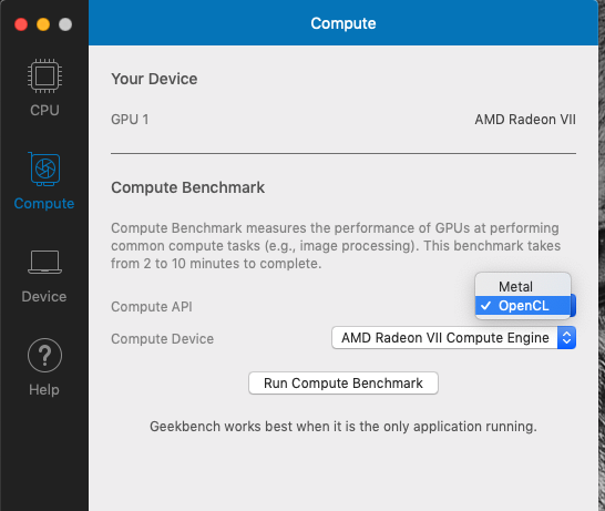

tChibo Posted July 18, 2019 Share Posted July 18, 2019 (edited) https://browser.geekbench.com/v4/compute/4308382 OpenCL Score:173751 Edited July 18, 2019 by tChibo Link to comment Share on other sites More sharing options...

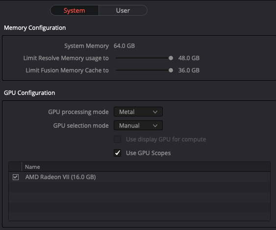

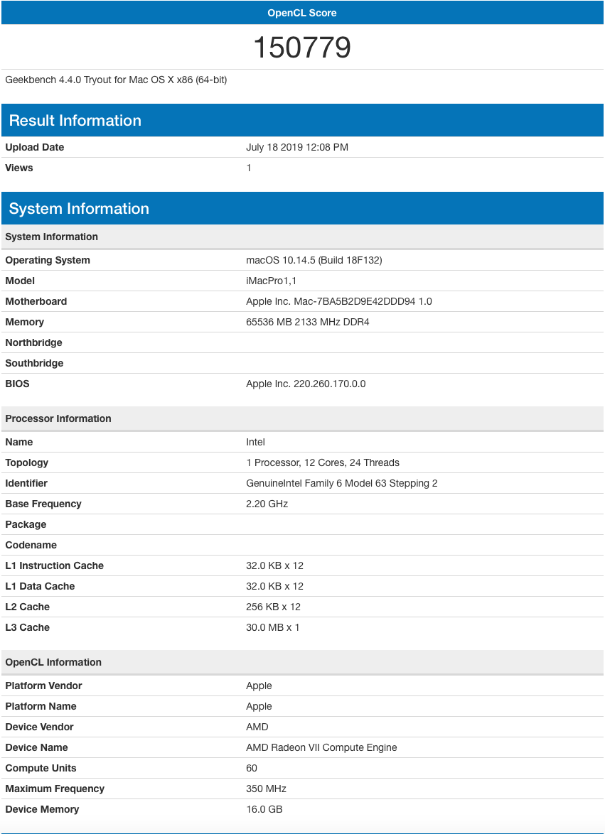

ergot Posted July 18, 2019 Share Posted July 18, 2019 1 hour ago, tChibo said: https://browser.geekbench.com/v4/compute/4308382 OpenCL Score:173751 I can see your SMBIOS is 18,1 did you tried iMacPro 1,1? As you can see the R7 is working fine on my hack, results from bench mark are OK can do better I believe however, when running FCPX or DR the encoding/export results are very slow...is that related to Apple drivers or I need to modify my EFI? Thanks Link to comment Share on other sites More sharing options...
ergot Posted July 18, 2019 Share Posted July 18, 2019 3 hours ago, tChibo said: https://browser.geekbench.com/v4/compute/4308382 OpenCL Score:173751 Did you noticed performance change from 10.14.5? could you please share the 10.14.6 AMD new drivers? Link to comment Share on other sites More sharing options...
Picasso Posted July 18, 2019 Share Posted July 18, 2019 1 hour ago, ergot said: Did you noticed performance change from 10.14.5? could you please share the 10.14.6 AMD new drivers? Rename your ACPI devices properly. All the info in this topic. Link to comment Share on other sites More sharing options...
ergot Posted July 18, 2019 Share Posted July 18, 2019 (edited) 2 hours ago, Picasso said: Rename your ACPI devices properly. All the info in this topic. I couldn't find...can you please point me to the topic? By the way, Metal in DR working faster than OpenCL....so I guess it is matter of Apple drivers that are not matured yet Edited July 18, 2019 by ergot Link to comment Share on other sites More sharing options...

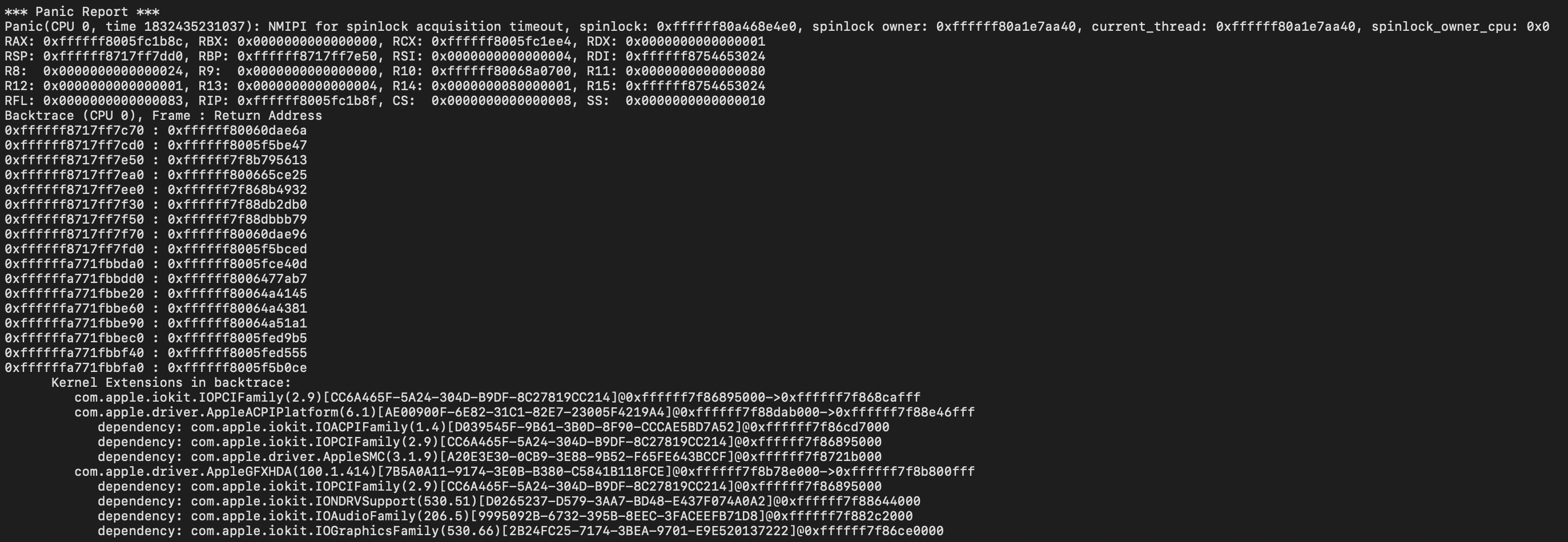

ianxpluto Posted July 20, 2019 Share Posted July 20, 2019 Anyone has panic issue with Radeon Vii on Mojave 10.14.5? I built a Mac with 9900K+Gigabyte Z370 Gaming 7+Msi Radeon Vii. However, I have no idea where I did wrong, the OS will reboot by panic (like my picture shows). Link to comment Share on other sites More sharing options...
corint1 Posted July 20, 2019 Share Posted July 20, 2019 3 minutes ago, ianxpluto said: Anyone has panic issue with Radeon Vii on Mojave 10.14.5? I built a Mac with 9900K+Gigabyte Z370 Gaming 7+Msi Radeon Vii. However, I have no idea where I did wrong, the OS will reboot by panic (like my picture shows). not R7 ... 970 Pro is guilty... Link to comment Share on other sites More sharing options...
ianxpluto Posted July 20, 2019 Share Posted July 20, 2019 1 hour ago, corint1 said: not R7 ... 970 Pro is guilty... Great to hear that. I should keep looking for solution. Link to comment Share on other sites More sharing options...
tChibo Posted July 21, 2019 Share Posted July 21, 2019 On 7/20/2019 at 12:00 PM, corint1 said: not R7 ... 970 Pro is guilty... WHAT???? On 7/20/2019 at 11:55 AM, ianxpluto said: Anyone has panic issue with Radeon Vii on Mojave 10.14.5? I built a Mac with 9900K+Gigabyte Z370 Gaming 7+Msi Radeon Vii. However, I have no idea where I did wrong, the OS will reboot by panic (like my picture shows). downgrade bios to F10 Link to comment Share on other sites More sharing options...
ianxpluto Posted July 21, 2019 Share Posted July 21, 2019 1 hour ago, tChibo said: WHAT???? downgrade bios to F10 Are you using same MB as well? I will try, thank you man. Link to comment Share on other sites More sharing options...
