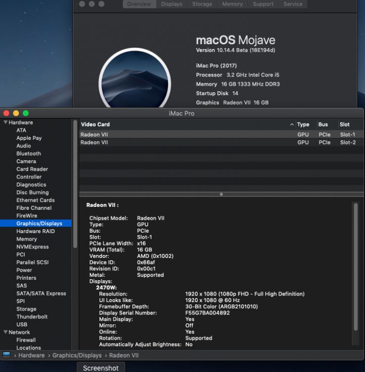

Gigamaxx Posted February 20, 2019 Author Share Posted February 20, 2019 Try enabling IGPU in bios Link to comment https://www.insanelymac.com/forum/topic/337637-amd-radeon-vii-in-macos-mojave-10144-beta/page/2/#findComment-2664772 Share on other sites More sharing options...

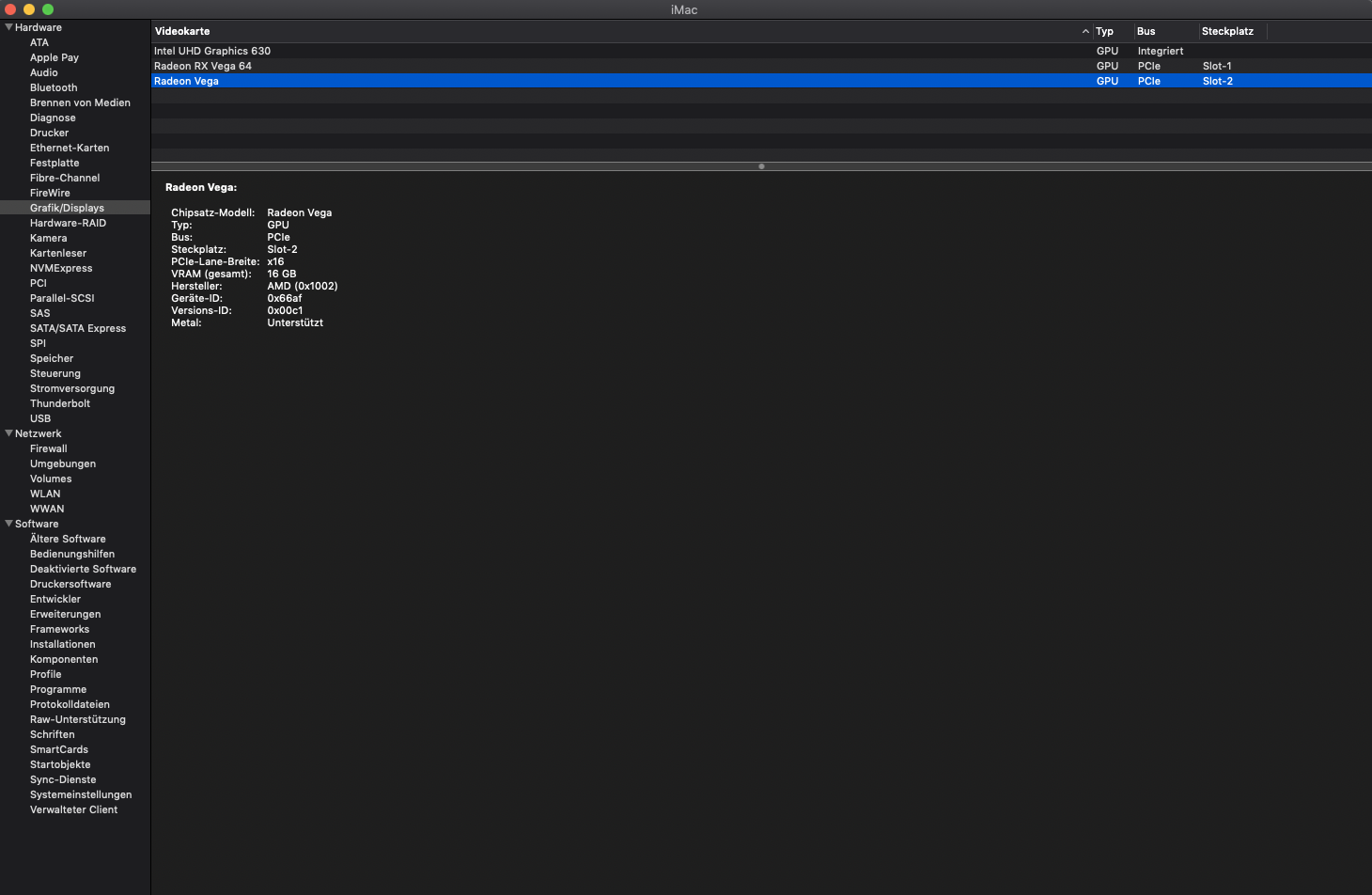

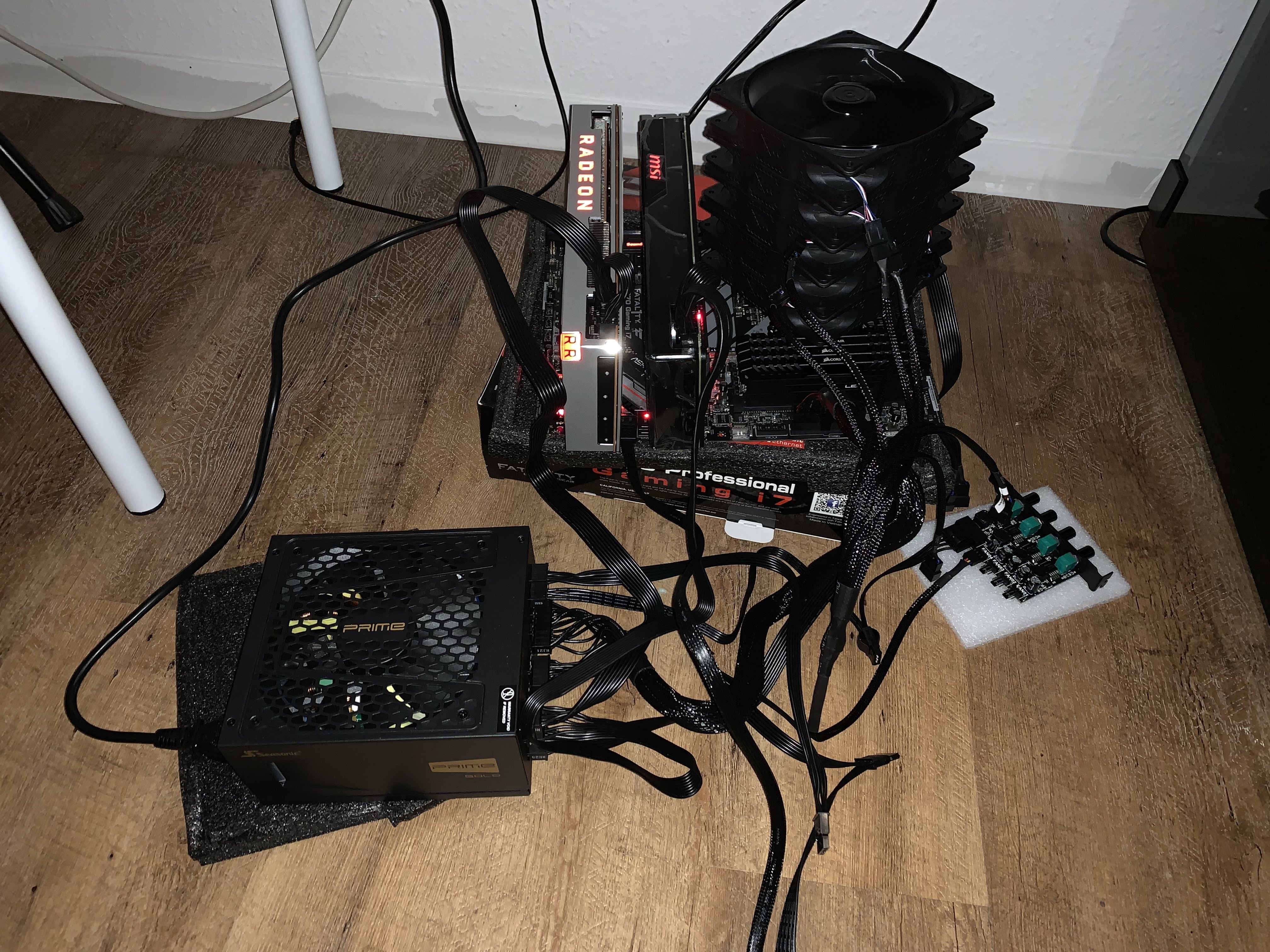

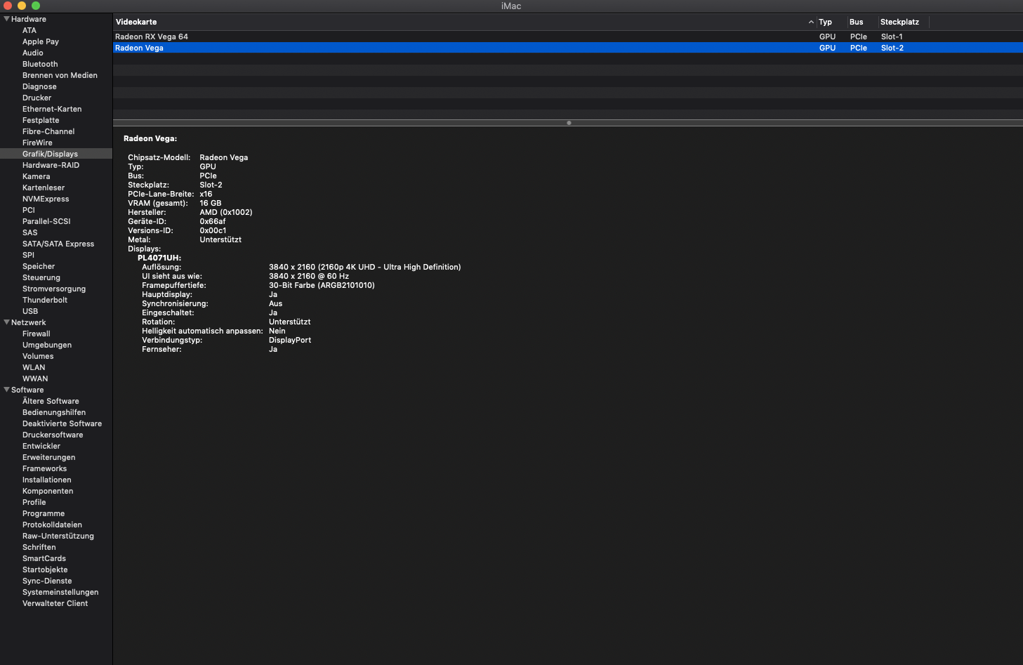

123456789323 Posted February 21, 2019 Share Posted February 21, 2019 Time to make things clear... As already mentioned by me in the German community @trueadm posted in the thread of @KGP-iMacPro that the VII only runs when the IGPU is on in the bios. The whole thing didn't leave me any peace today and I wanted to know it exactly, so I set up a small test setup. Since I was missing a CPU cooler, I had to improvise a little, as you can easily see. Don't worry all parts live and CPU was kept constant at 53/54 degrees What turned out now ? Yes, the card has acceleration when you edit the kext but ONLY!! : if... a) the IGPU is active or b) basically there is a helper card in it If both are not available then the behavior already determined by @KGP-iMacPro or myself mentioned from day one. 3 Link to comment https://www.insanelymac.com/forum/topic/337637-amd-radeon-vii-in-macos-mojave-10144-beta/page/2/#findComment-2664824 Share on other sites More sharing options...

Gigamaxx Posted February 21, 2019 Author Share Posted February 21, 2019 4 minutes ago, DSM2 said: You should read again I didnt state that the card works only If you have an IGPU. If you edit the 5000.kext you need an helper Card. Otherwise it will Not Work until Apple release the final Driver You are correct, they changed the kexts in 10.14.3. In just removed my rx 460 out and it boots to black screen in 14.3 with VII only. I put my 10.14.2 disk in and it works. I had my 460 in there to save power and just pulled the power to the VII and connected only to test after the update. But it had the RX 460 as helper card. Maybe we need a WEG kext update to include this card ID. Try these kexts (10.14.2) maybe the 5000kext first. 10.14.2 kexts.zip Link to comment https://www.insanelymac.com/forum/topic/337637-amd-radeon-vii-in-macos-mojave-10144-beta/page/2/#findComment-2664828 Share on other sites More sharing options...

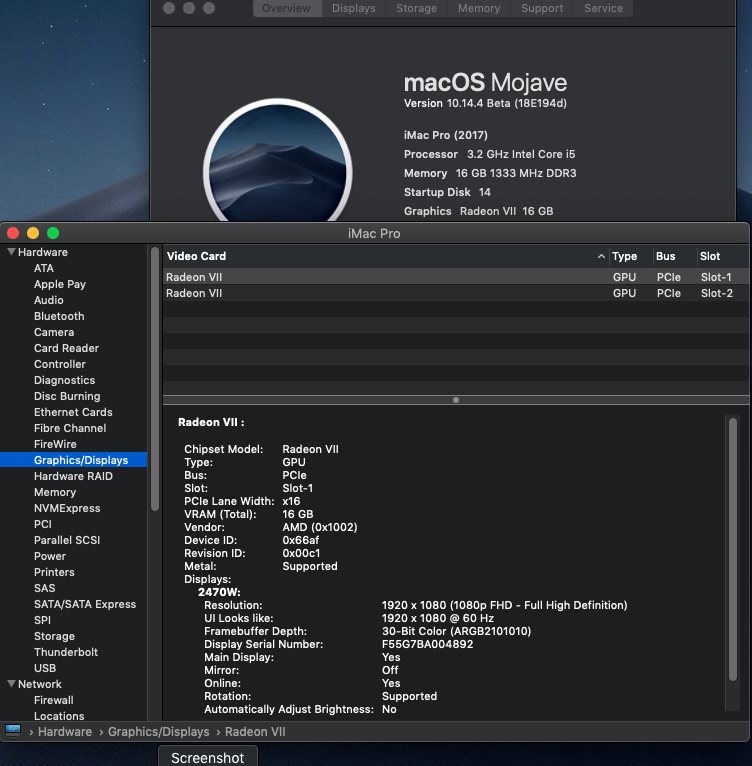

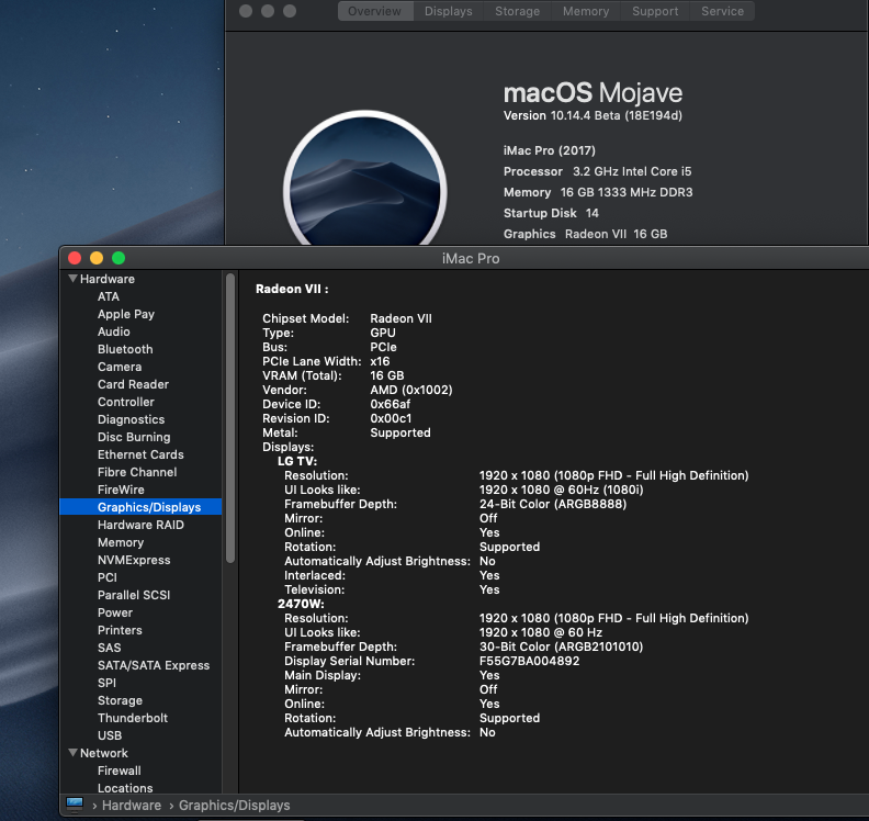

Gigamaxx Posted February 21, 2019 Author Share Posted February 21, 2019 (edited) 42 minutes ago, DSM2 said: The black screen is not related to weg or an SSDT or anything else... Trust me If I say that.... I did alot of testing... Interesting it works in 10.14.4 beta 3 with dual VIIs. Edited February 21, 2019 by Gigamaxx 1 Link to comment https://www.insanelymac.com/forum/topic/337637-amd-radeon-vii-in-macos-mojave-10144-beta/page/2/#findComment-2664832 Share on other sites More sharing options...

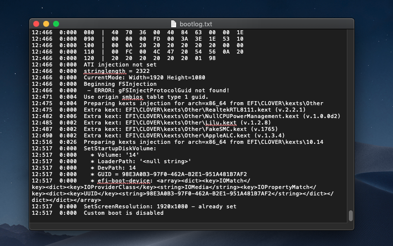

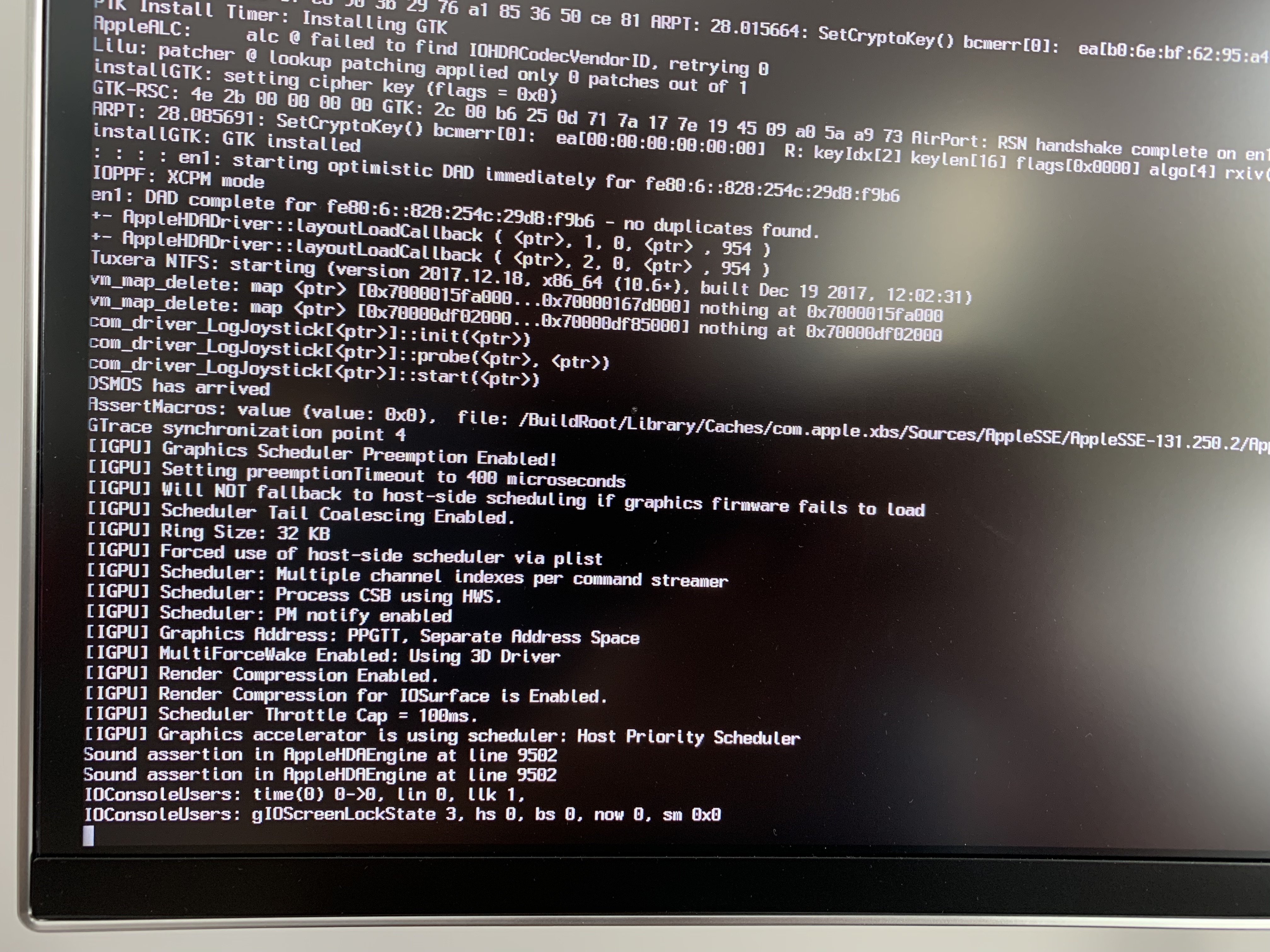

Gigamaxx Posted February 21, 2019 Author Share Posted February 21, 2019 5 hours ago, DSM2 said: Like I already explained to you in the German Community. Just because you set output to PEG the onboard Chip is not disabled at all!!! Yes my card runs UEFI BIOS but it doesnt matter since exactly same behaviour is happening in legacy mode. It works without WEG. 10.14.4 beta 3 Check the bootlog IOReg and screenshots. Its not just set to Peg the IGPU multi monitor is also disabled. I can enable and my IGPU will show up if configured but its not. Clover doesn't show any Intel in graphics screen as well. iMac Pro Vii 10.14.3 no WEG.zip bootlog.txt.zip Link to comment https://www.insanelymac.com/forum/topic/337637-amd-radeon-vii-in-macos-mojave-10144-beta/page/2/#findComment-2664927 Share on other sites More sharing options...

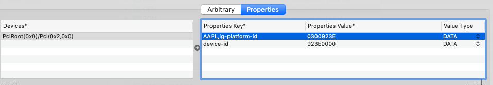

Benlehot Posted February 26, 2019 Share Posted February 26, 2019 (edited) Hi guys, I did a lot of changes in my config in the last few days. I was set with an iMac Pro smbios. I change to iMac 18,3 to get the iGPU support. With those patches (see screenshot), i'm able to boot in Mac OS with the iGPU enable in the bios and the patch in the AMDRadeonX5000 file. My iGPU is set in headless mode. Is that enough to get the patch working? However, the fix doesn't seems to work yet. I'm not getting any acceleration on my VII. If I check in Kext Wizard, I can see that AMDRadeonX5000 is not loaded. (see screenshot). Is it normal? Here's my config if it can help: Intel i9 9900k - AsRock Z390 Phantom Gaming-ITX/ac - 32gb LPX Corsair 2666Mhz - 2 x 1TB Samsung Evo 970 - AMD Radeon VII Thanks a lot for the help guys Edited February 26, 2019 by Benlehot Link to comment https://www.insanelymac.com/forum/topic/337637-amd-radeon-vii-in-macos-mojave-10144-beta/page/2/#findComment-2665423 Share on other sites More sharing options...
